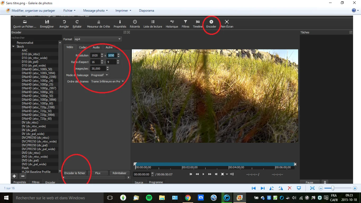

For FPVers, this is one of the reasons why people buy GoPros instead of a Yi for a fraction of the price. Although there is (unfortunately) no firmware for the Yi that can do this: https://gopro.com/support/articles/what-is-superview , it is possible to get something like it with the use of a clever editor. I use the FW in post #1 for my z23a and Shotcut to get this by 1) Recording in 1280x960p60 (35mbit), upscaling to 1920x1050 (yes - not 1080. Need that ~3% distortion to add the perception of high speed), rendering to 1080p60 at 35-40M bitrate,95% quality.
Superview (GoPro Hero3+, 4 Silver/Black and some others)
...upscaling and renderinging using wich software?
shotcut causes at loading plugins a crash on my windows 7 system.
What software can also upscale videos, rendering i can do wth my video software.
thankx
I also use Premiere Elements, but prefer Shotcut for the job. My Thinkpad is also running Win7.

sorry but can't notice the superview effect...maybe you can show side by side comparison of rendered in superview and the normal :-)
...looking for a free software testing upscaling from 1280 x960 to 1920x1050 because shotcut is crashing on my win7 32 bit system while loading plugins.
Any idea?
