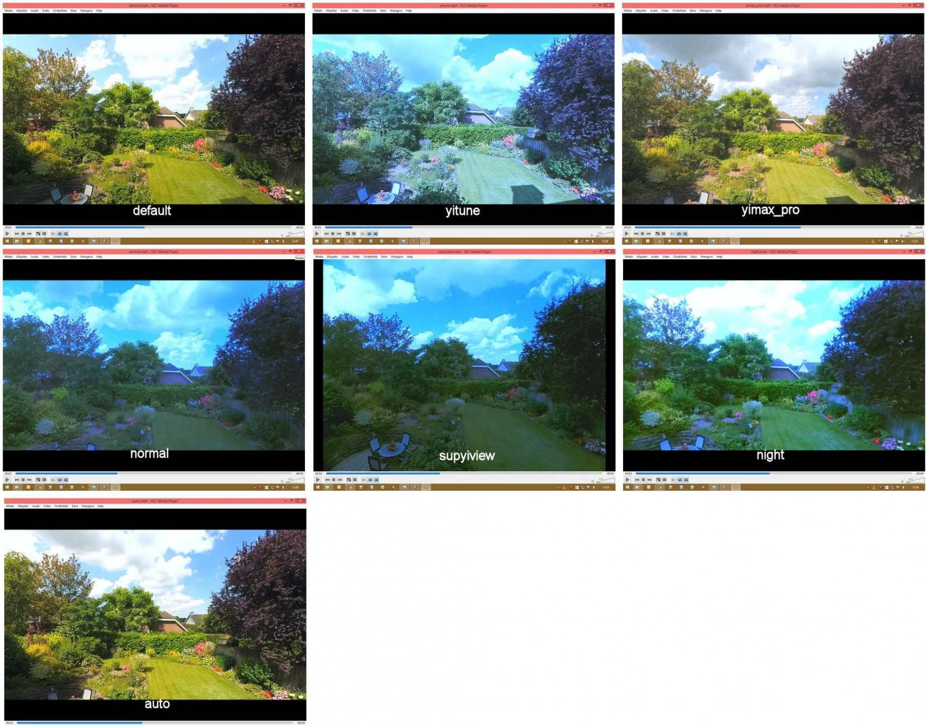

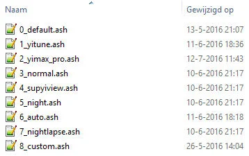

Changed the script order in the following order. (see pictures)
Setting up a mode:
Pressing shutter button and then power button 0 times results in mode "default".
1 times results in mode "yitune".
2 times results in mode "yimax_pro".
3 times results in mode "normal".
4 times results in mode "supyiview".
5 times results in mode "night".
6 times results in mode "auto".
View attachment 24496 View attachment 24497
