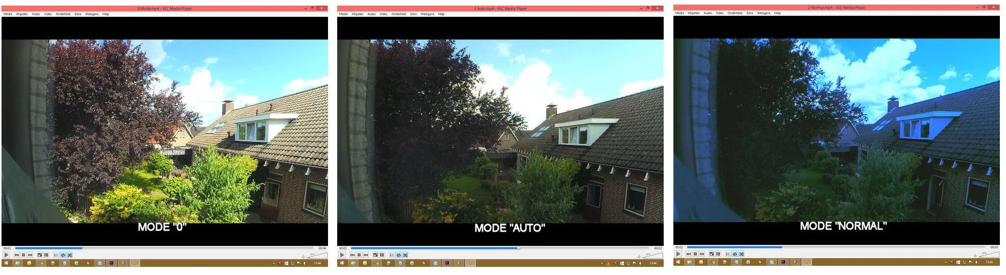

Got another issue since I installed your new 2.2.0
(Tried also re-installing the 22L firmware, wich did not help)
XIMODE "0" and XIMODE "AUTO" are looking good, but everything after that (NORMAL, NIGHT, YITUNE, SupYiView) is VERY blue :confused:
Using only CPL filter.
What am I doing wrong? :(

Changed the script order in the following order. (see pictures)
Setting up a mode:
Pressing shutter button and then power button 0 times results in mode "default".
1 times results in mode "yitune".
2 times results in mode "yimax_pro".
3 times results in mode "normal".
4 times results in mode "supyiview".
5 times results in mode "night".
6 times results in mode "auto".
Okay, looks like it doesnt depend on the order, but it's the scripts.
