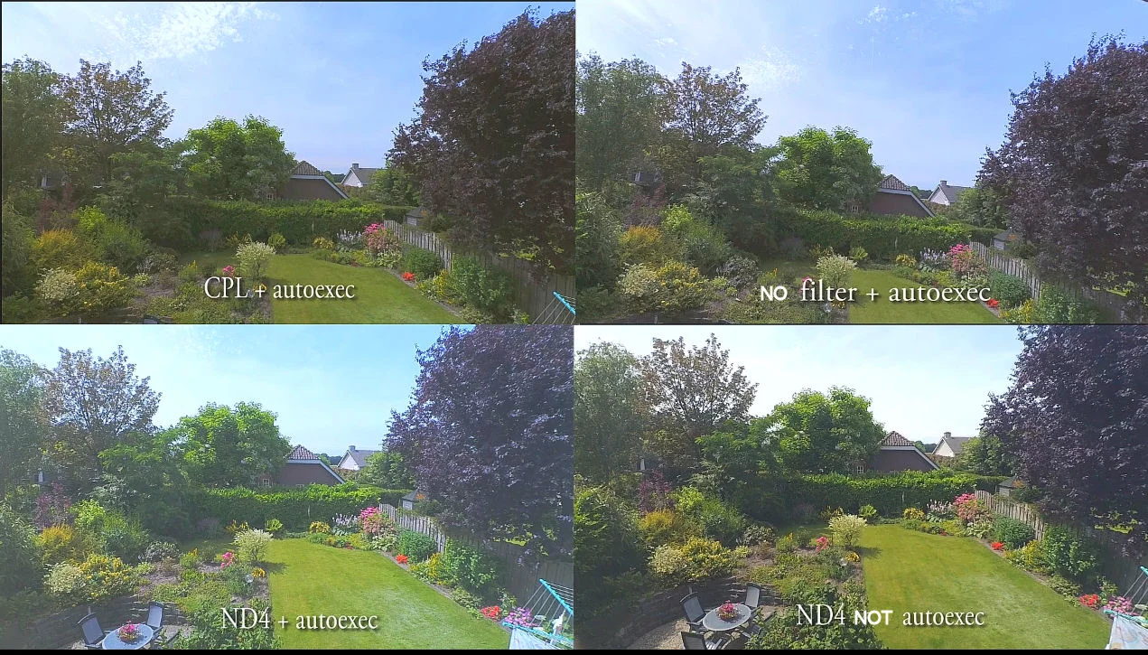

Has anyone this experience?
Using filters changes the color and brightness.
Especial on the ND4 filter! Much more bluish.
(made no changes in the autoexec)
