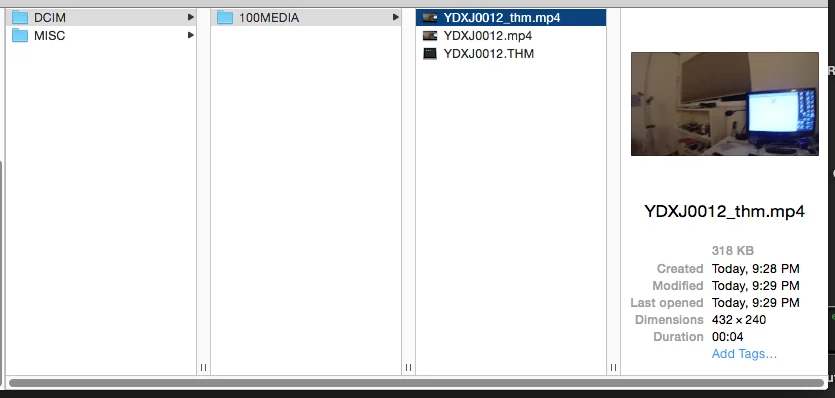

Hi Guys, since updating to the latest firmware v1.2.12 when recording in resolution 2304x1296 the camera does not create a review file so when I try to review on the phone it comes up with the message on my phone "The file does not support online play".
Are others having the same problem, the Yi is still producing review files for all the other resolutions just not 2K.

You said, "... the camera does not create a review file ..." but obviously, it does create one. You even said you tried to play it ...🙂
If you copy the .THM file (which is the review file you refer to) to your computer and change the filename extension from .THM to .mp4, it should play on your computer.
.thm is only a JPEG file
That's odd. Since updating to the current version of the firmware, my camera sporadically creates some files with two filename extensions, such as "video.thm.mp4", suggesting the file is MPEG, not JPEG. I don't know why.
I can copy a .THM file from the SD card to my computer hard drive, change the filename extension to .mp4 and then play it as a small video in Quicktime Player.
<Edit: In that case, I am not talking about the occasional files with the odd extensions (*.thm.mp4). I mean the regular *.THM files.
... Example...
_____________________
<Edit2>: OK, I see what's going on...
Changing the filename extension to .mp4 causes the file to open in the default video player, but the video is only 1 frame long... Now I get it 🙂
The *.thm.mpg file actually does play as a small video, however.
Thanks Squeamish and luckylz, yes *.THM files are just the start jpeg of the video, *.thm.mp4 is the review file which is not generated in 2K mode.
The 192.168.42.1 works but with a transfer rate of 1mbit/sec its very stop start. Its even stop start with 1,920×1,080 video. Thanks again.
