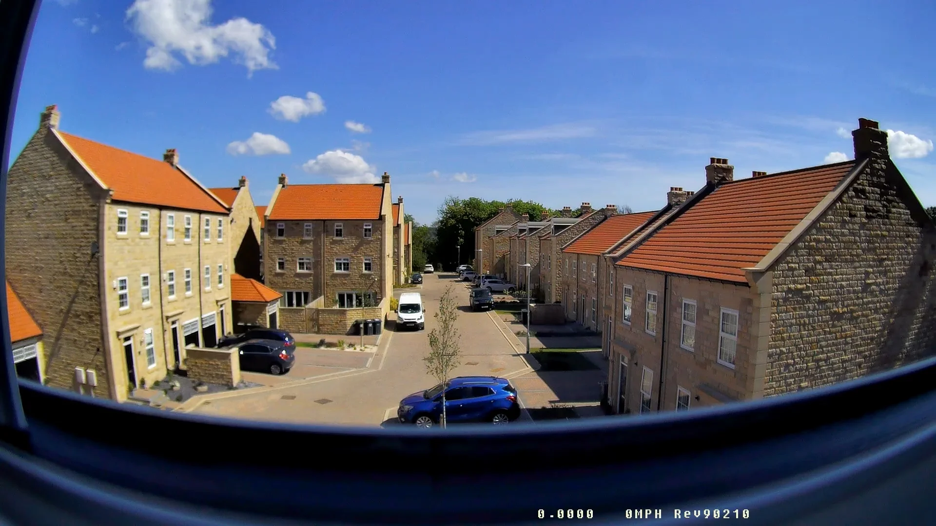

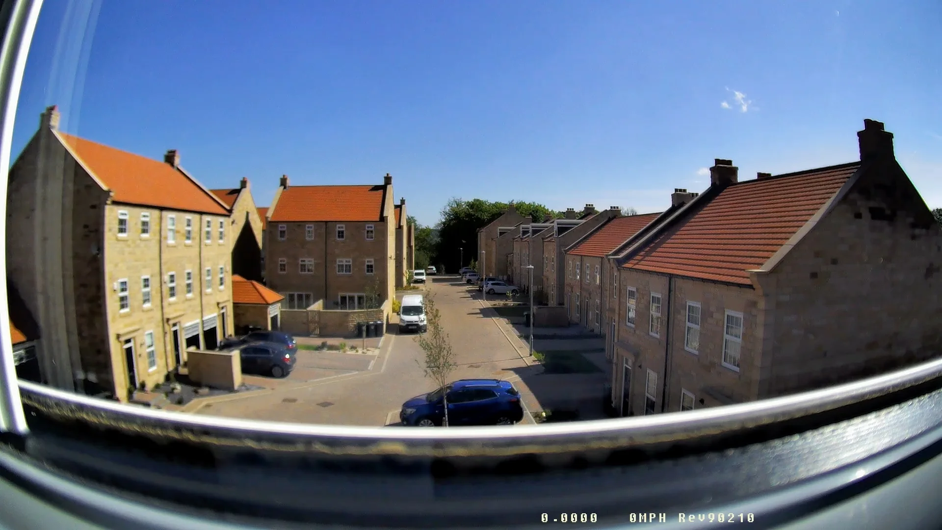

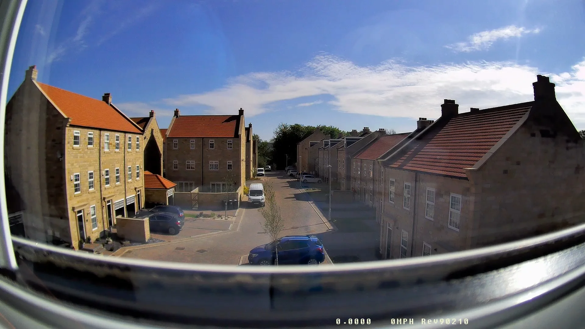

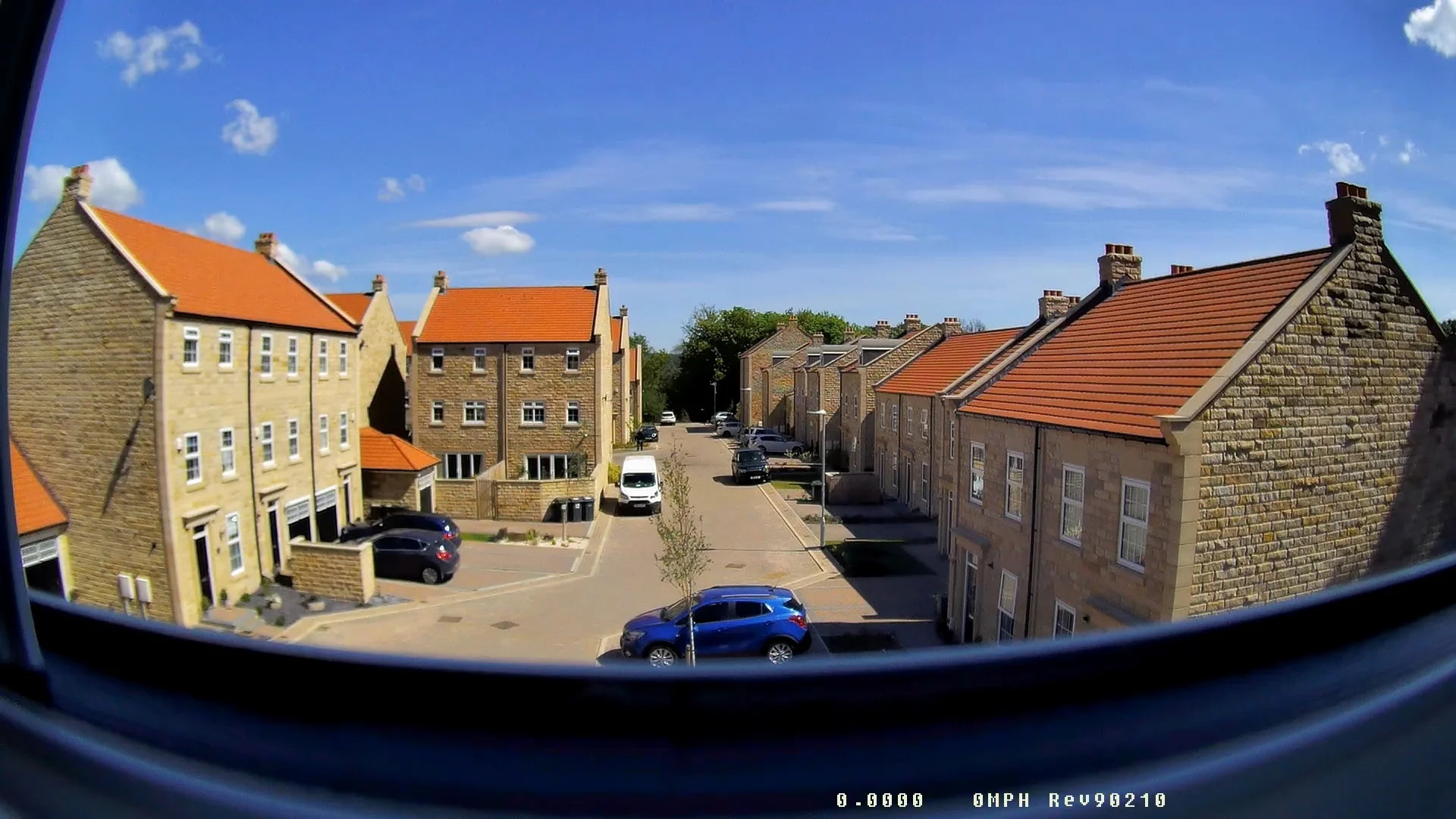

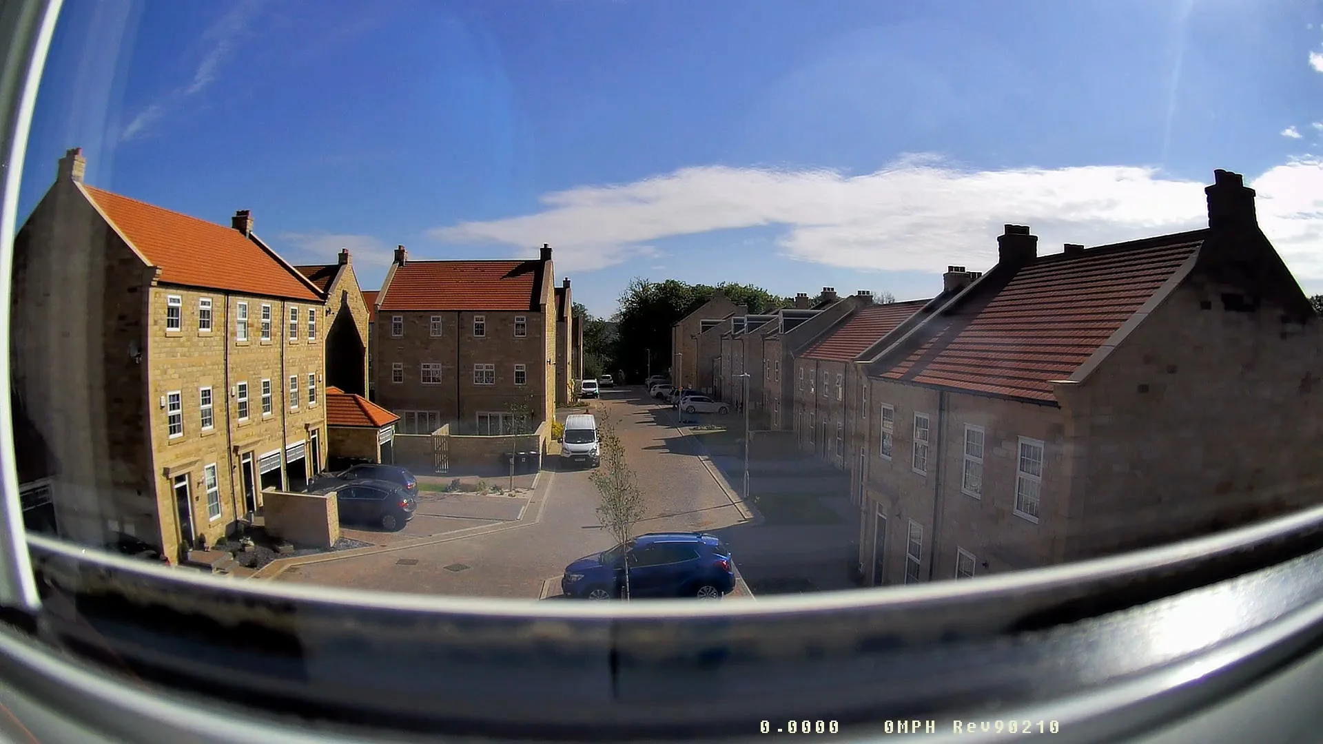

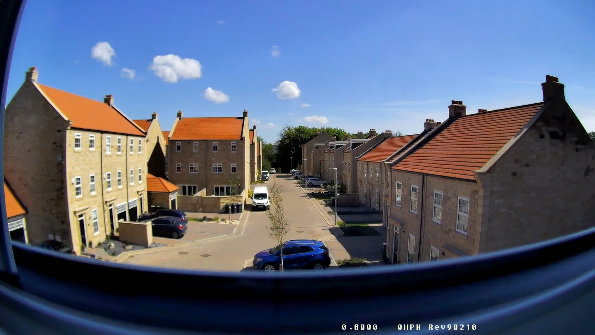

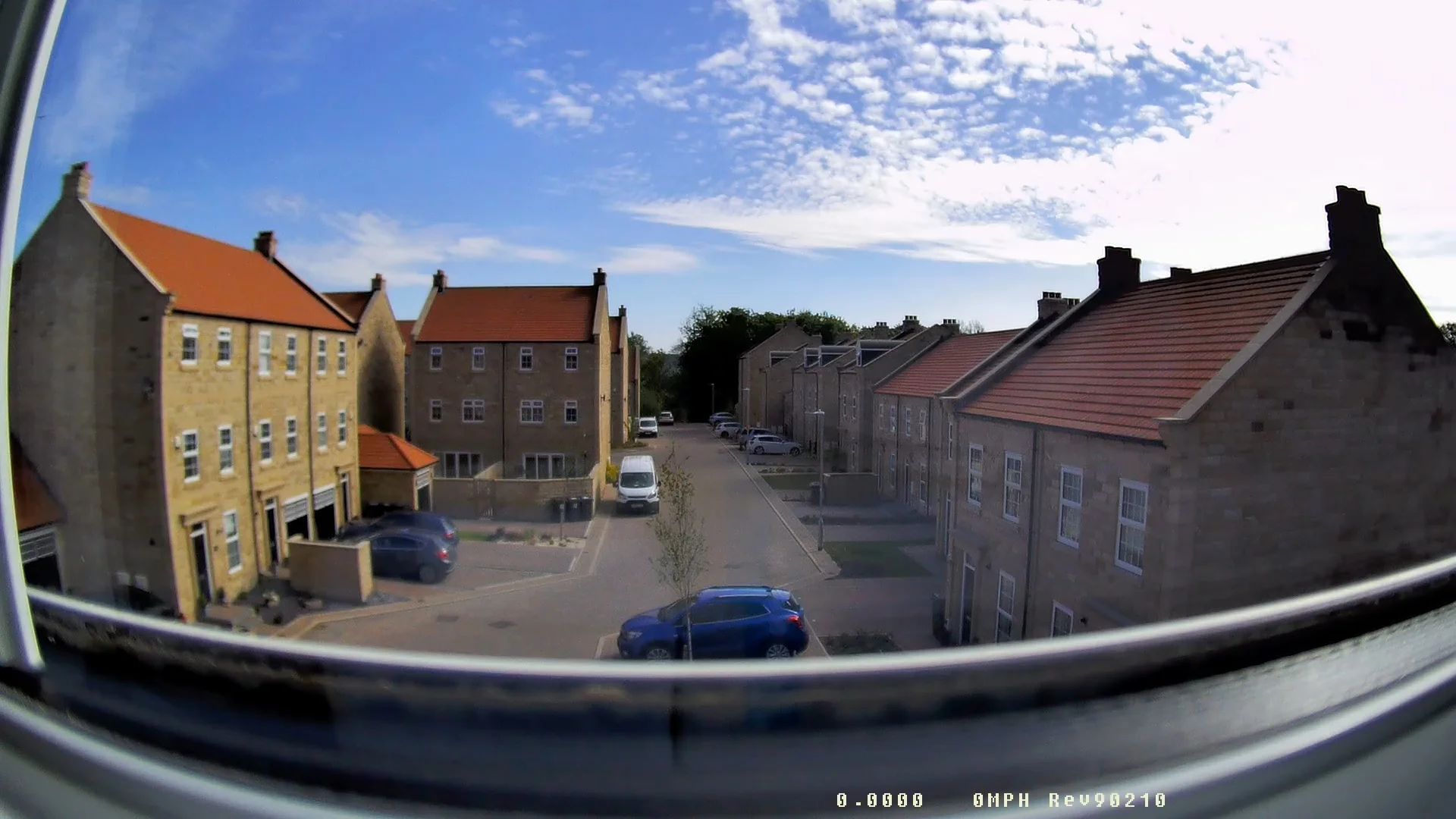

I just ran the camera for 2.5 hours looking out a window to see what happened with focus drifting.
It seems that on my particular unit the focus shift has hit it's maximum within 15 minutes of the camera running with a single channel (ie rear camera not connected).
Here are some pics in order from 09:56 when the test started through to 12:22 - I'm just doing a sped up video to show the drift easier as well.
I'm kicking myself for not having the timestamp on the video which would make it easier to gauge time!

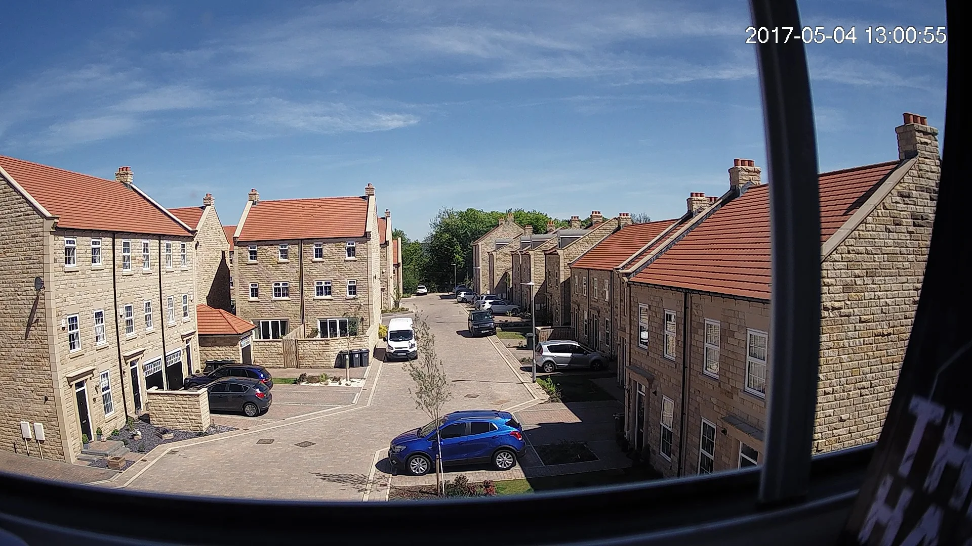

For reference, here's a snapshot from a Dahua IPC-HDW5231R-Z IMX291 based CCTV camera with varifocal lens (almost $200 worth) from sat next to the Mini:

For time reference that clip was at 60x speed so 23 seconds = 23 minutes.

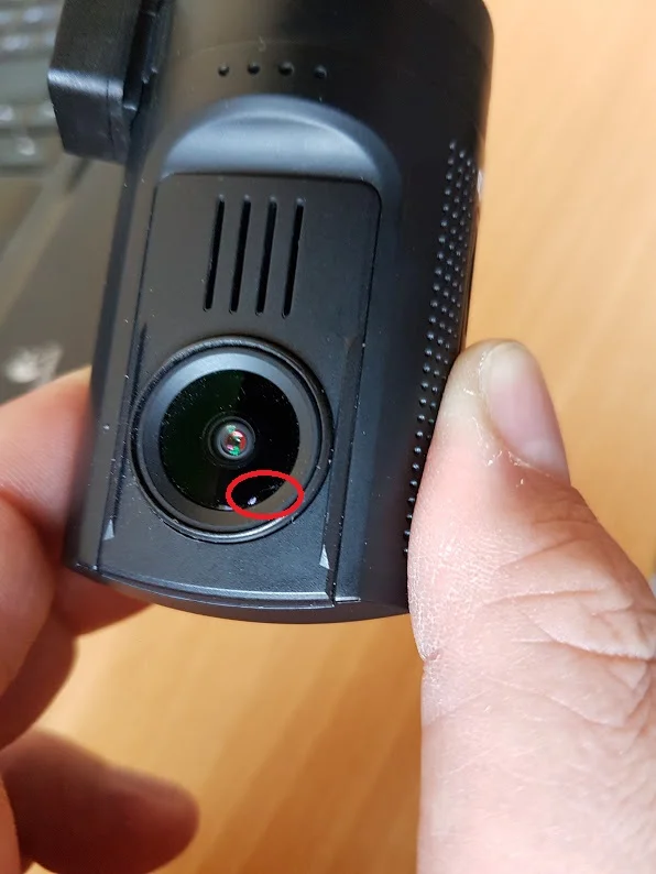

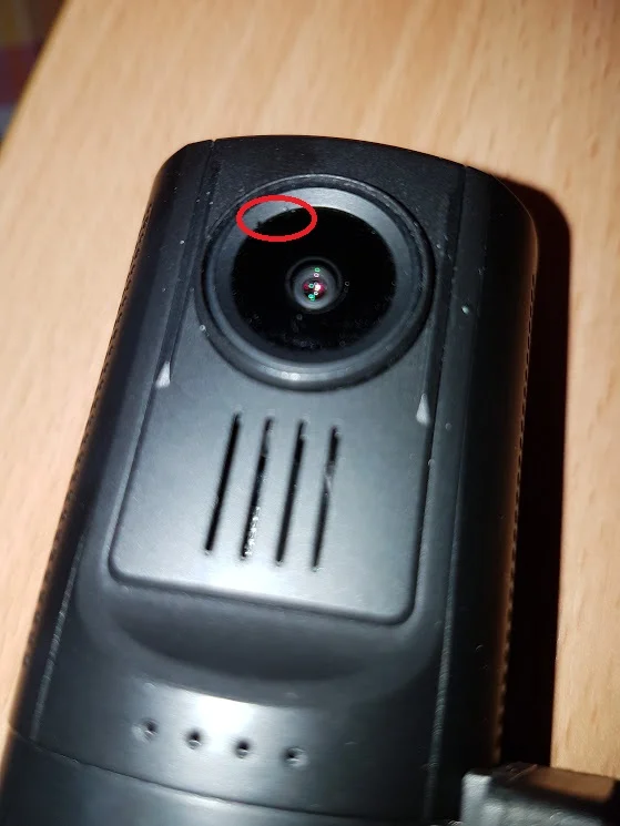

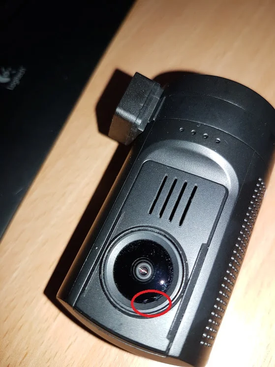

On closer inspection the lens appears to be cracked slightly on what would be the right side of the image and that may not help matters - it's tiny so a nightmare to capture an image.
If you look very, very closely there are also two marks in the outer side of the lens cover exactly where the crack appears on the glass.
In theory, a tiny crack on the periphery of a wide angle lens like that shouldn't influence the image very much but it may be an indication of internal lens element expansion when it gets hot. If the lens elements are expanding from heat inside the aluminum lens barrel to the point of cracking that may be an indication of where the problem lies. I've never seen that happen before but it may be something to consider and for other testers to take a look for in their sample units.
Might just be an unfortunate assembly or transit mishap rather than a blanket problem
I'm guessing the two marks on the lens outer casing which tie in exactly with the crack are showing where something has hit it rather than the lens popping under the heat.
