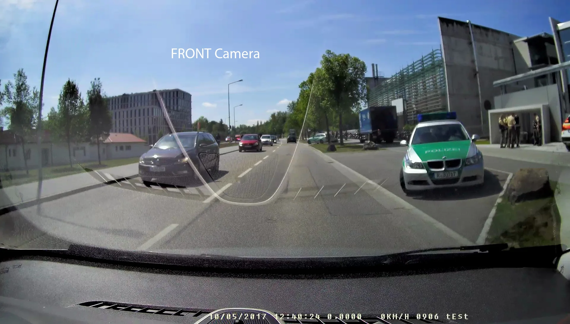

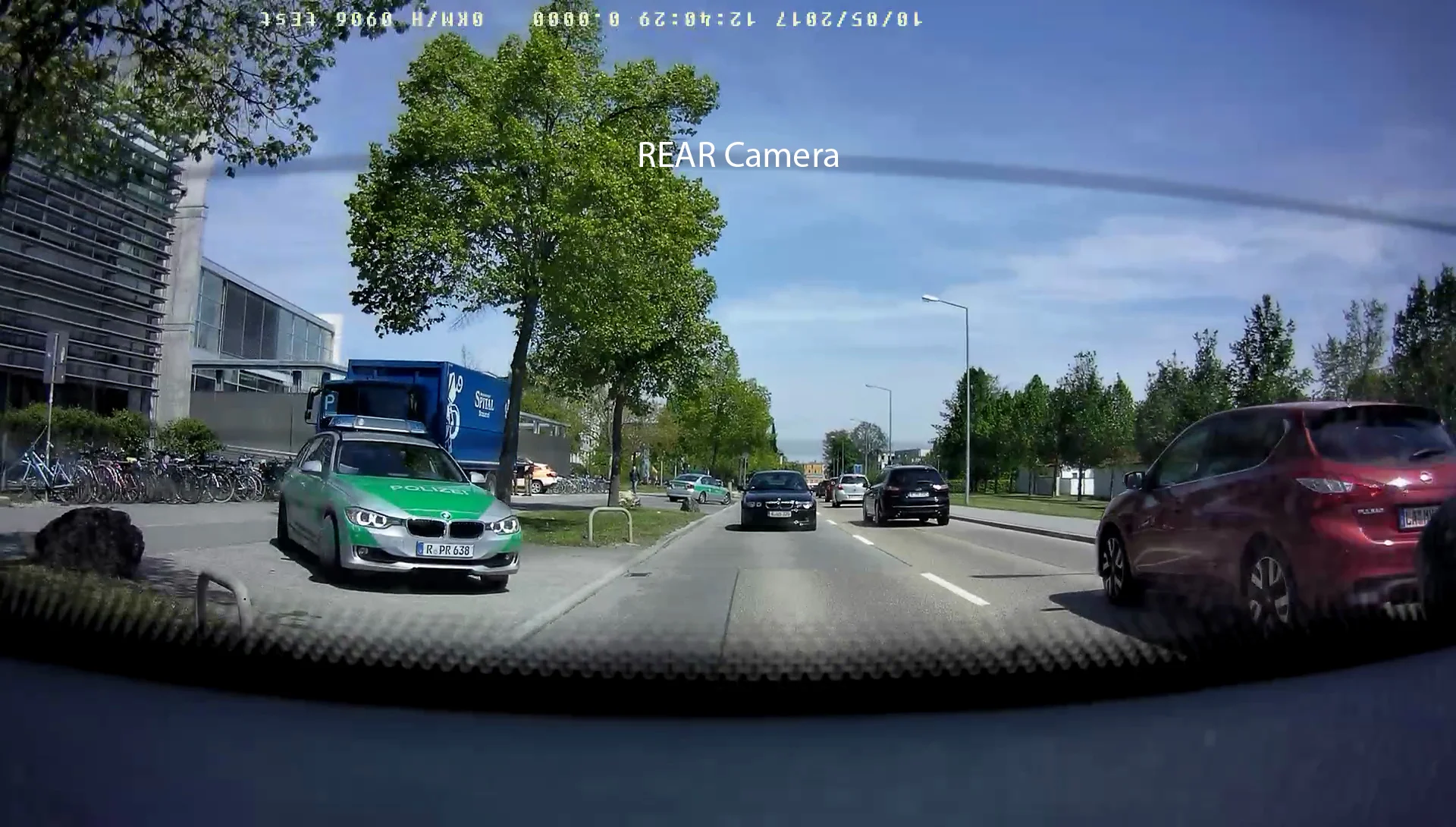

I'm not quite sure if the bad quality of the front cam is influenced by the dashboard reflection. But rear cam quality is way better than front (and gps still doesnt work/doesnt lock)

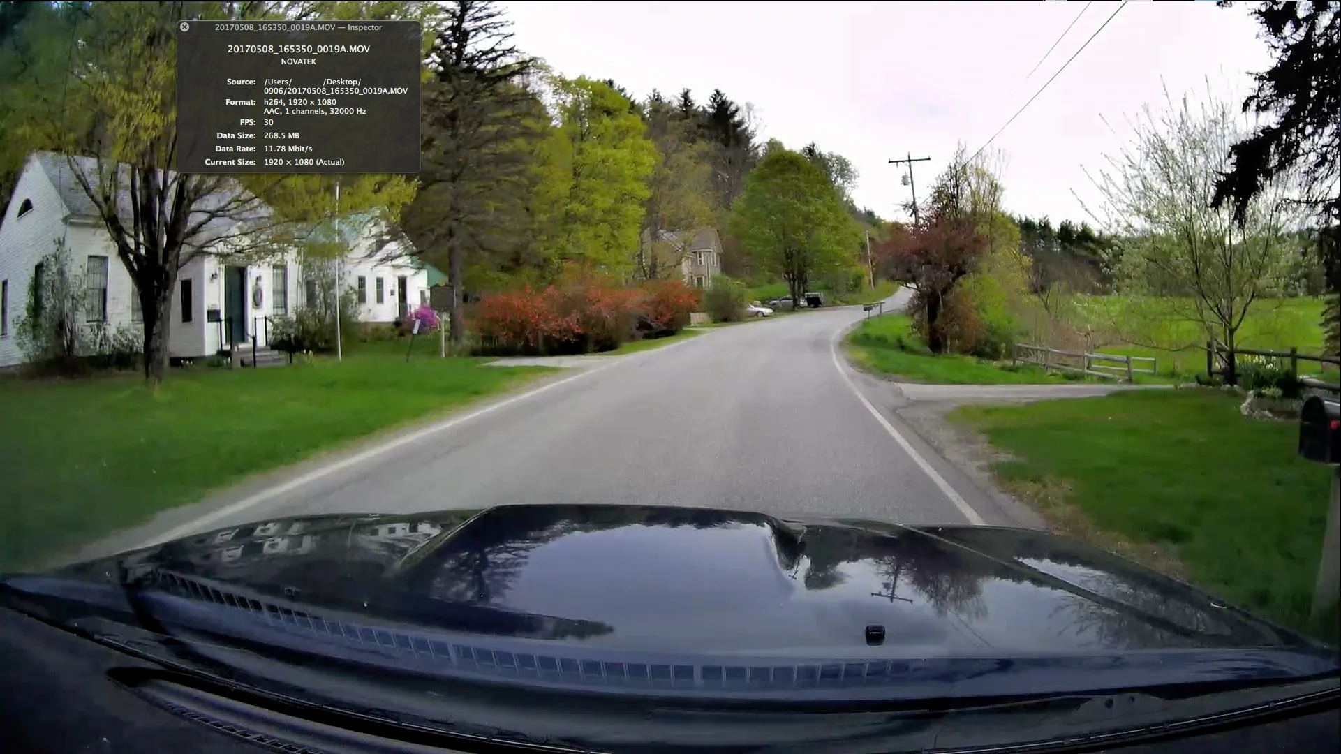

I'm experiencing what to a certain degree appear to be bit rate degradation issues, separate from focus issues, especially in complex textured scenes with motion such as trees. The bit rate appears to be highly variable. At one point when I had only the front camera installed I had some footage that showed a bit rate of nearly 37 Mbit/s. With both front and rear cameras deployed bit rates average 11.5 t0 12. 8 Mbit/s on both cameras.

Sometimes I have reasonable bitrate on the front when using both, but then it will drop down to 11.6Mbit/s for no obvious reason and that really does spoil the quality. Last night I recorded a few hours under moonlight with front only and got a constant 14.8. We want it over 18Mb/s for high quality 1080/30fps...

Thanks @Nigel, you seem to be confirming my experience. And I agree, we need a consistently higher and dependable variable bit rate or perhaps a menu choice between a variable bit rate and a constant bit rate as on the Mobius 2 camera.
Yeah bitrate and more of it would be nice, and a VBR/CBR choice would be nice to have in the menu.
