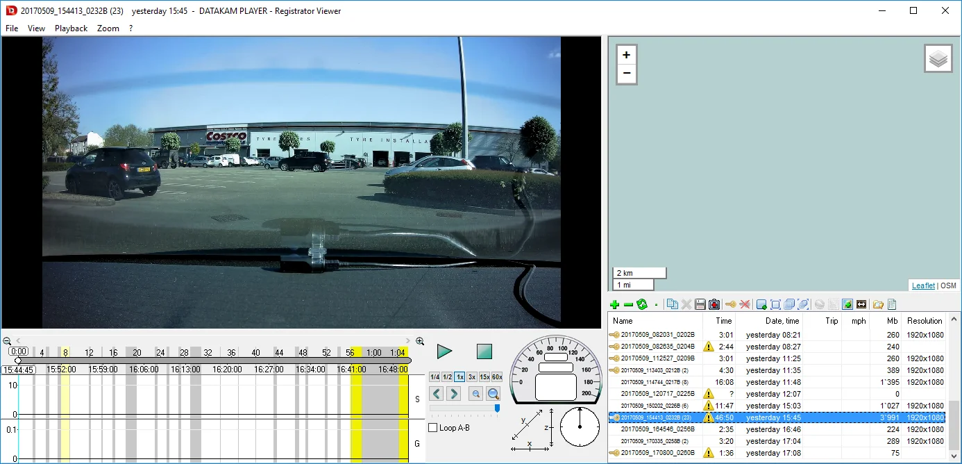

I've just split the files manually into front and back folders to try and make life easier for Registrator Viewer but spotted a new problem which is masked by the RV file handling when front and back are both in the same folder.
I drove about an hour each way and with the files manually separated realised the camera kept dropping footage - there's no real pattern to it - some gaps are 20 seconds and others are 30 seconds and then there are entire minutes of video footage missing.
Wondering if the camera is rebooting on that 3rd May firmware as it's an abortion here.
Here's another example on the front channel - a 50 minute drive and you can see all the missing grey sections:

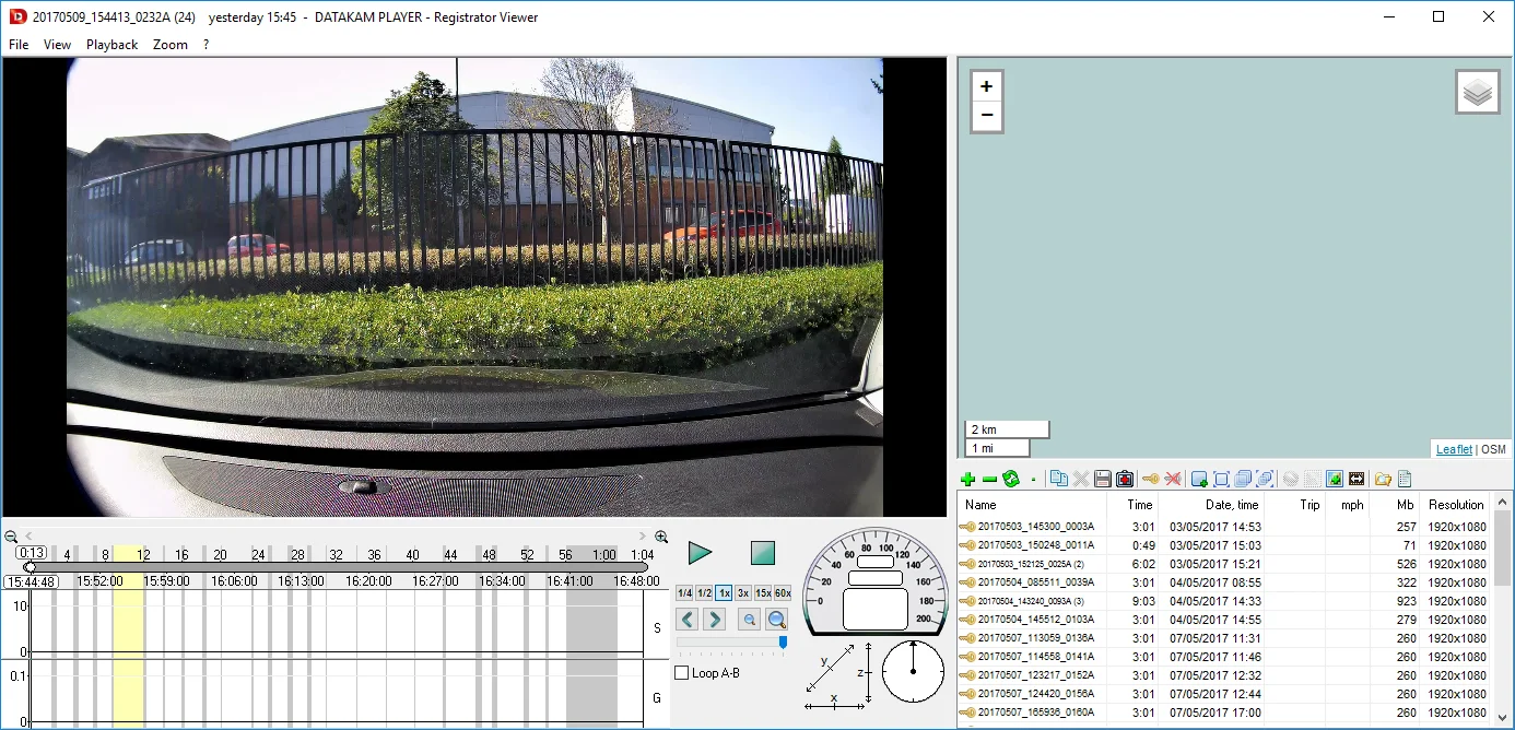

I checked the back channel files and they show the same problem:

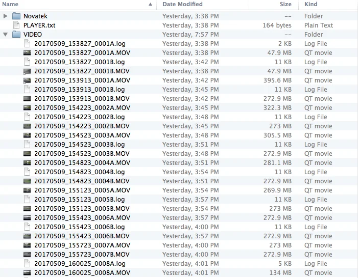

The actual files are below:
You can see the filesizes are jumping around due to the missing footage.
The files are there in sequence for the front channel but the back channel is definitely missing a couple (241B and 246B)
Have any of you seen this same problem?

The default format used by the new chipset is different to what Registrator Viewer works with, I wonder if perhaps some of the file handling problems are due to the changes they've implemented trying to get it working with Registrator Viewer
Possibly - I'm rolling back to the last April firmware for now to see if that had a similar issue 🙂

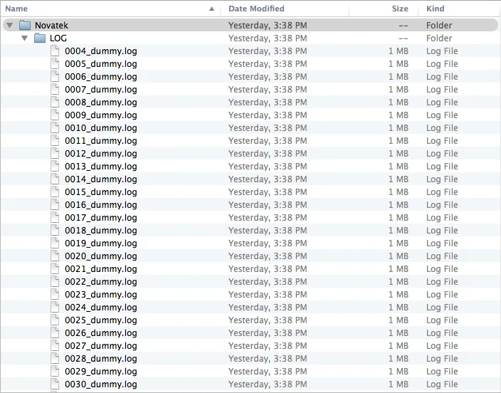

The default folders I'm seeing after import on a Mac show a LOG folder full of 1 MB dummy files with the same time stamp and a VIDEO folder full of A/B front/rear video files interspersed with the actual log files.
I've not seen another camera do this and it is cumbersome to deal with.

I've gone back to the test firmware from the 24th April and so far it's better for me than the one from the 3rd May - the stamps are all back, no missing video and it's shutting down cleaner than it was with the 20170503 firmware.

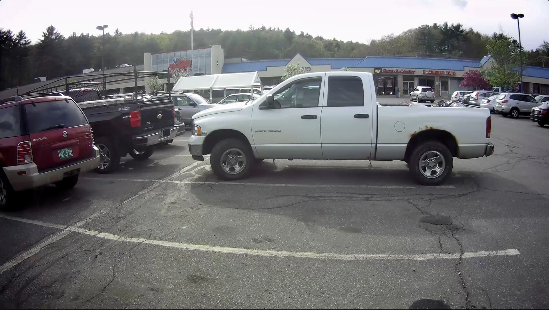

Due to challenges mounting the rear camera that will require a solution I just don't have time for at the moment I've mounted the 0906 rear camera in the right rear window of my truck which necessitates the need for the "rear camera flip" option for me.
The "rear camera flip" option does indeed work properly now for me with the new firmware, so that's good, but now I have all the new issues @reverend mentions too.
BTW, as a lateral facing side camera there are serious shortcomings using the 0906 in this manner apparently because of the bit rate issues but the general lens coverage and performance is excellent. (any IQ issues seen here are with the camera, not the lens)
(Edit; no data stamps on this one. 🙁)
The IMX291 cans would be good as well for lateral cams in parking type mode when continuously run like you do with the power banks - at night they should capture more than cameras with other sensors 🙂

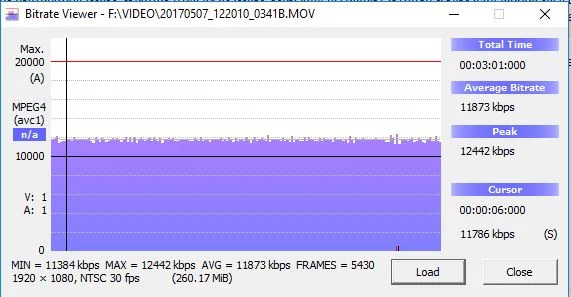

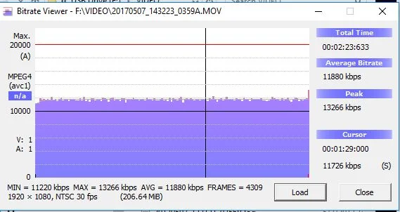

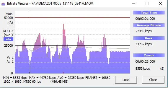

Bitrate change a lot from file to file. Max 44782Kb min 5840Kb
Back camera is constant.
All the photo on the left is from front camera
