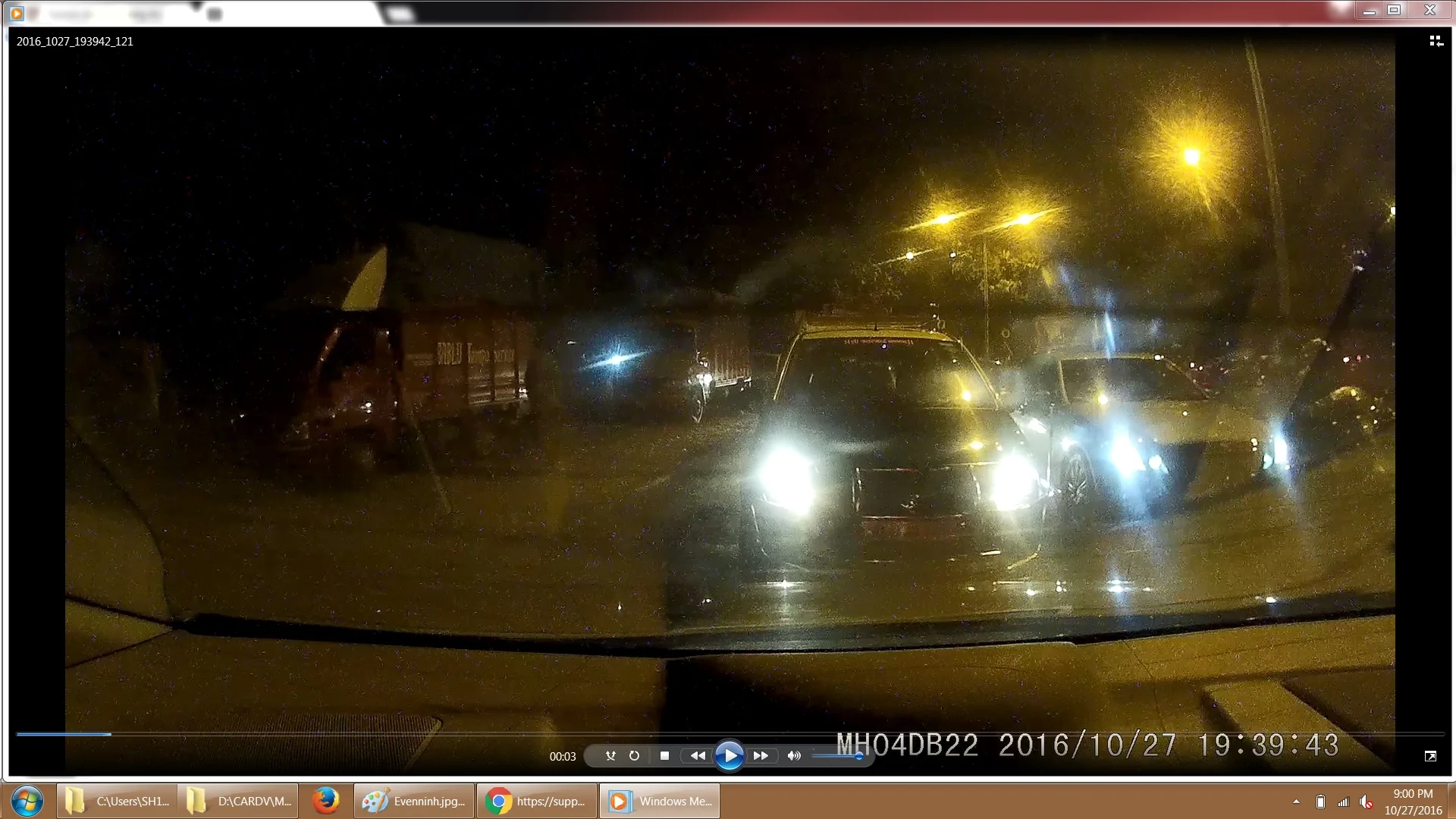

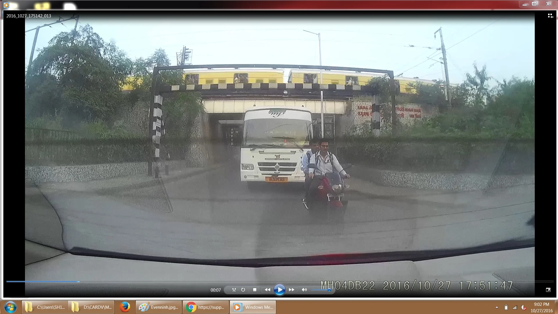

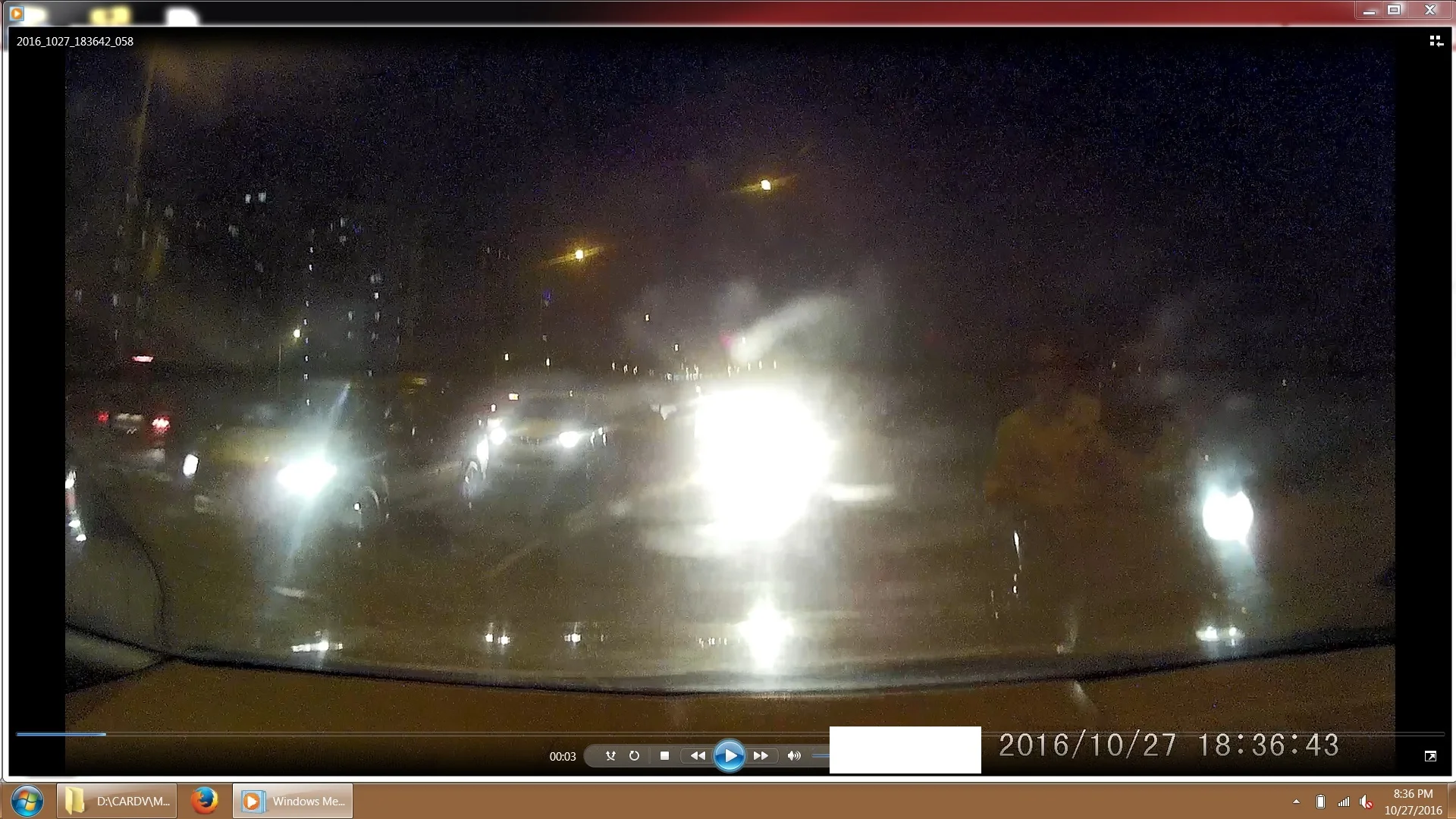

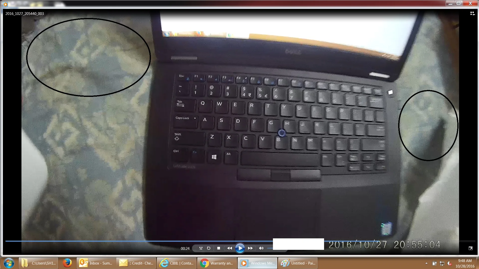

I had purchased a Viofo A118C dash cam from GearBest. This is touted to be the original and safe place to buy the A118C dashcam. So feeling confident i purchased the A118C from GB via order no W1610010728401985.
When i received the package and installed the camera i found that the videos were grainy and pics of poor quality. I am attaching a sample pic from purchased camera. Is this HD quality ? It's no better than youtube's 144p pic quality. The images are distorted and i have lost my money on buying a camera which does not functio as it should. The only consolatiob GB is coming up with is a 5dollar worth in the wallet. If i want a refund i have to ship the camera back to China at my own expense and time.
Take a look at the images and tell me they are HD or not. Such things are not expected from sites like GB. If i had bought from some shady site i can understand. But if you go around saying you are among the best in the business and this is what you deliver then what more does one have to say.

Could you share a video via YT or the RAW file via dropbox or google drive?

The night screenshots with the glares look like the windscreen are dirty? Can check if the piece of lens protector have been taken off the lens?
Can upload a video for us to see?

you have a lot of reflection from the light colour of the rear shelf which is washing out the picture, as a test put a black cloth across the back shelf and check the result and compare
Yup, the videos look ok minus the reflection. A CPL should help to a great extent. Clean the windscreen too, inside and out.
