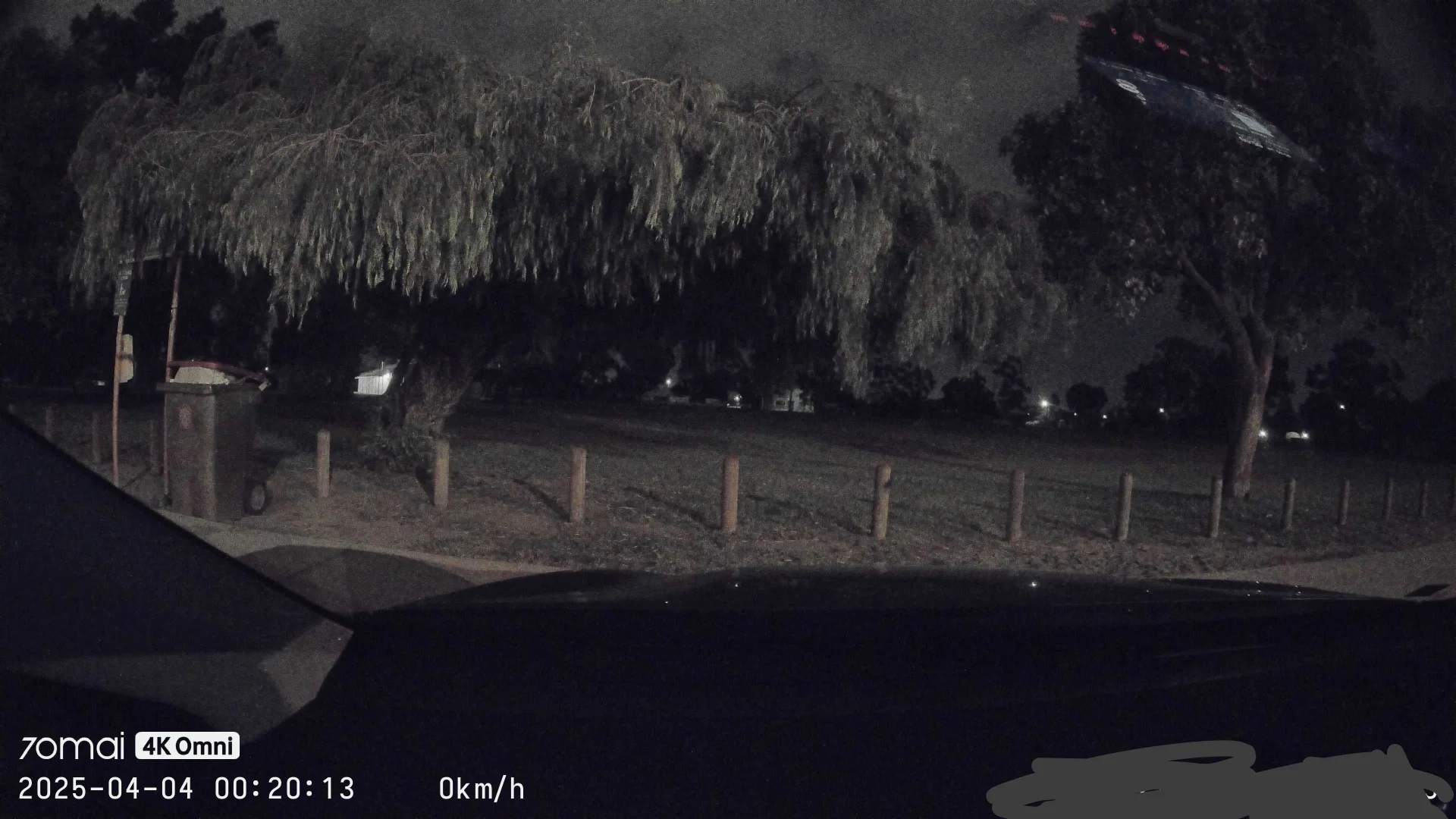

Just a quick post to show the capabilities of the 4K Omni at night in its parking mode, with what 70mai calls Lumi Vision.
First photo is recording whilst in normal driving mode with the vehicle engine running, the second photo whilst parking (sentinel) mode is enabled.
Not a bad result to bring in much more light.
