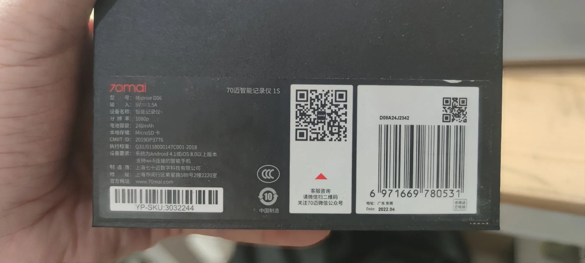

I want to ask, i tried to flash my 70mai 1S (picture attached), when i update with 1.0.4ww it successfully updated but i need to use 70mai APK chinese version (from this link https://rom-cdn.70mai.com.cn/OTA_731_FULL_midrive_v2.2.5_20220226-1722_all_70mai.apk?t=1645867905996). It cannot use the APK for international version. Any idea how i can use international APK and camera can use english voice?
I tried also 1.0.9ww but when update finished and i turned it on, it showed flashing red light so i flash back to 1.04ww.
Thanks

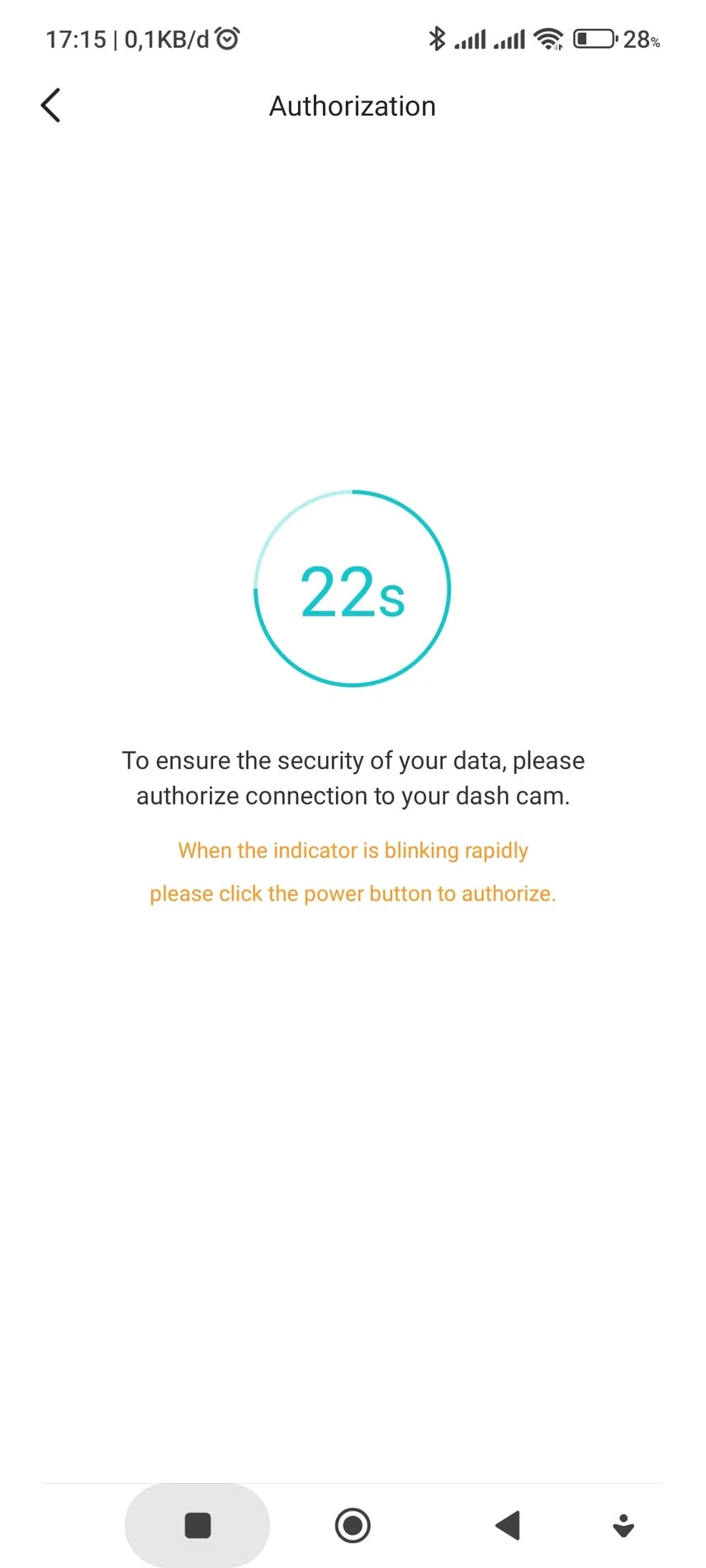

Hi @lisabon_Q3 , I think You are a hero on the internet, thanks a lot for Your help in the many dashcam forums, we hope You are healthy always.
By the way, in my forum, many have had problems with the "Autorization" process during the first installation, the problem arose when the application asked the dashcam to "click the power button to authorize". Even though the user has clicked many times, the application does not respond until finally "connection request timed out".
The firmware used is a Chinese-English mod, version 1.0.4ww, with a dashcam 70mai mi drive D06 produced 2022-06. In previous productions of 2022-04 and below there were no problems like this. If we use the mod firmware version 1.0.9ww there will be an error on the dashcam (dashcam does not respond and the indicator is always red).
We have also tried to downgrade the international application to 2.1.1 or 2.1.0 or 2.0.4 to 2.0.1, but still having problems during the "Autorization" process
Could you please fix the firmware 1.0.4ww so that it can respond during the "Autorization" process for production 2022-06 and above?
Thank you
Thank you

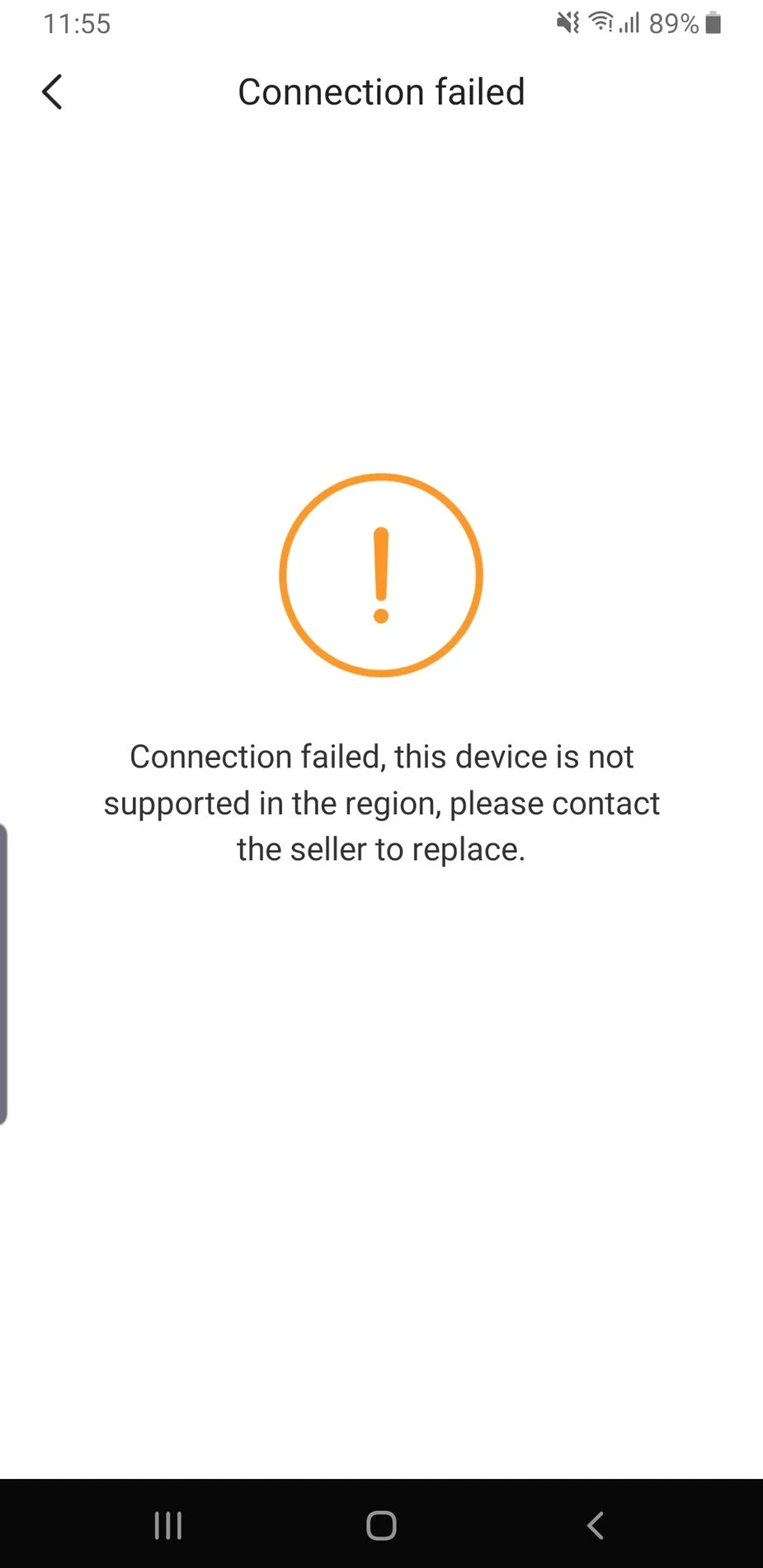

@lisabon_Q3 hi I have a 70mai 1s camera, it was working normally but after a while an error started to appear on the app screen “Connection failed and this device is not supported for use in the area. Please contact the seller to replace” I am an iOS user. the camera is chinese and i saw in a previous message that i should change it to international could you help me?
Greetings, check I have a 70mai 1s Chinese version, they sent me the firmware to pass it to English and it was corrupted when I turned it on, the green light turns on and then the blue light stays stuck, and there is no point in loading the firmware or what firmware is You can charge him to recover said camera, I have contacted him and they do not give a clear answer. some help please

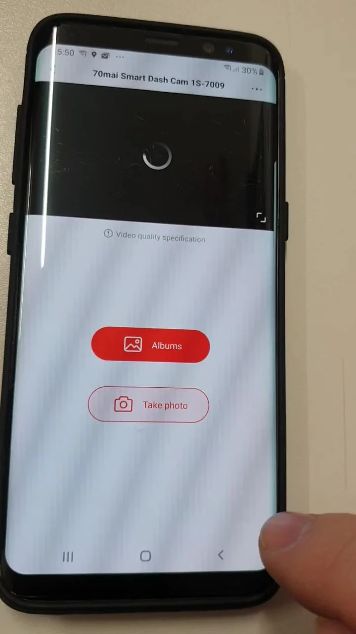

I have a 70mai D06 Chinese version, I tied the 1.0.4ww and 1.0.9ww, update successful, connect the app successful too, but stuck at the last step, it can't show the film!the date of manufacture is 2022.09
Hello. You have a NEW version of the Chinese 1S. I guess there's another image sensor there.
Here is the firmware, it has English in it and will only work with the Chinese application:

Thank you for helping me with the 70mai camera, I have not been able to record a second of video, I already installed the latest version of the firmware, even so I have not been able to use the camera, it already connects with the application, but it never gives an image, attached photos I appreciate your help.
Good afternoon. You have a new Chinese version with a new GC2053 video sensor, not a Sony IMX307. You have installed the firmware for the IMX307 sensor.
Here is the firmware you need. This is the original Chinese firmware and it will only work in Chinese and with the Chinese version of the application. There is no other way.
