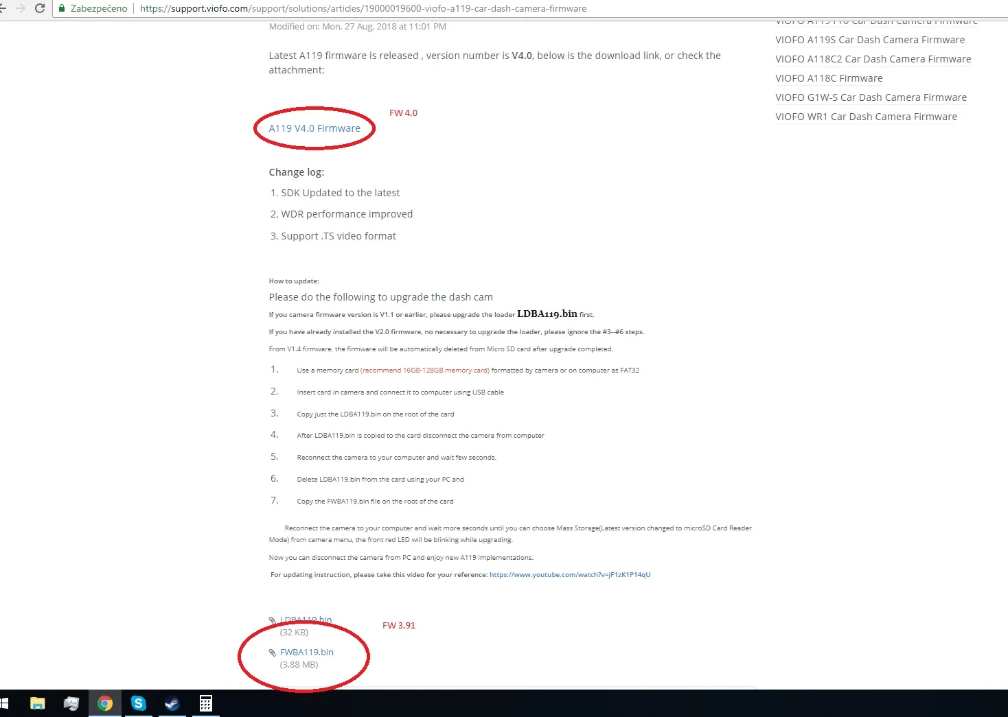

@viofo Please edit you support website. There is two download links. One for 4.0 and one for 3.91. I found this after 1 hour of reflashing fw and thinking why is still 3.91

Your FW MOD-07 (4.0 + 27 Mb/s) is 3.91. You probably did same mistake like me.
you downloaded the .bin file from the bottom of the page, I was lucky to download it from the top of the page. 🙂
