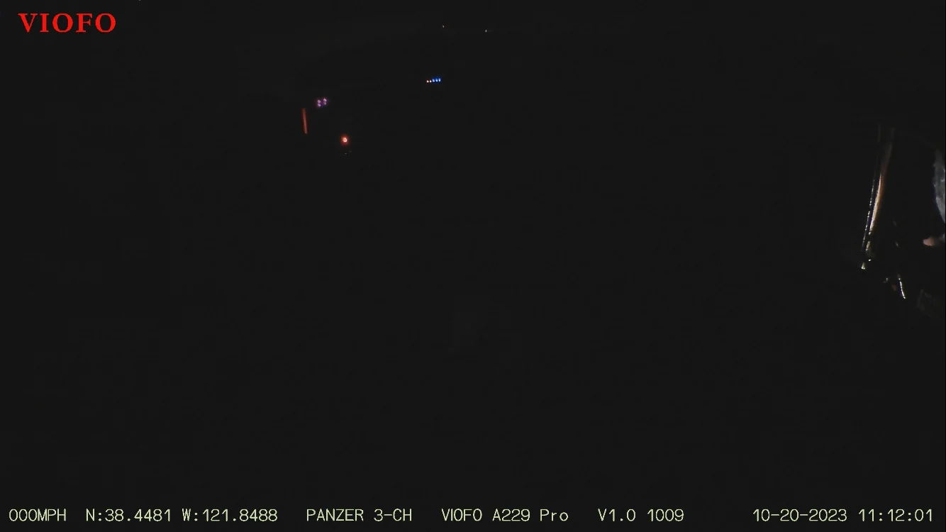

This screenshot shows the A229 Pro IR Interior camera installed at the top of the DRIVER side A-Pillar, and the A139 Pro IR Interior camera installed at the top of the PASSENGER side A-Pillar

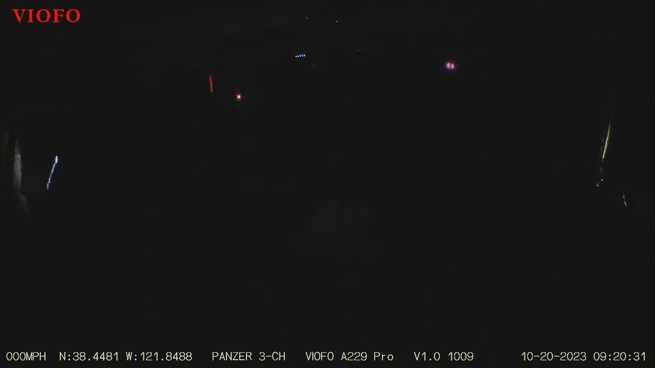

This screenshot shows the IR LED Emitters illuminated on the A229 Pro.

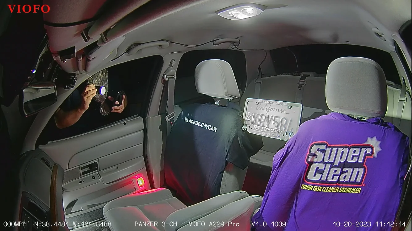

These two screenshots show the HDR working on the license plate, and the non-existent HDR on the A139 Pro.

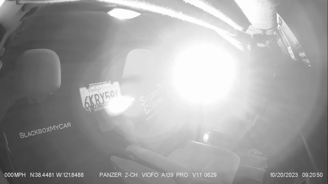

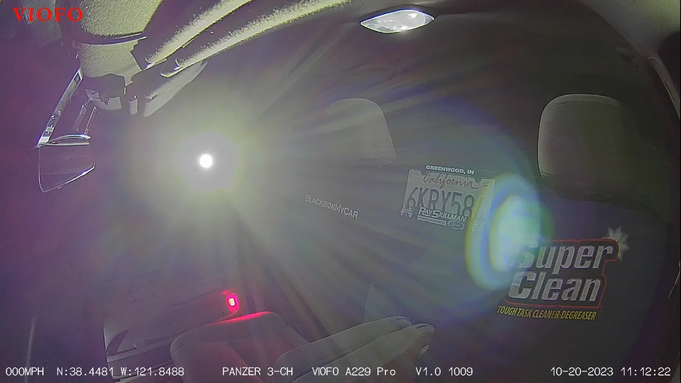

These two screenshots show the flashlight being pointed directly at the A229 Pro & A139 Pro.
