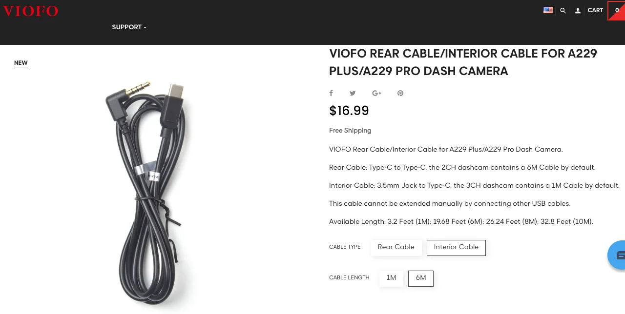

Hey Panzer do you know any alternative (longer like 10 ft) interior IR camera cables? It looks like a USB C to aux cable (right angle) with 3 lines (probably video capability in this context). I want a interior camera view showing the steering wheel view so I can connect it when needed, and just use two channel day to day. If you have an amazon link that would be amazing. I can't find it on the Viofo website.

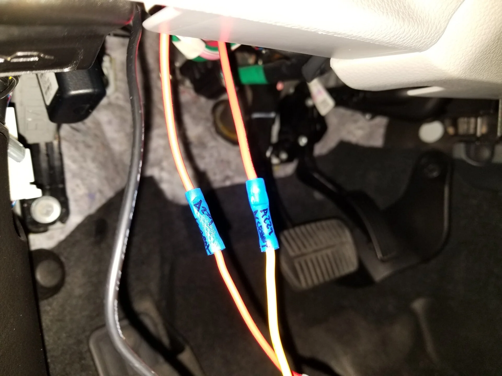

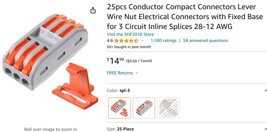

Also, I was wondering the best way to connect the stranded wire to the fuse tap. In the hardwire hk4 kit it says to use needle nose pliers but the metal is too hard to bend. I would prefer something like
at 10:01
https://www.amazon.com/gp/B07K7H7BXMhttps://www.amazon.com/gp/B07K7H18SR
Thank you, Panzer! I have Wagos for both versions you linked so I guess I can just use those tomorrow! Is the latest version 1.0_231009 (what my one from Amazon has). Viofo website shows 1.0_230928 as latest.
I’ve used the single version of those type of connectors for my fuse tap on my A119 V3 and it’s worked great. I’ve just used the same thing for my A229 Pro which I installed today, so I’m hoping that it works just as well

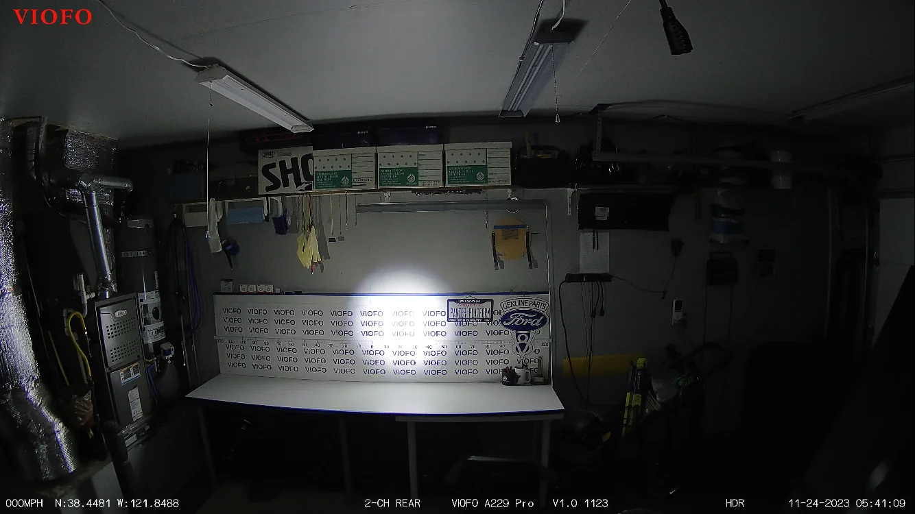

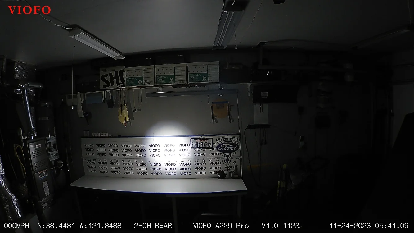

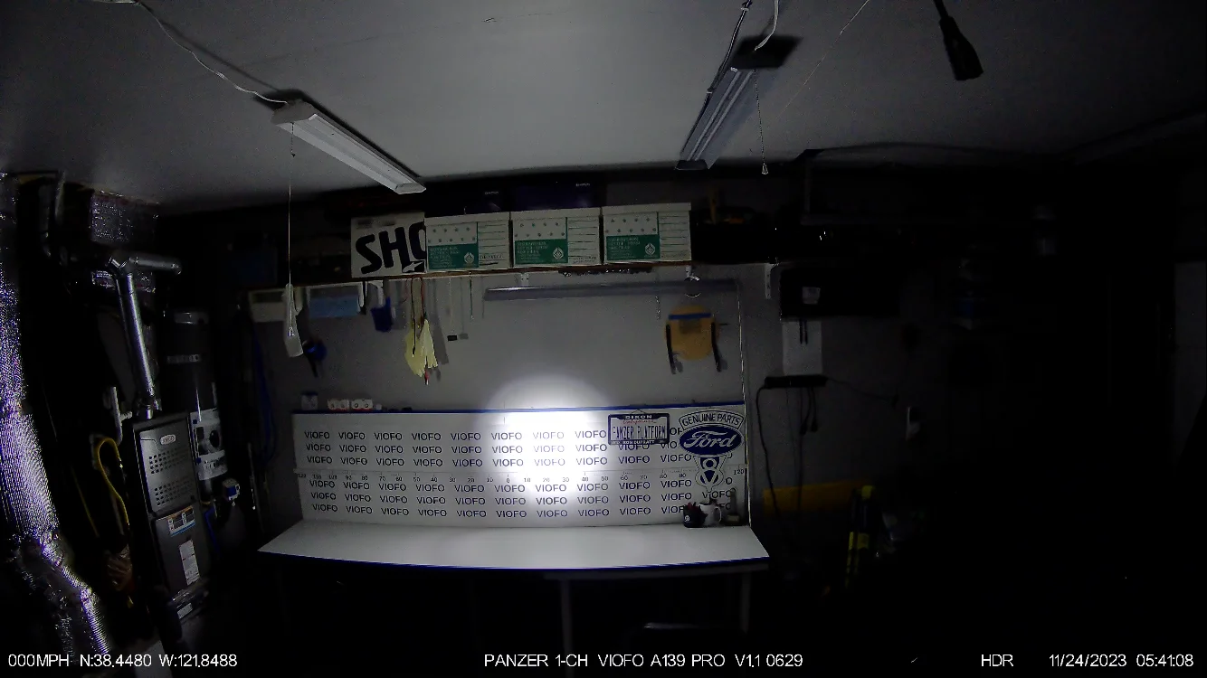

Before I head out I wanted to quickly confirm & verify low light HDR performance in my garage.
Cameras on the test rig;
A229 Pro 2-CH Rear configuration to maintain the front camera’s 57Mbps Bitrate.
A139 Pro 1-CH configuration to maintain the camera’s 57Mbps Bitrate.
A229 Plus 2-CH Interior configuration.
A119 Mini 2
Keep in mind the A229 Pro & A229 Plus Rear & Interior cameras are identical, and provide identical image quality.
Also keep in mind this silly test is NOT the final judge of image quality.
The final evaluation will come when the cameras are installed in a moving car filming other moving objects.

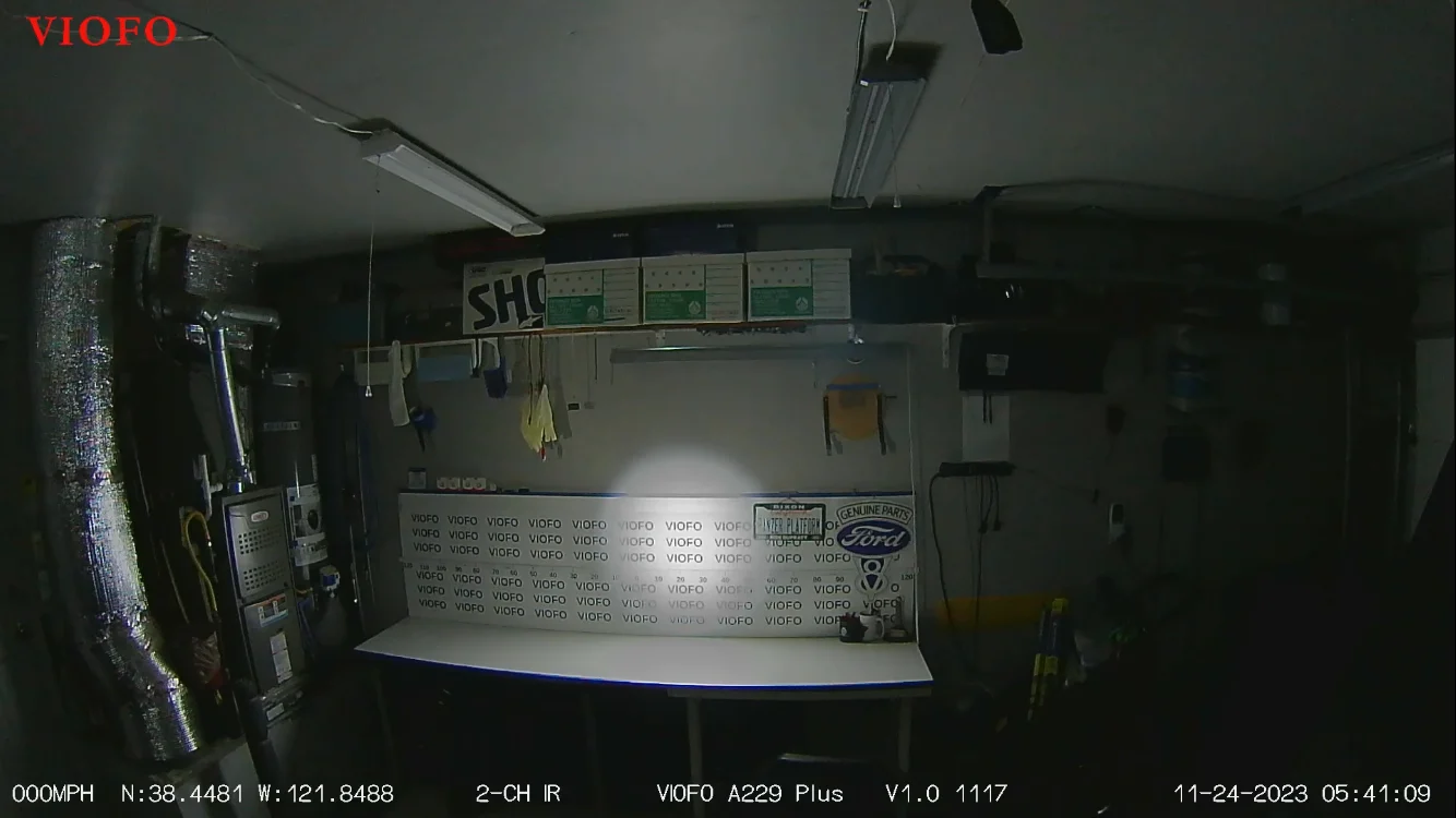

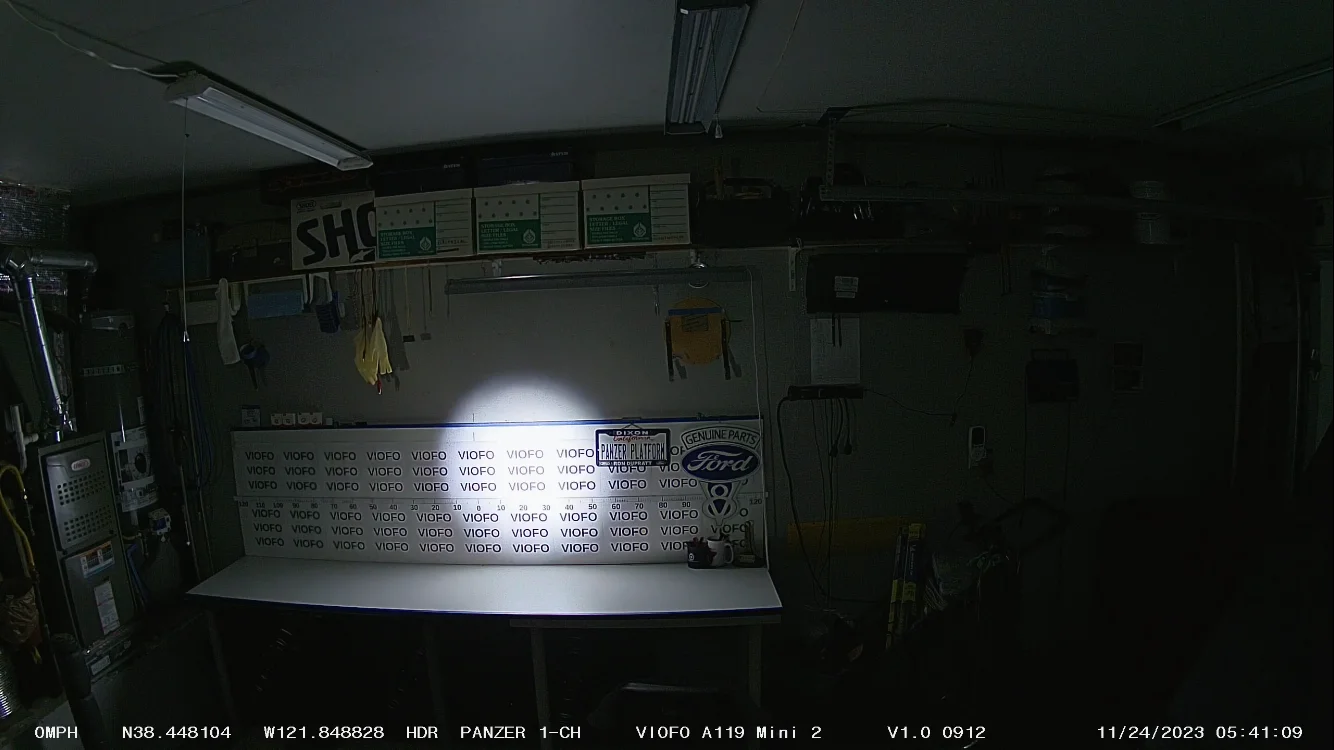

After reviewing this preliminary test footage the A229 Pro Front camera is much improved over A139 Pro in overall low light image quality.
Low light sensitivity is much improved providing a brighter image, with much less noise. You can really see the improvement in the video.
However, HDR performance of objects under direct illumination are slightly lower than the A139 Pro (about 90%).
The A229 Pro Rear camera HDR performance is much improved, and is on par with the A139 Pro, maybe even slightly better.
The A119 Mini 2 is still king of night time HDR performance when objects are under direct illumination, no camera can match its magical resolving power.
As an interesting side note check out how well the HDR works on the A229 Pro & A229 Plus Interior camera.
You can see in the video it takes a long time for it to transition, but once it adjusts it works great.

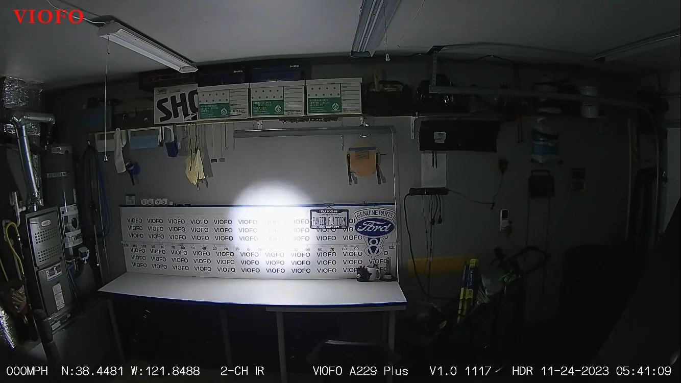

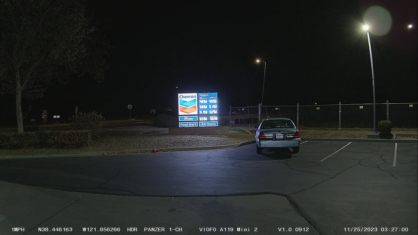

I also forgot to confirm & verify my indoor HDR comparison with an outdoor HDR comparison.
@safedrivesolutions @rcg530 @Vortex Radar @viofo @VIOFO-Support

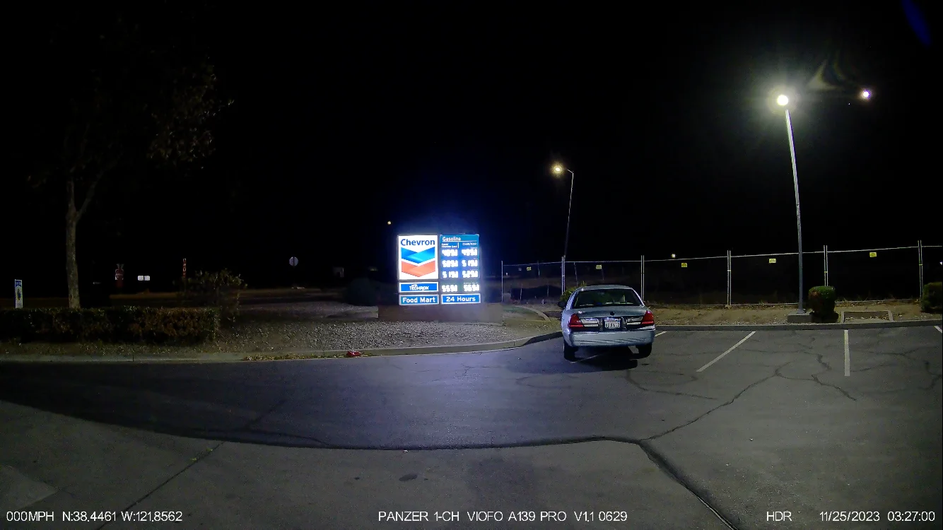

Well, it looks like I might be having crow sandwiches along with my Thanksgiving leftovers.
I am less than enchanted with the HDR performance of the A229 Pro Front compared to the other cameras.
I know what you’re going to say Bill;
“Stop filming stationary scenes, mount the cameras in your car, and go for a drive”.
I will, I will, this is more or less to satisfy my own curiosity.
A119 Mini 2
Also keep in mind this comparison is NOT the final judge of image quality.
Firmware;
A229 Pro Front: 1123
A229 Pro Rear: 1116
A229 Plus Front: 1117
A139 Pro: 0629
A119 Mini 2: 0912
No CPL Filters
All Bitrates Max

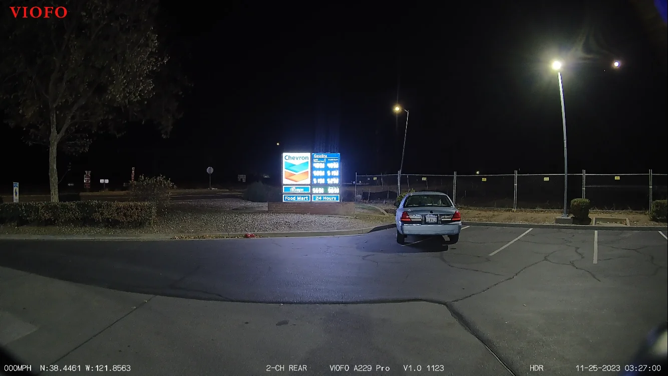

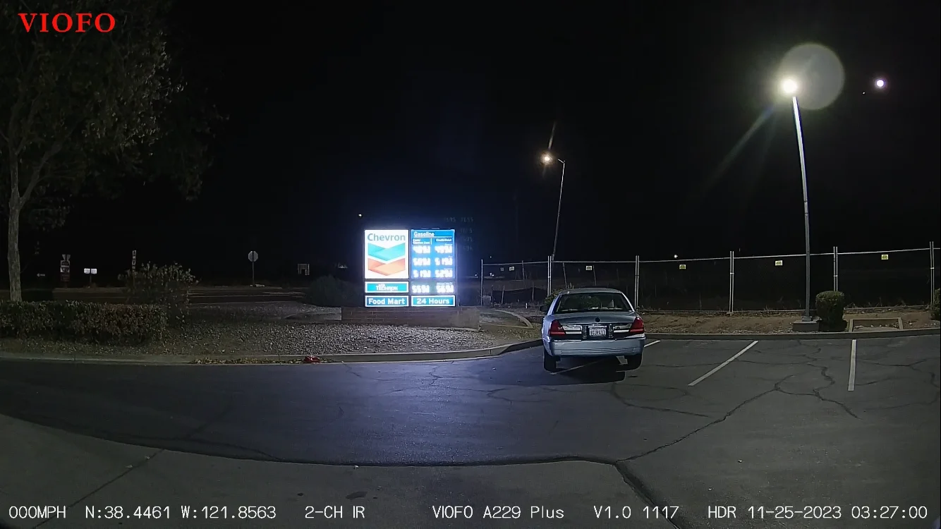

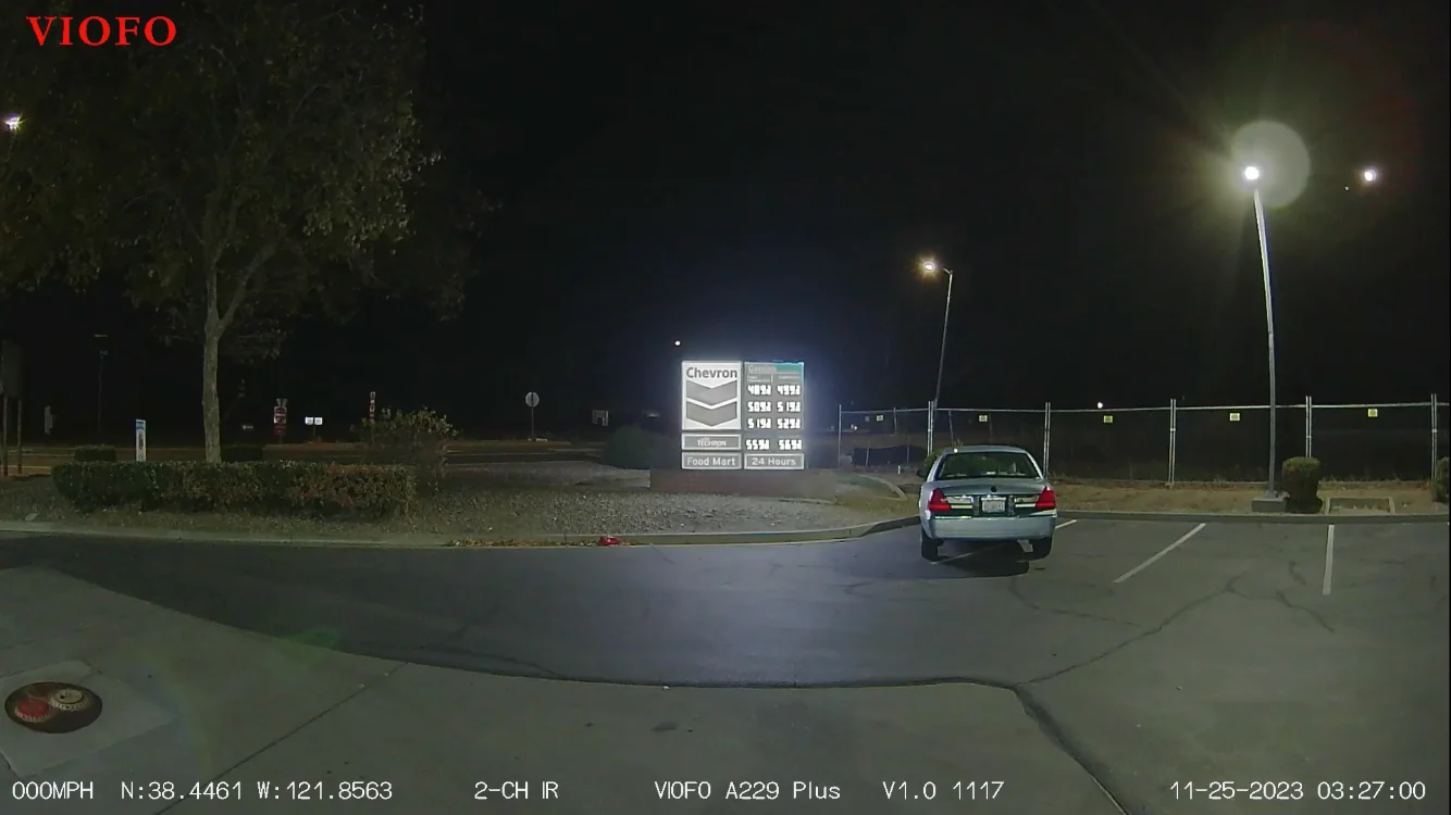

After reviewing this comparison footage the A229 Pro Front appears to be overexposing the individual digits on the illuminated price sign.
I use this sign for comparison testing because the digits are made up of intensely bright individual LED’s.
I’m also seeing a streaking artifact extending upward from the sign.
Everything else in frame other than the price sign is bright, and beautifully resolved compared to the A139 Pro.
However, it appears this brightness is coming at a cost of overexposing the price sign, (is this correct?).
Can you guys read the prices?
If so, on which camera?
Comparing the front cameras of the A229 Pro & A229 Plus the license plate on my car is more legible with the A229 Plus.
This is due to the much narrower FOV of the A229 Plus.
The only camera that can “read” the license plate is the A119 Mini 2.
Can you read it?
Low, and behold what the heck is going on with the A229 Pro & A229 Plus “low” resolution Interior camera?
That HDR is working great, and has no problem resolving the digits of the price sign.
However the 1080p “low” resolution in unable to resolve my license plate.
And yes, I have the IR LED’s set to OFF.
The 1123 firmware changed the colors significantly.
Here’s what the colors looked like with the previous 0925 firmware, (same sign);
Interesting side note the current moon phase was 96% Waxing Gibbous so this scene is as bright as it can get during night time.
I unintentionally captured the moon, (next to the closest lamp post).

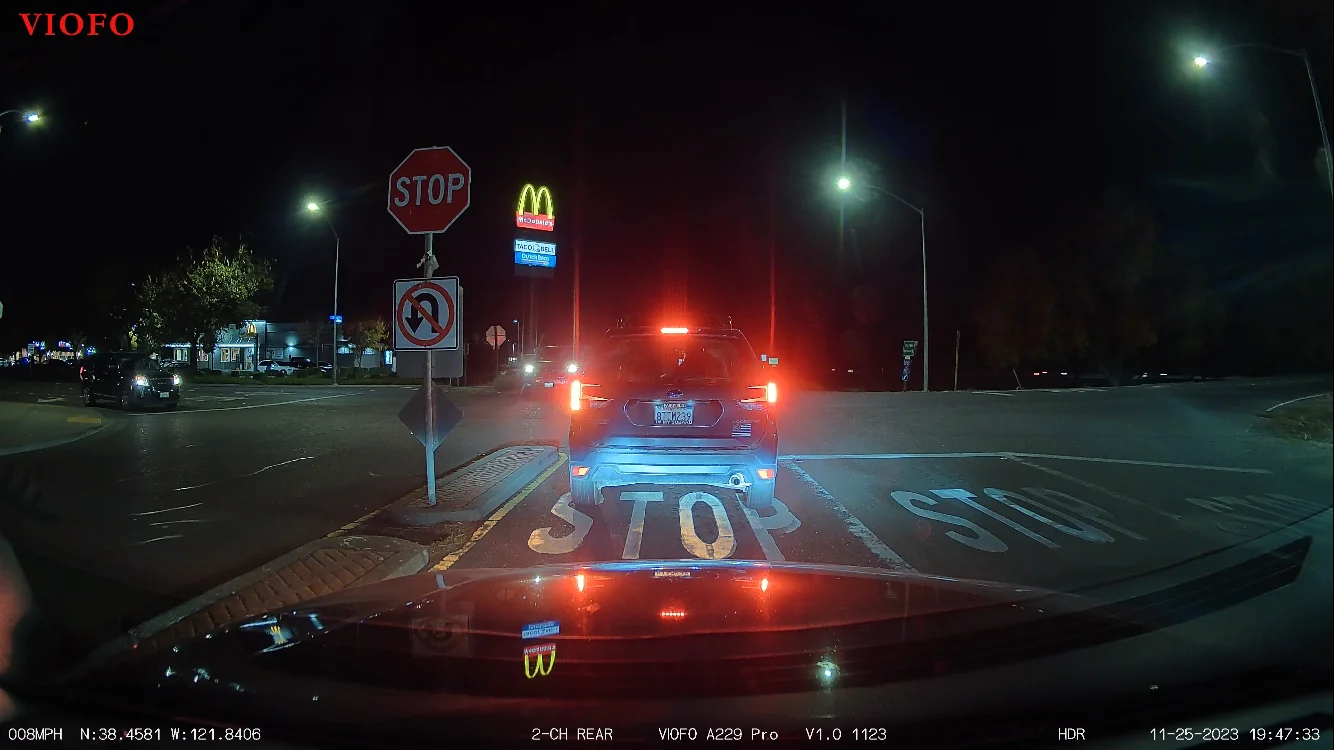

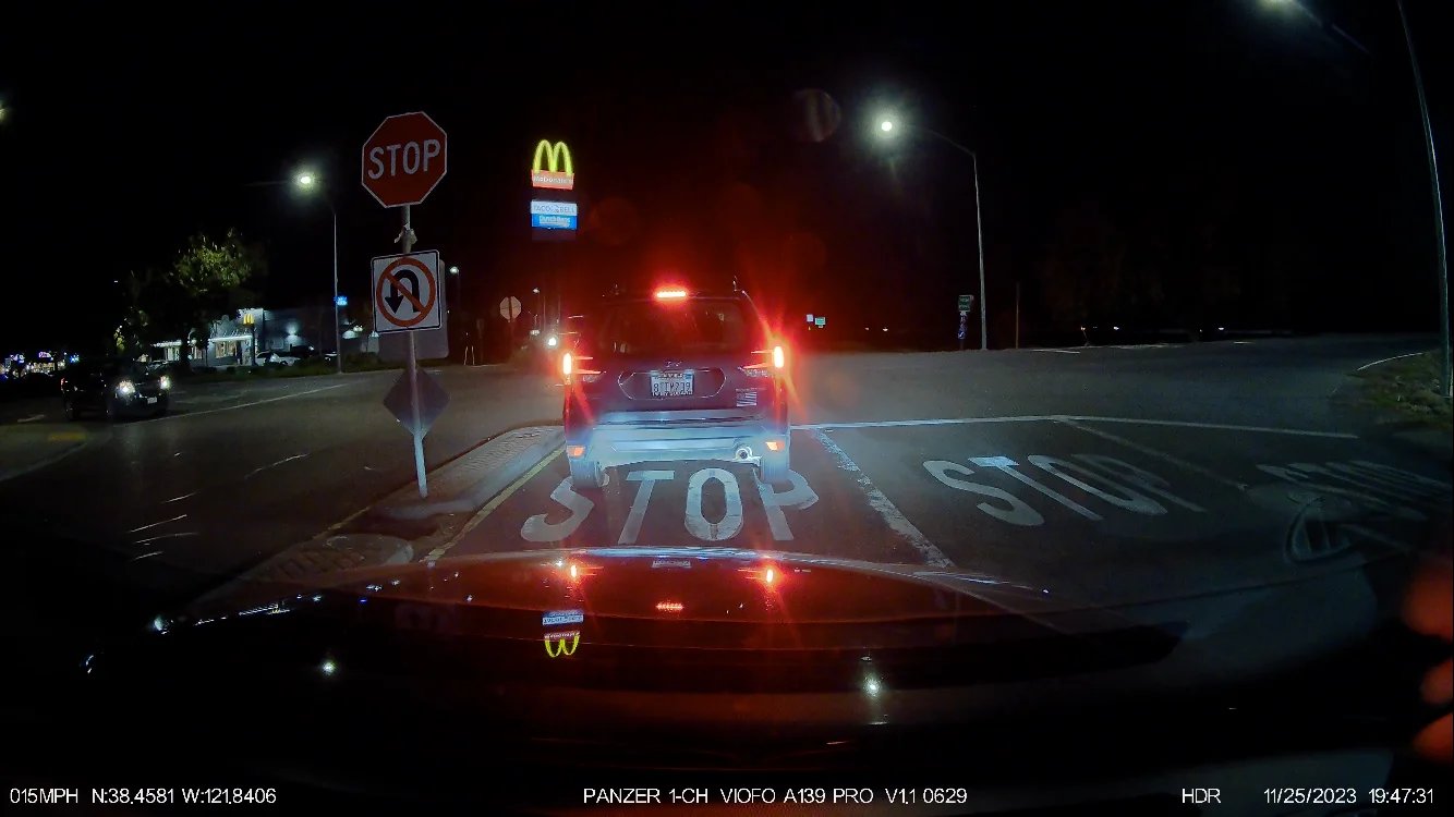

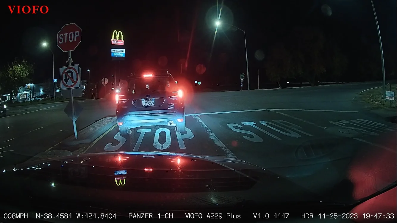

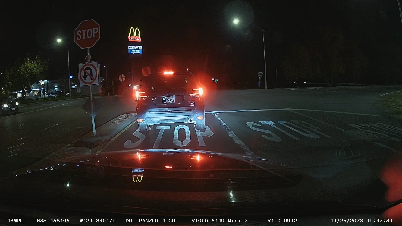

Here’s my first night time “DRIVING” test footage.
I filmed this just a few hours ago, and I’m reviewing the footage now to pull out some screenshots for comparison.
This is my usual test loop I’ve used for every dash cam I’ve tested since 2019.
I upload all the test footage to my second YouTube channel, and categorize them into playlists so they can be easily found, and compared with new dash cams.
Shout out to @ozguy for requesting GNR just in time for the holidays, it’s a jungle out there.
Cameras & Firmware;
A139 Pro: 0629
A229 Pro: 1123
A119 Mini 2: 0912
A229 Plus: 1117
No CPL Filters
All Bitrates Max
License plate, and illuminated McDonald’s & Taco Bell sign best to worst;
1.) A119 Mini 2
2.) A229 Plus
3.) A229 Pro
4.) A139 Pro
It looks like the narrow FOV’s of the A119 Mini 2 & A229 Plus are more advantageous than the 4K resolution of the A229 Pro & A139 Pro.
What if the A229 Pro had a narrow FOV lens just like the 2K cameras?
I bet that would be awesome.
Subaru Brake Lights:
I’m seeing those vertical artifacts from the A229 Pro again.
I’ve never seen those before on any camera.
The A119 Mini 2 & A229 Plus have good HDR performance.
The A139 Pro doesn’t cope too well with the brake lights.
I just realized I screwed up the 50/50 road & sky lens alignment, and all the camera don’t match.
I hope @Mtz doesn’t see this. lol
