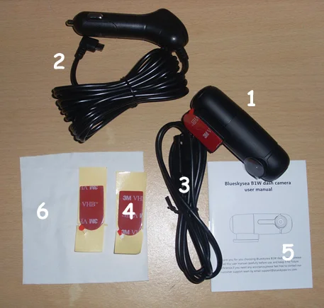

Opening the box revealed the contents:
1. BlueSkySea B1W camera with a 3M self-adhesive pad
2. Power adapter with micro-B USB cable and connector and with a USB Type A female outlet.
3. USB type-A plug to USB micro-B plug cable
4. 2x spare 3M self-adhesive pads
5. User manual (English)
6. Lens cleaning cloth

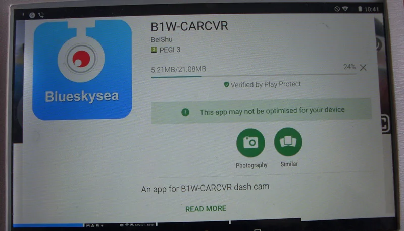

Download and install the B1W-CARCVR application onto an Android device from the Google Play Store - this application is about 21Mb in size.

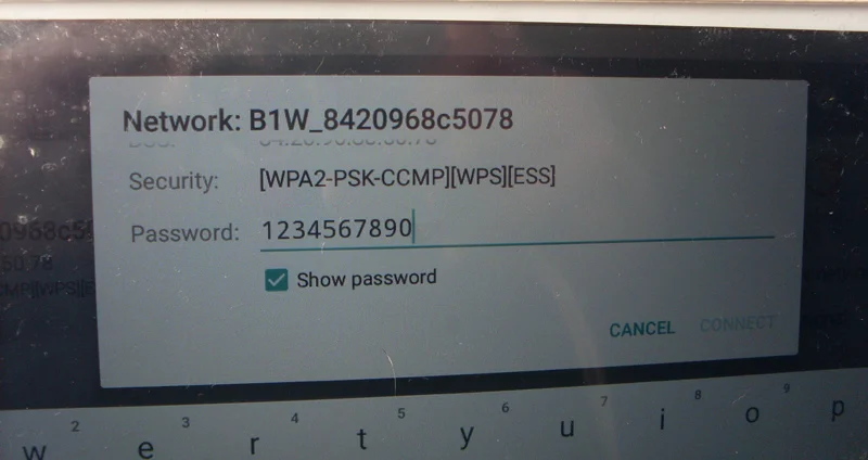

Within the WiFi connections on your Android device you should see the B1W camera
Select the B1W camera and enter the default password of 1234567890 then select connect
The B1W-CARCVR application can then be started on the Android device.

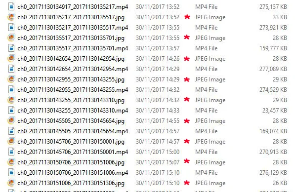

Another useful feature of the camera is that it takes a still jpg image before each recording (see listing with the red asterisk * below). This feature is very useful for indexing and finding certain video segments.

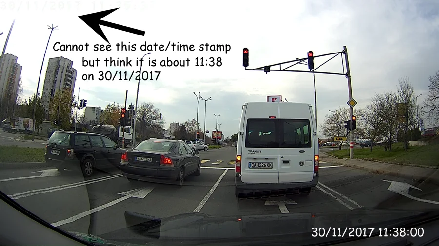

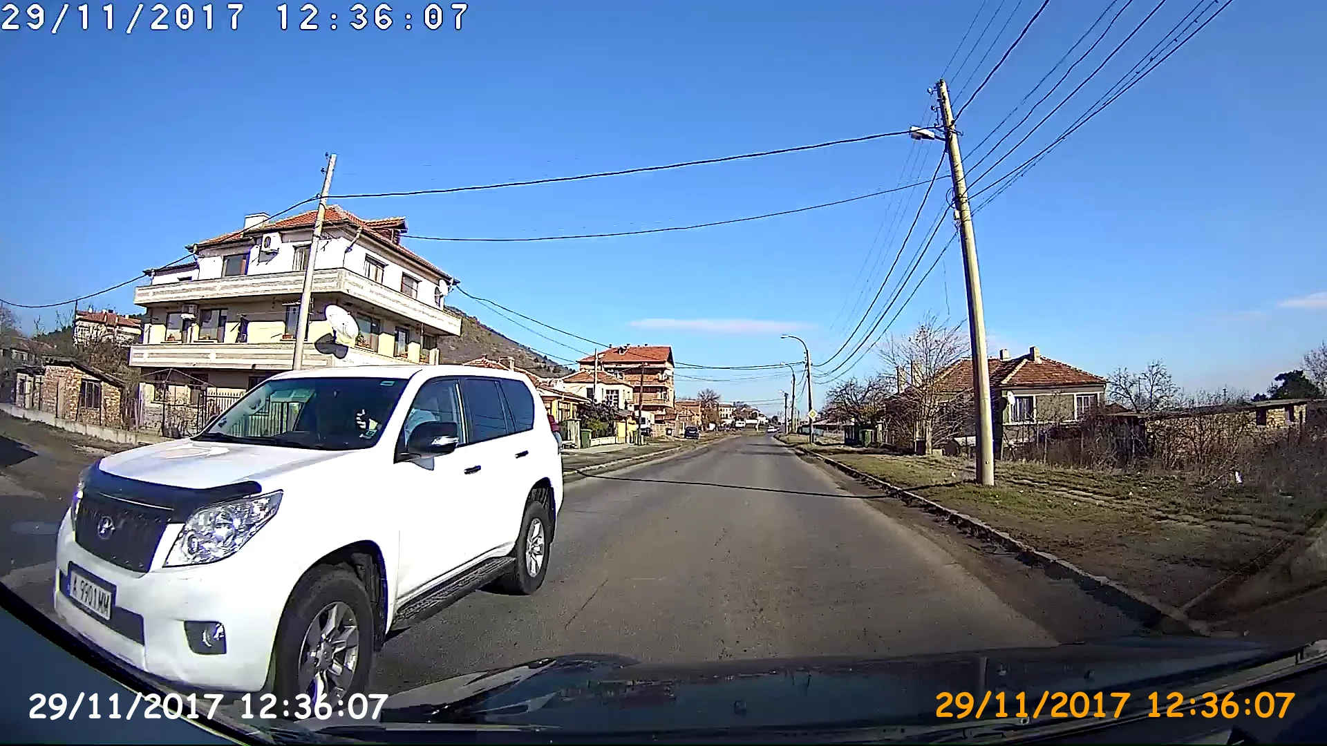

- Date/time stamp often difficult to read
- WiFi default is 'always-on' (this is being reviewed and may change)
My engineer is talking with Novatek about this configuration,we plan to make it remember your last WiFi configuration when next reboot;
- Date/time stamp often difficult to read;

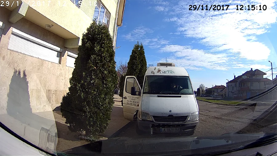

Which way is better for you? To bold it and with color,or to move its location to bottom?
Move it to the bottom is best, or give it more black outline would also work.
I quite like it where it is and it is always readable, just a bit difficult sometimes, more black outline would solve the problem.
- Low bitrate 12Mbps - some loss of fine detail
It does surprisingly well with the low bitrate, and it has the advantage that it records for twice as long before looping as the more expensive cameras, means you can use a memory card half the size which makes it even cheaper.
- Tends to over-expose highlights
It needs HDR, but no camera at this price has HDR.
- Poor sound quality
The microphone has captured when you use, and fail to use, the indicators, which could be useful.
It seems OK in your car; my car is too noisy for it, the microphone gets overloaded a lot of the time.
The main thing is to change the color to orange.
And may be to move its location to bottom
Thanks!
Regards,
Thanks!
Regards,
Is it better to color it with orange? How about the other's opinion?
Bought one off Amazon but could not get it to connect to the app using the default password 1234567890 stated in the manual. Turned Bluetooth and G4 data off in phone in case of interference but no joy. Left with nowhere to go returned it for a credit.
@Ricam My amazon CS staff told me that your order had been fully refunded already! And plus,we sent you a new dashcam,wish you can have a test it again when you receive it!
And i re-act this WiFi connection error when plug into laptop USB slot for power source,but it was solved after i changed a Samsung USB wall charger (5V,1.5A Output) to power it.
So it happens that you have a test it in your office also,just avoid my mistake to plug it into computer directly for power ,it should be better to test it in my car! 🙂
Thanks for your attention!
Regards,
Vicky
Is it better to color it with orange? How about the other's feeling?
Some people like orange a lot, especially the Dutch, but there are more people who hate orange!
I see the "black" outline is transparent, it is only black when it is over something dark.
If you made it full black (no transparent) then it would be much easier to read on a white sky, I think that is all that is needed.
Or this with a black date/time stamp at the top.....
date/time stamp
More suggestion?
My vote is for white with outline at the bottom right. Usually there is the dash which usually is black. At the top is the sky and many times it is overexposed which means too much white.
Is not nice to use yellow or orange compared to a white (even just a very little gray, like on TV ir DVD, Blu-Ray subtitles which are not pure white) and a correct outline, not too thin, not too thick. You can never go wrong with white.
enjoy,
Mtz
Looking at it closely, I think my vote would be yellow at the bottom..but it depends on the colour of the vehicle. As I have a black vehicle yellow shows up very well.
But may be one day it could be possible to make it user definable and place the date/time stamp on one of the corners and change the colour. 😉
My preference is white at the bottom which is usually a darker area of the car, than against a brighter part of the sky.
This is white on the left and on the right at the bottom .....
