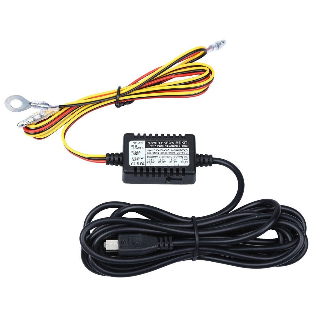

also i purchased this hardwire kit, but it has the extra ACC wire on and was wondering if this dashcam will support it? be great if it can hop between recording normally and parking guard mode so i don't have to use my phone every time to tell it to STOP/START recording 😛

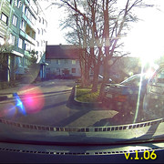

The difference in exposure processing and logo stamp in the frame.
v1.06 171017 vs v1.06 171207
Still it is necessary not only to lower the level of exposure, but also to change
the table expo-metering. The stamp-logo is seen better and located more logically...
The difference in the metering is dependent on the angle of inclination.
The original video is in the description for the video.

Just hoping that final firmware it works with hardwire kits with acc wire, so that it switches between normal and parking guard mode 😕
As hate having keep tapping "stop video" just to get it to go to parking mode when using a 3 wire hardwire kit and then to remember to "start video" when get in car again 🙁😢
