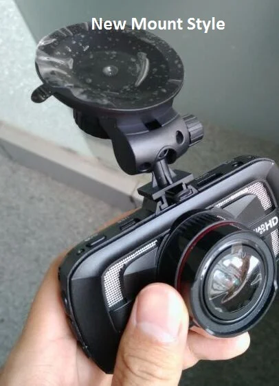

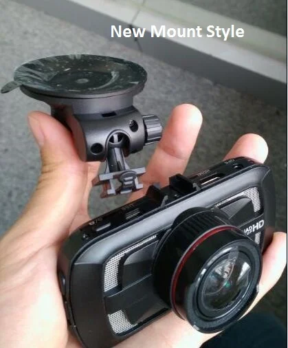

How good is the new mount style?
I had garmin GPS with suction cup that would drop from the windshield when the car gets hot (I mean mid 90s not extremely hot).
Can I use double side 3m tape in the suction cup to make sure it stays there?
Remounting the suction cup from time to time is probably a good idea. If both surfaces are clean, it should hold very well. Iptelman's solution allows you to mount up in the dotted area of the windshield, which is nice. Gets the suction cup off the glass surface too, which probably helps the suction on the warmer days.
