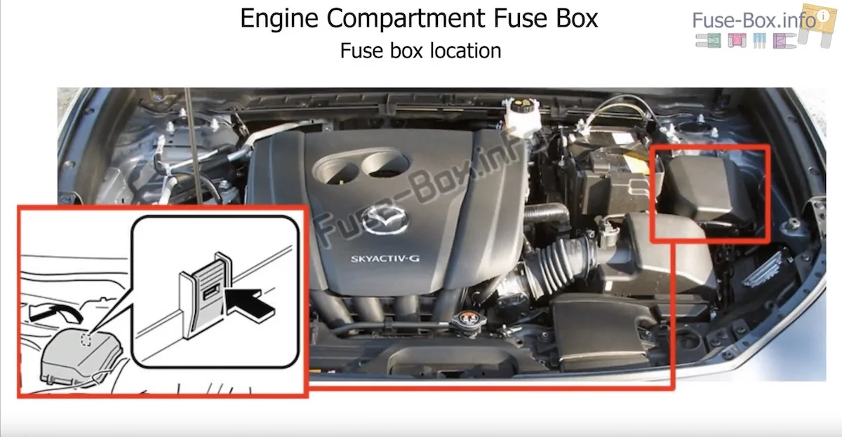

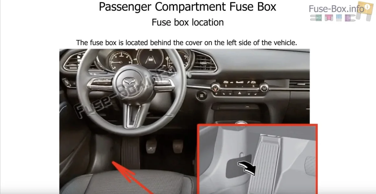

Thanks for the valuable information. I researched around and seems that Mazda CX-30 doesn’t expose fuse box. So OBD port seems to be the only option to hardwire the dashcam. However, isn’t 11.4V or 11.6V too low for a car battery?
This statement made no sense to me because every vehicle would need a way to access and change a blown fuse. While you didn't mention what year Mazda CX-30 you own, a little research reveals that there should likely be two easily accessible fuse boxes in your car. One would be in a compartment in your driver's side kick panel and the other would be in the engine compartment. Many vehicles use a similar arrangement.
https://www.mazdausa.com/static/manuals/2021/cx-30/contents/07031600.html
Sorry for being a rookie here. This will be my first car and I never have had experience dealing with car wires and dashcams.
About the fuse box thing I had mentioned, I got this information from couple of CX-30 forums:
"I bought a Viofo T130 dashcam recently and was fairly shocked to hear not only would it not work with the cabin fuse box, but also that Viofo is one of the only manufacturers who have not got an OBD2 powered option."
"CX30 doesn't have ACC fuse in the inside fuse box. Therefore, I cannot hardwire it.
So, can I use the ODB2 power adapter for the dashcam for parking mode?"
Because of this I assumed that for CX-30, I need to use the OBD2 port only for parking mode.
Just to add, I will be getting my car in coming weeks and it is 2023 Mazda CX-30. Apologies for not adding all the information initially.
I'm fairly sure your new car should have fuse boxes and there is a good chance you can hook up a camera to one of your fuse slots and have it work properly. I guess you'll have to see how it goes. I see online that the 2022 CX-30 has both fuse boxes.
Apparently, the ACC fuse in the CX-30 is in the engine compartment, but there is no reason you can't access it. Every car has various rubber plugs in the firewall where wires enter the cabin from the engine compartment and so all you would need to do is run the wires through one of those rubber grommets out to the engine compartment fuse box. This is a bit more challenging than accessing a fuse in the kick panel but certainly doable.
