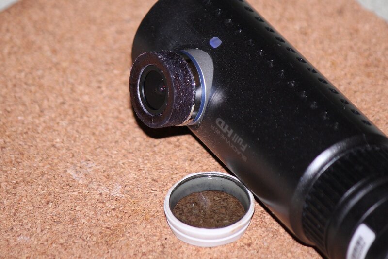

Did you have to open up the camera to use that lens? Does it stick over the existing one or completely replace it? (was it complex to do?)
How long will you test 1.1 before you release it to others? Nice work
Re: Custom Firmware for DR500GW-HD | Higher bitrate | No sta
video the sun directly into the lens
forgot used the polarization filter 😉
the lens is changed completely
it is slightly longer
therefore made trim
