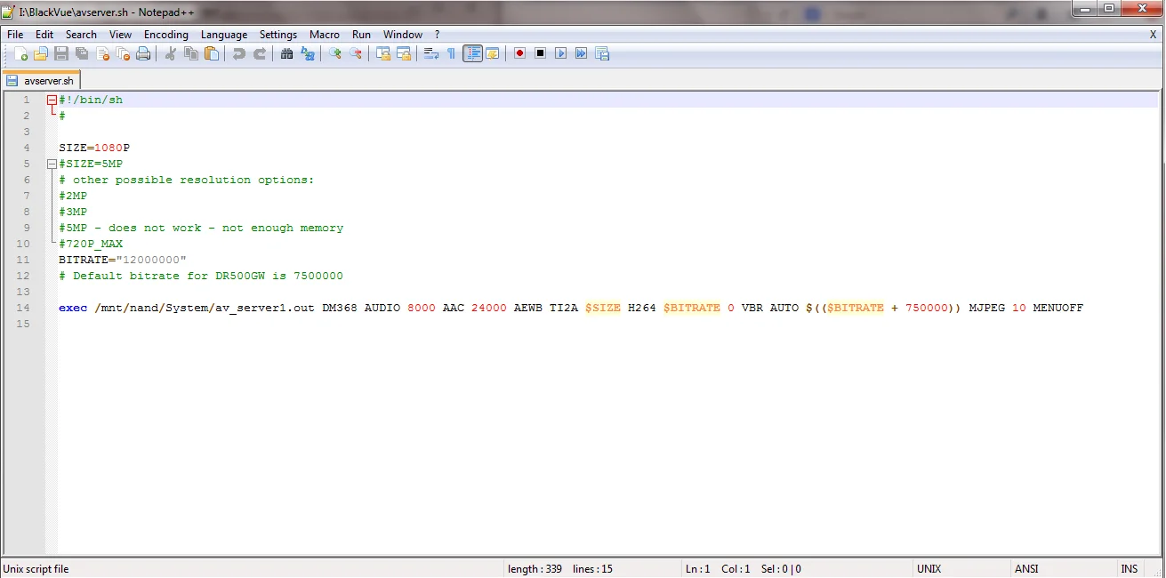

I installed the custom firmware from Mio and was reviewing the video I recorded today. It looked nothing like the samples so I went to the properties of one of the videos and was only getting 5000kb for the bitrate. I've attached a screenshot of the avserver file. I didn't alter any settings, I just moved the custom firmware folder over and let it update.
How can I fix this?
