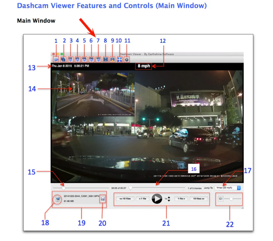

See the Dashcam Viewer User Manual......#7
I don't seem to have that. Also when I click my edit menu button nothing happens.
Oh, I see. That's too bad, I guess the Windows version hasn't implemented that feature yet. The Manual is under the "help" menu. I'm curious to see what the Windows Dashcam Viewer user's manual says about what features are available.
and I had the same issue. Nothing seemed to happen.
Hmm. Here's what I see when I run v1.9.3 on Windows. It takes about 10 seconds for the window to come up (an active internet connection is required or else the window will not come up). I'm not sure why it's not working for some folks.
but I can't figure out how to cut and export clips.
Use the Export to MOV feature, which is the 7th button in the toolbar. This will export a sub-movie from the current position forward to the number of seconds you specify.

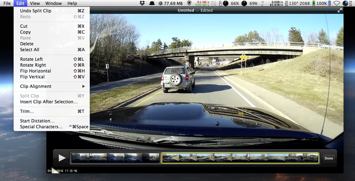

QuickTime Player on the Mac also has some little known but excellent basic editing features such as split, trim, rotate and flip as well as cut, copy and paste. I find the ability to easily copy a cut from another video and paste it into the one I'm working on to be especially useful. You can also export in different resolutions intended for viewing on different devices. It would be great to see similar functionality eventually incorporated into Dashcam Viewer.
How to: https://support.apple.com/en-ca/HT201066
