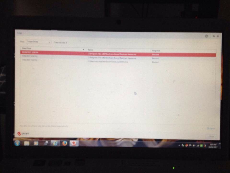

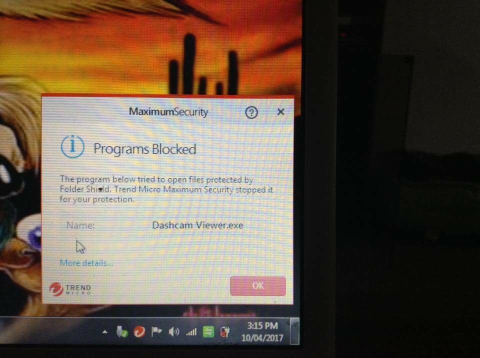

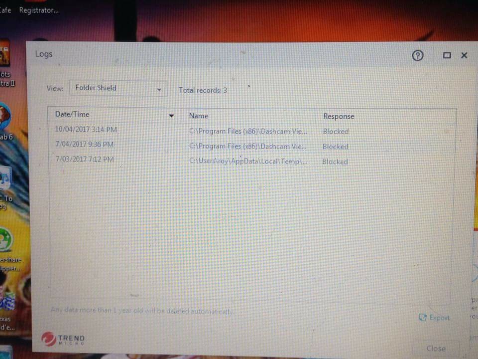

Have a user reported that his AV is blocking it, he's going to send us a screenshot of the message, will forward it to you when I get it
