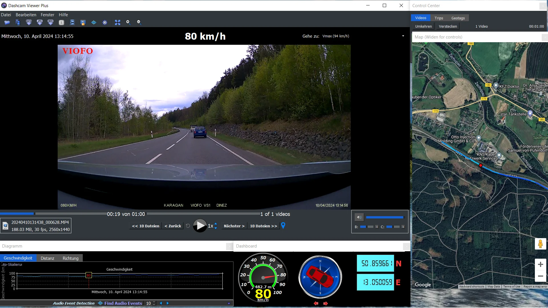

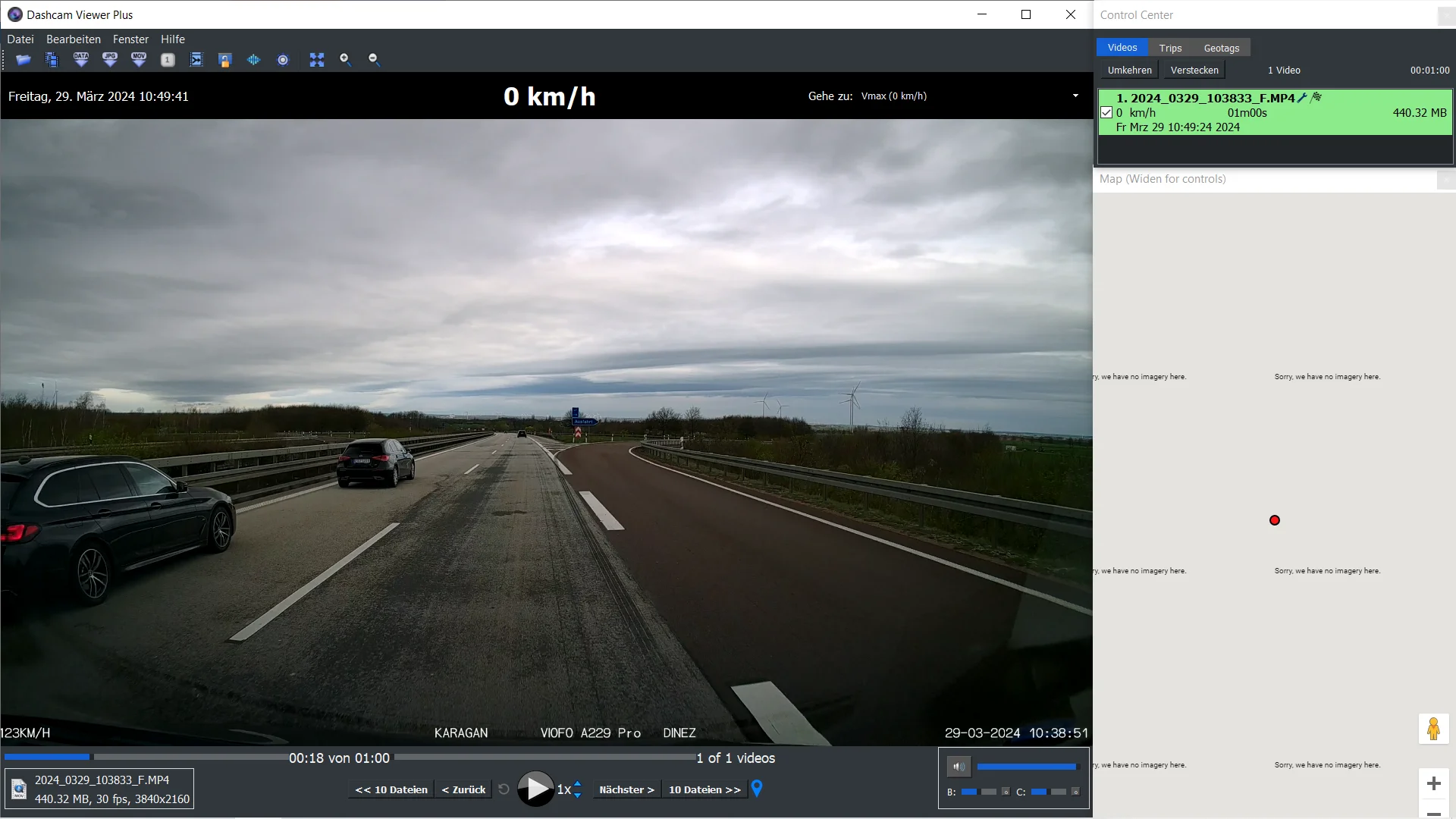

If I try to play a video shot on firmware V1.0_231009, then Dashcam Viewer closes before starting to play the video.
If I open a video shot on firmware V1.0_231123, then Dashcam Viewer plays it without speed and coordinates.
If I open a video shot on firmware V1.1_240103, then Dashcam Viewer plays it back showing the speed and coordinates.

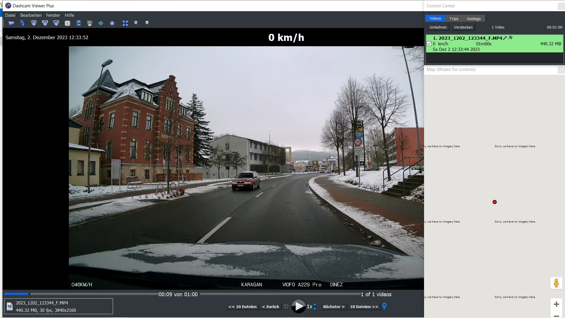

Video shot on firmware V1.2_240227 Dashcam Viewer plays back without speed and coordinates.
Video from Mini 2 shot on firmware V1.0_231116 in the same place Dashcam Viewer plays back with speed and coordinates.

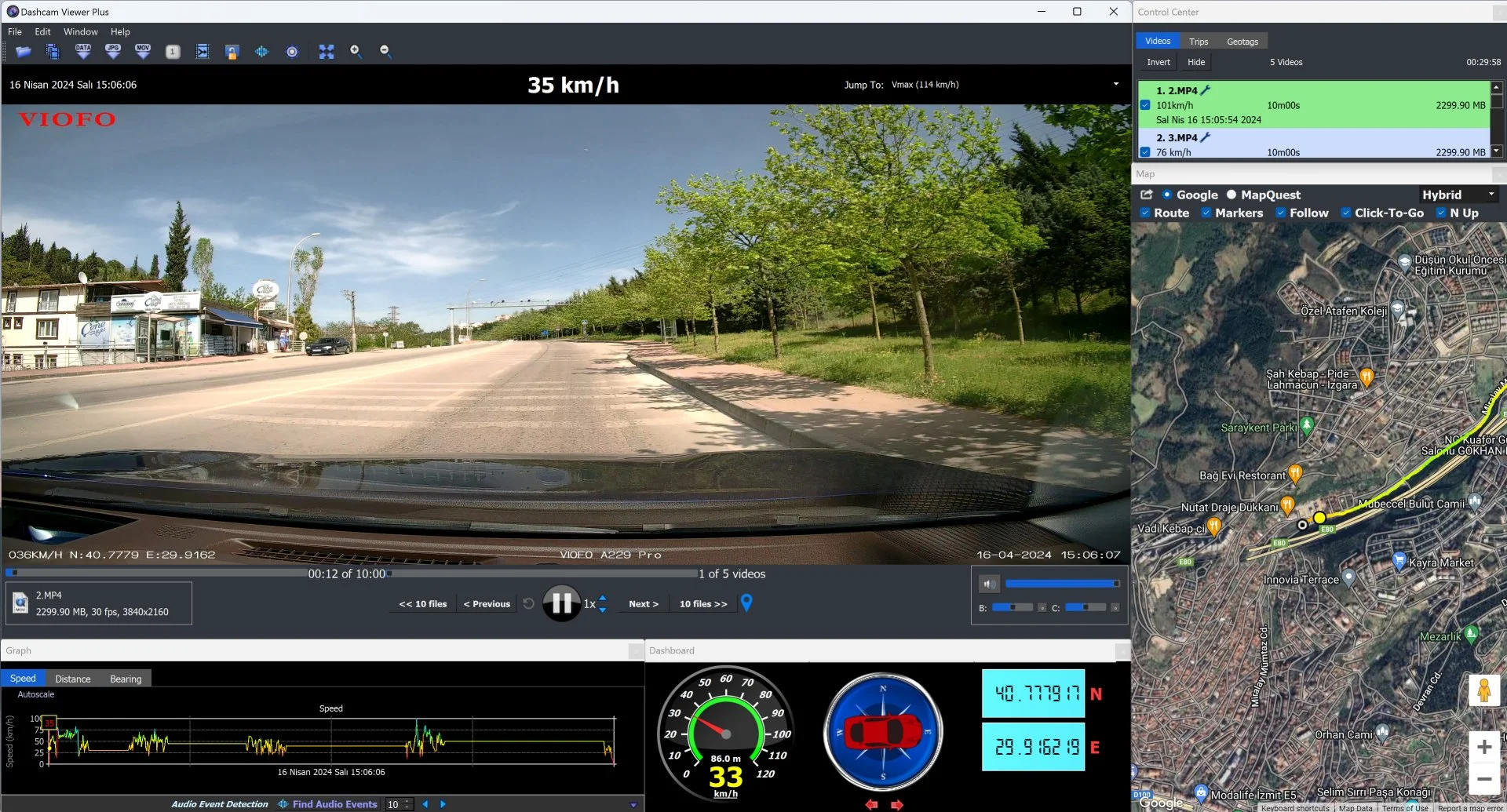

I solved the problem of Dashcam Viewer Plus not being able to process GPS information in 10-minute videos with the following method.
First of all, I extracted the GPS data in the 10-minute video with the command line below.
Exiftool installed
I opened cmd.
"D:\Exiftool\A\exiftool.exe" -p "D:\Exiftool\A\gpx-fmt.txt" -ee "D:\Exiftool\A\1.MP4">"D:\Exiftool\A \1.gpx"
I copied it to a directory so that the video name and GPS name are the same.
I opened DATAKAM PLAYER and selected the relevant video file. Datakam player processed gps data.
I clicked on Datakam Player's "Export Track" menu. From the incoming menu
"GS600, Q3 (.dat)"
I chose .
I saved this file with the dat extension in the same directory, with the same name as the video name.
I opened dashcam viewer plus and selected the video file. Both the GPS information and the map of the 10-minute video worked.

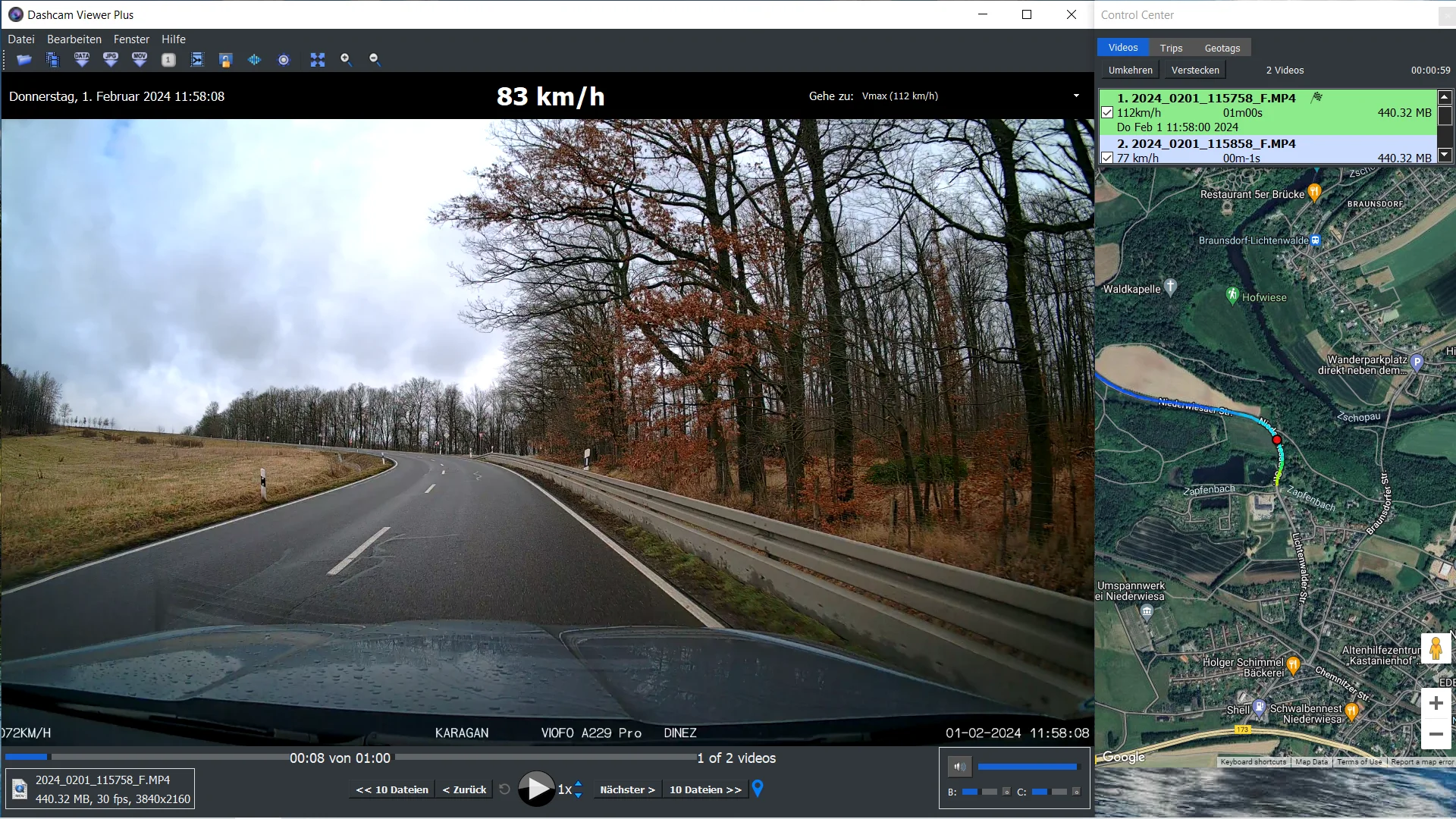

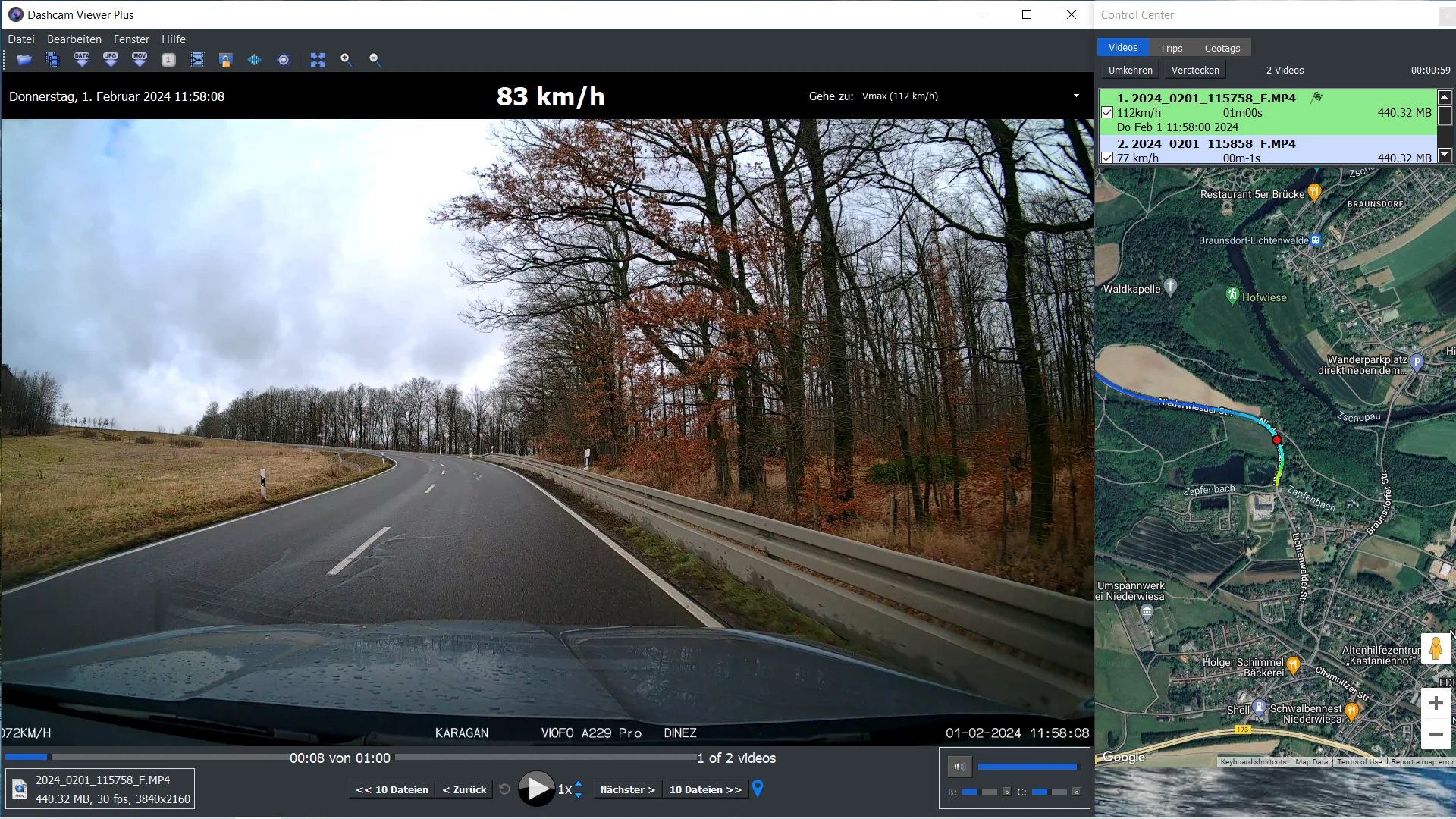

@Karagandinez thank you for the A229 (f/w V1.2_240227) front camera sample videos. I loaded these into Dashcam Viewer 3.9.7 and the GPS data was recognized. See screenshot below.
If you're still having trouble viewing the GPS data, please try the following:.
  1. Try clearing the cache (under Advanced Preferences). Then reload your videos.
  2. Try a hard reset as described here.
John

But why when I upload a video shot on firmware: V1.1_240103 Dashcam Viewer 3.9.7 works without problems?
I didn’t do anything with Dashcam Viewer 3.9.7... I didn’t clear the cache or reset it.
I'll try to do this later.

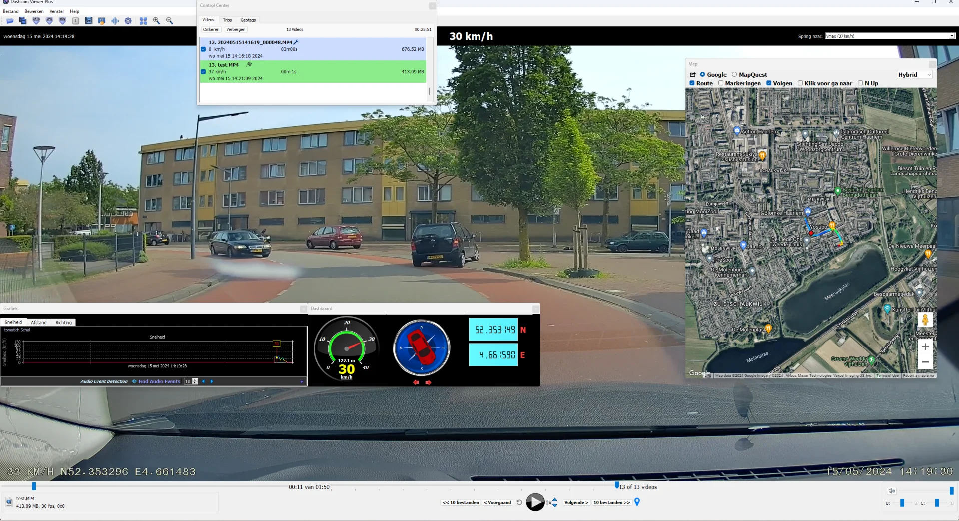

FYI: Just tested my footage from A119V3 under 3.9.7 and the map is fine

It's a bit hit and miss, the data is in the files but most of the times the map reports "Sorry we have no imagery here" if I then zoom out the map shows the red dot in the Gulf of Guinea (right under Ghana). Believe me I'm still in the Netherlands as far as I know.
Edit: I found the problem I think. It seems that the filenames are giving the problems, the filenames were e.g.: 20240515141018_000046.MP4, thus YYYYMMDDHHMMSS_######.MP4.
I renamed al files in Totalcommander as 01.mp4, 02.mp4 etc. Now ALL files will show the data in Dashcam Viewer.
So my suggestions is the the long filenames are giving the problems (?)
