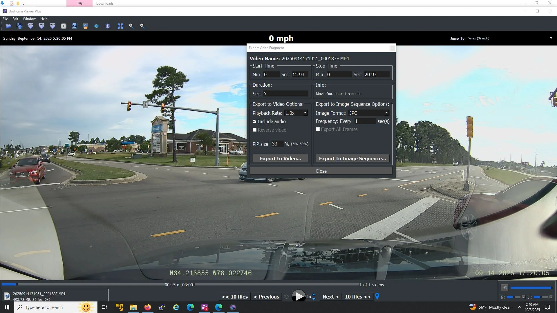

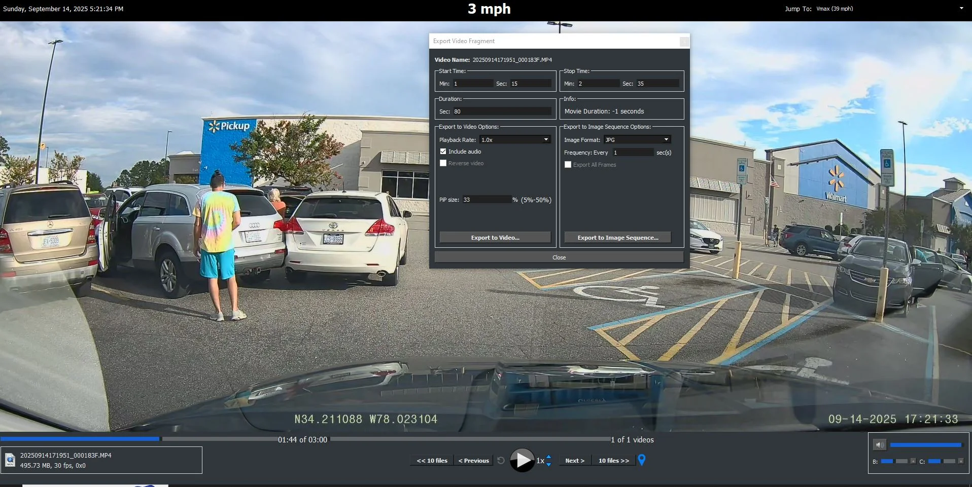

I've learned that Dashcam Viewer really does not play nice with Viofo A129 Plus Duo. I posted a prior question here about Dashcam Viewer not correlating the front and rear cameras. Today's issue is the result of my camera capturing an accident in a Walmart lot where a driver backing the the wrong way down a parking lot row backed into another car. I showed the cop the clip from the dashcam, I wanted to send the relevent section from the file. Smaller and not a bunch of time lading up to the incident. The file plays fine, but when I try to export, and enter the start and stop time DV says "Movie Duration: -1 seconds". I purchased a license to do some of the cool stuff this is supposed to do. Have yet to do anything useful with DV.
BTW, a backup for those running into issues like these is OBS. At least I can get a section of the files without fighting bugs.
Hi BobW: Hard to diagnose the issue with just a single image, but one possibility is that you have a non-ascii character in the path to your videos. The reason is DCV relies on a helper program called ffmpeg.exe, which needs ascii-only characters in video file paths. I can see that ffmpeg is having trouble finding your video because normally the video resolution would be reported in the bottom left, instead of "0x0". The duration of -1 seconds is also a giveaway (I cover this in the FAQ). Try moving the video to a directory whose path doesn’t include any unicode characters. Usually, drag/dropping the videos directly from the SD card onto Dashcam Viewer works.
This problem occurred using the card directly from the dashcam. Unless it's writing unicode characters to the card - which was formatted in the camera - I don't see that being the issue. The full path for the video when I copied it to my PC after it gave the -1 seconds directly from the card is C:\Users\Bob\Videos The file name is 20250914171951_000183F.MP4 I dropped another copy in the normal windows 10 created downloads folder, and it does the same.

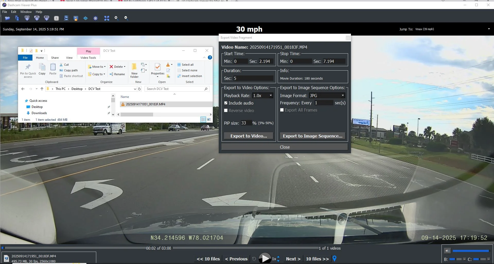

So, some more playing. I changed the name of the file. I deleted the "0" after the underscore. Opened it with DCV. Clicked mov export. then it shows a length. Ok. Figured maybe the camera wrote some invisible un-liked character and editing the name cleared it. Nope. edited the name again and added the "0" back. Once again, -1 length. It's as if DCV doesn't like that file name or length. This was done in Desktop\DCV Test. This might also be the cause of the prior issue that I had which was never resolved where DCV didn't correlate front and back videos. If you've got some way of me getting you the file - I can send a OneDrive link - you can try it directly.

BobW, the filename dependency is an interesting finding and valuable clue. Yes, please send me a OneDrive link to a sample raw video from your dashcam (or use https://wetransfer.com). If you don't have my email address, DM me. I'll see if I can repeat the problem on Windows and Mac versions of DCV.
