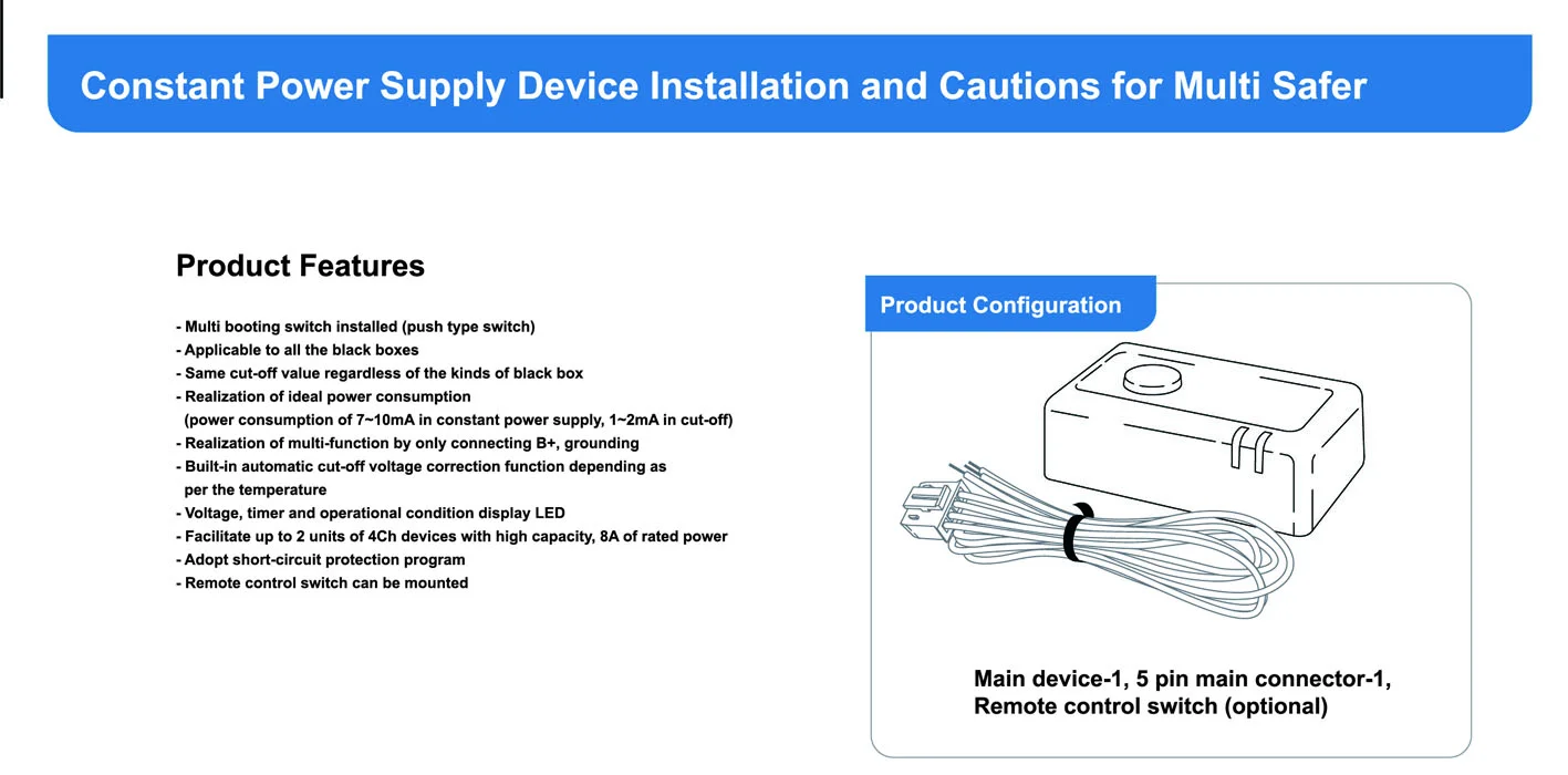

HERE you can download English Manual for MS Multi Safer Constant power supply (battery discharge prevention) device.
January 2016 EDIT:
"Multi Safer" is now labeled "FS "FINE Safer S"
(but it's from the same factory)
Updated (same) instructions:
https://www.dropbox.com/s/e31bzha4d4ytctq/FINESaferS_EN-manual.pdf?dl=0

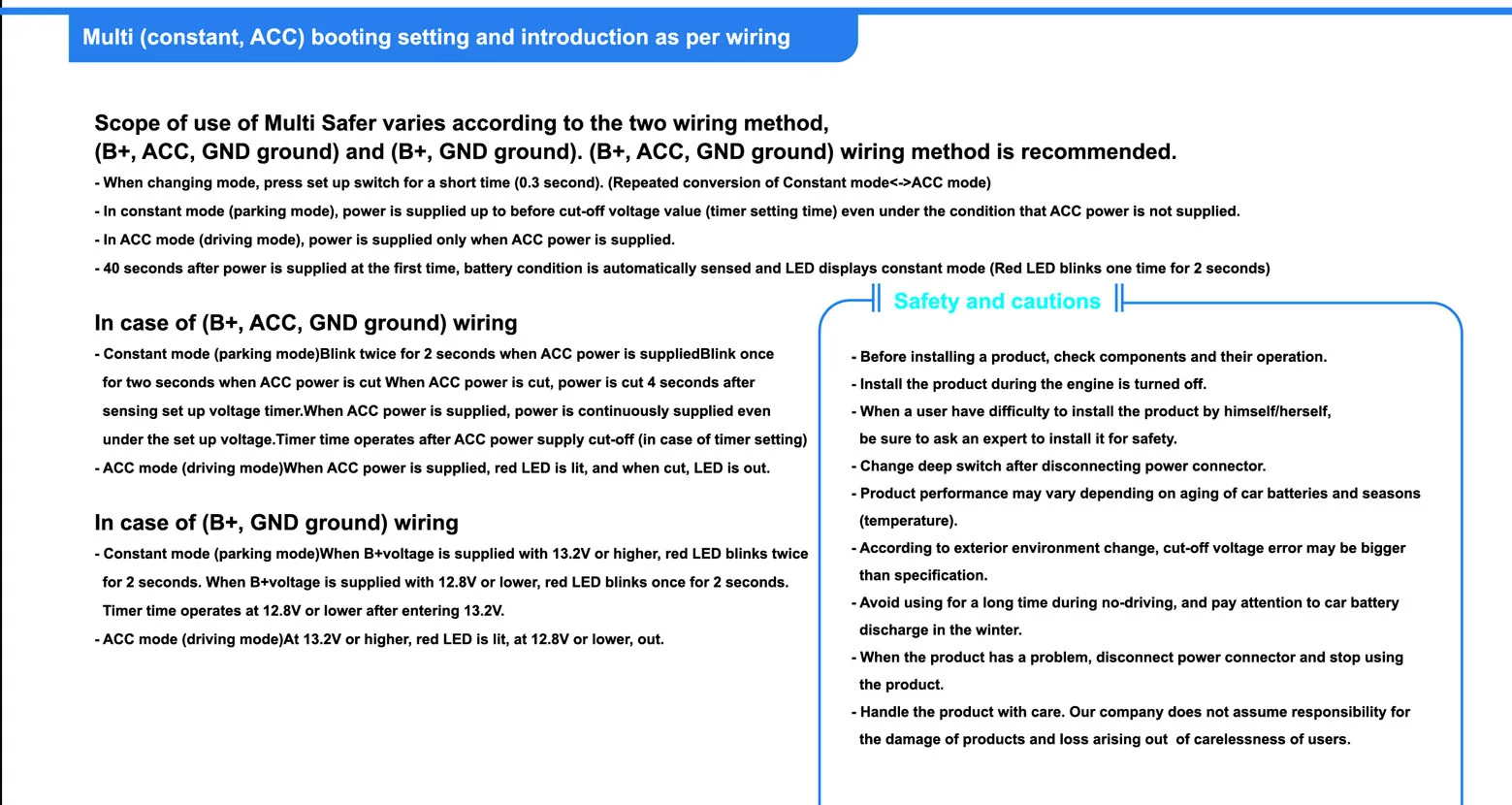

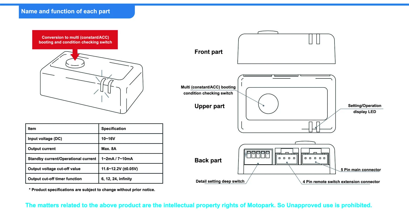

By the way, pressing the button changes from
ACC(switched) LED = red
to
BAT (un-switched/constant) LED = blue
If you switch to acc while the car is turned off, it won't allow you to switch back unless you start the car.

Does anyone know what this means?
I know it's in english
But it seems to me, either :
a. English written by a Korean or
b. Korean translated directly into English.
When what's required is English written by someone with a better understanding of English
Secondly
What does Switch 4 do?

Is it just me or is this information really confusing due to translation?
The timer if not set to infinity is active only when the car is not running right? What information is it that the lights on the unit provide? What does the button do?
Does it use any power when just the camera cable is attached? Is there any reason not to use the highest voltage cutoff?
I think the button toggles between Constant Power and Accessory power. I haven't installed my unit yet, so I can't say how the LED/s behave in each mode.
