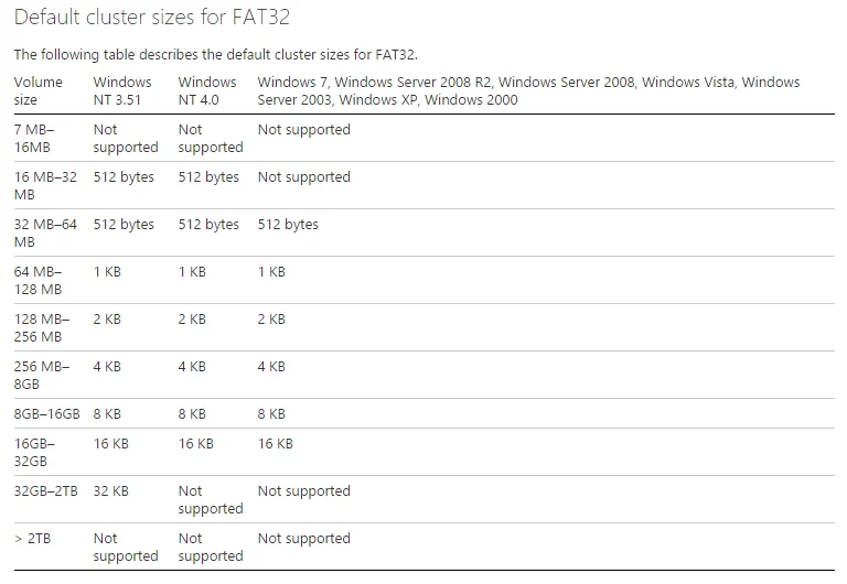

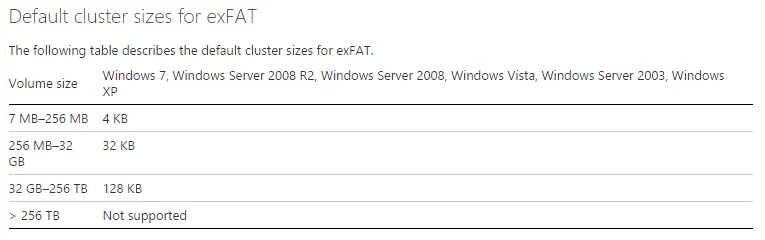

I've got a 64GB sat here which was formatted inside the X2 to exFAT and this is using a 128KB cluster size.
A 64GB formatted to FAT32 using fat32format is using a 32KB cluster size.
From a Windows point of view it maxes out at 32KB on FAT32 for larger than 32GB and that's what the tools like fat32format / guiformat inherit.
Here are the Windows defaults anyway (it officially lists 32GB cards as unsupported in Windows 2000 onwards using FAT32 but uses 32KB like in the first table) - I assume a 128GB card formatted using something like fat32format / guiformat would use 32KB as well so not sure what you see there (I don't have any 128GB cards!)
And the same with another spin:
