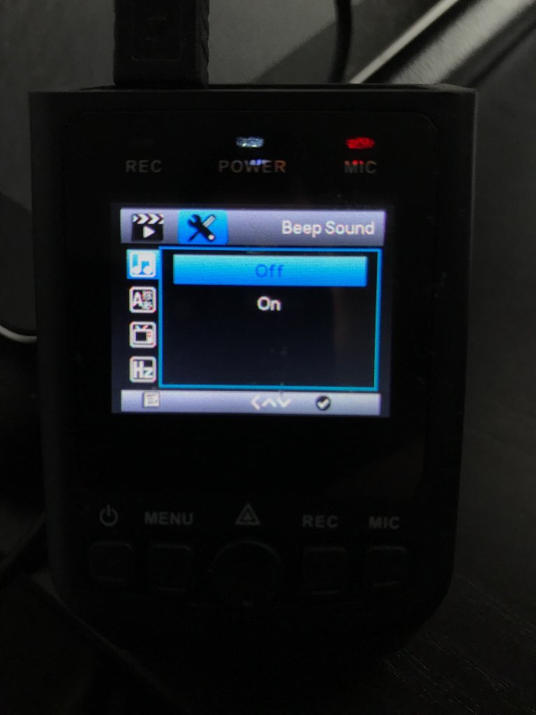

Speaking of silly questions, how do you turn off the start-up sound? I haven't found it in the menu and was thinking about that the other day. I'm going to have to take in my truck for service soon and don't want an audible reminder to the service techs that the dash cam turned on.
Beep Sound includes startup chime.
