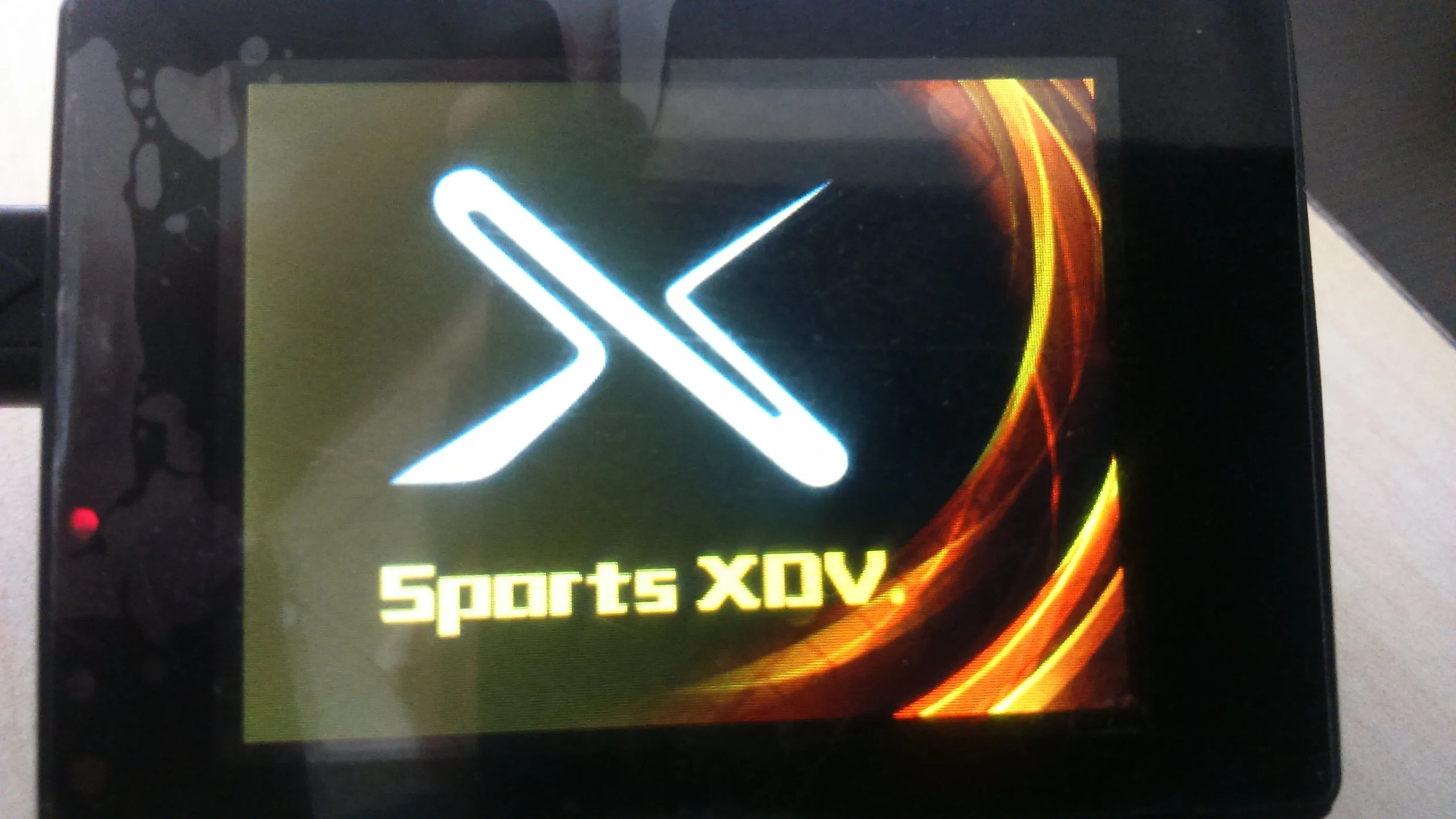

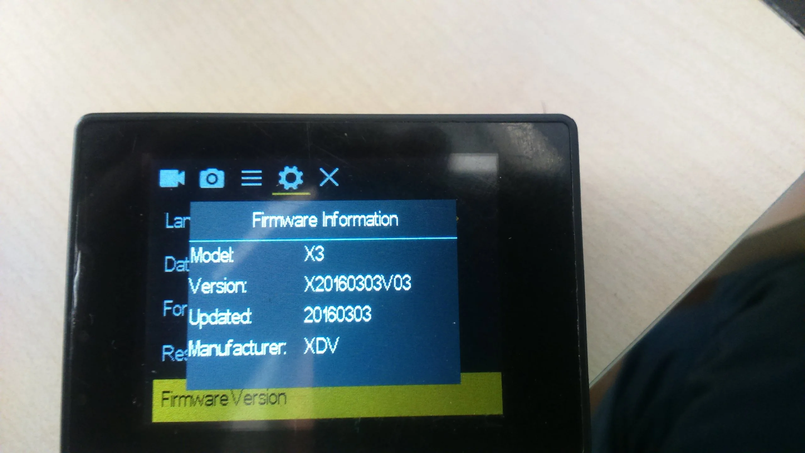

I request to my friend same my camera. we buyed two pieces. how to download rom full image .whats name of the flasher or program
We buyed two same camera in shenzen.if can I download rom to my friends camera and flash my camera

How can I download full rom img
Do you mean from a functioning cam? I'm not sure, but probably with uberizer, another thegamut suggestion, but I'm afraid you will have to wait for someone more expert than me
Inviato dal mio SM-A510F utilizzando Tapatalk
Seems you have to desolder the flash chip to get a full dump from it.
I download eken h9 firmware an other camera and flash my brother eken h9
I use eken firmware bricked tool but ı cant find tool for allwinner
