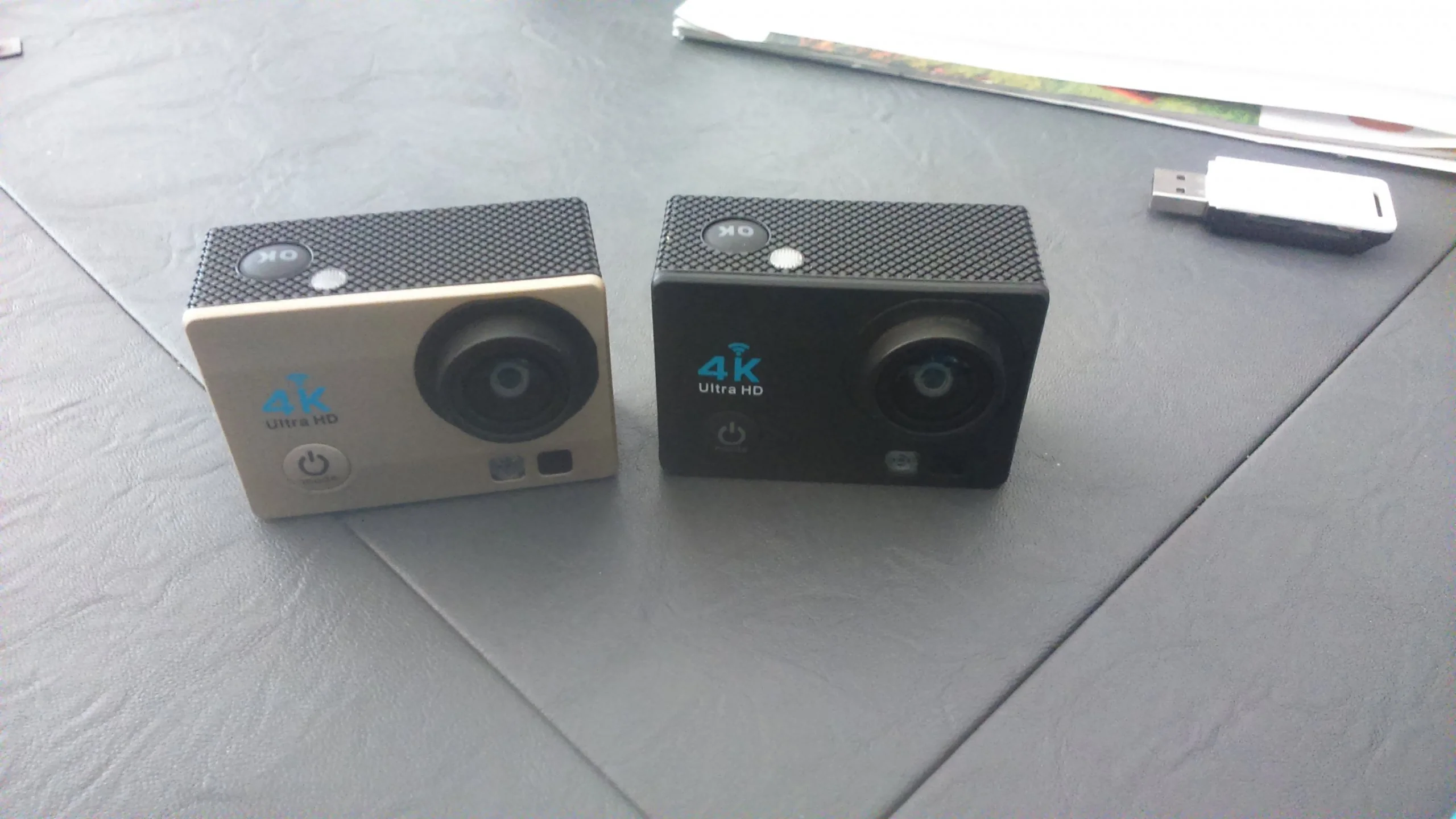

back from a short vacation I just tried to load with phoenixsuit the full_img.fex shared by burak altumbas. The lcd driver now starts OK, but it hangs immediately after due to the wrong sensor (IM 179s vs OV4689) I suppose. Can you please help me to merge the one I got from gearbest, which I assume is for the correct sensor, with this one which has the right lcd driver?

Hi, I've got some interesting news. I tried thegamut file, and it still shows the start screen, and even creates the directory structure before stopping.

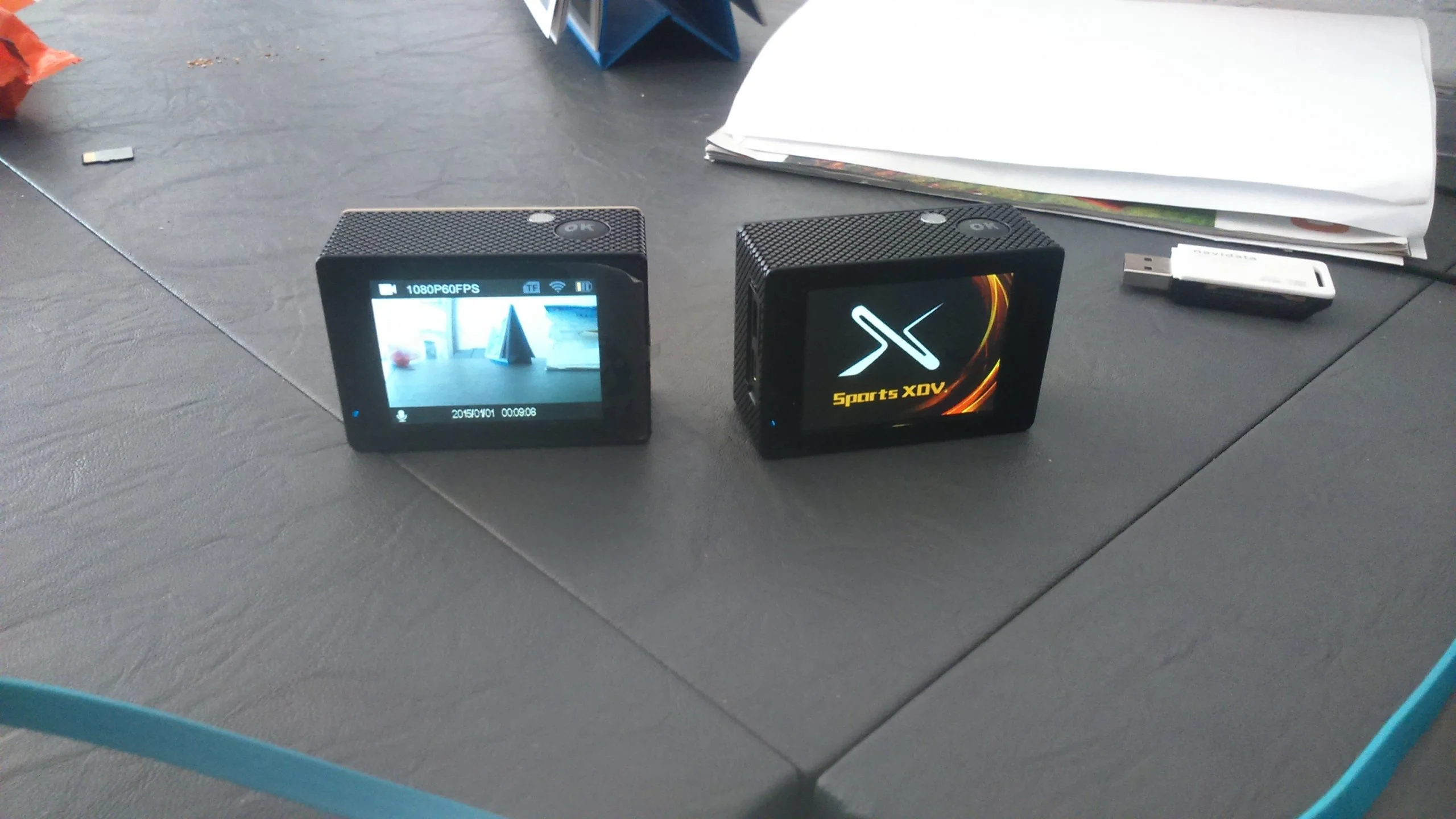

Then I tried lapy file, and almost incredibly it boots OK, it si possible to access it via ADB, but the lcd remains black. I have tried to use it blindly, and it boots and shuts down nicely, the wifi starts and stops, it is even possible to connect to the smartphone app, that crashes when is about to show the image. I tried to connect to PC as a webcam, and even more incredibly it works, even if the image is upside down.
Now I'm leaving again, but think that by comparing script.bin from the two last files maybe I will succeed, thank you all for your invaluable help. This time I will have internet access, I will try also to take with me the software thegamut has shared.
Francesco
That is good news. Its much better to take the screen section since we know that is correct vs the camera section from some random bin.
You know your sensor is IMX179, no S and those images use the same LCD driver with different settings.

Whoaaa YOU ARE THE MAN!
It works (almost) perfectly. Only two things, maybe related.
App still crashes as soon as it should show the live stream from cam, and image is swapped left-right. I still think that the sensor is OV4689 and not IMX179, strange that works with the same driver.
