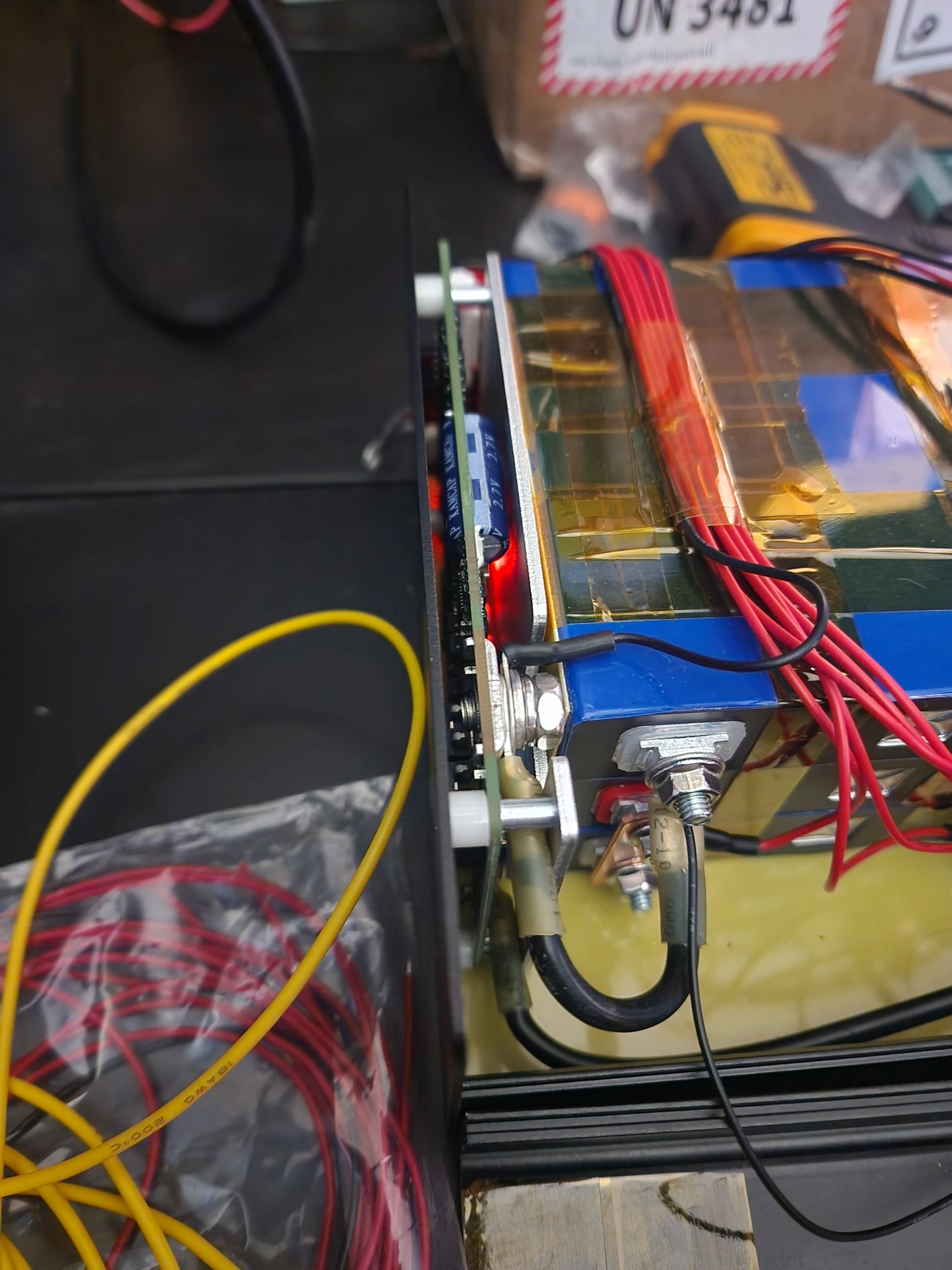

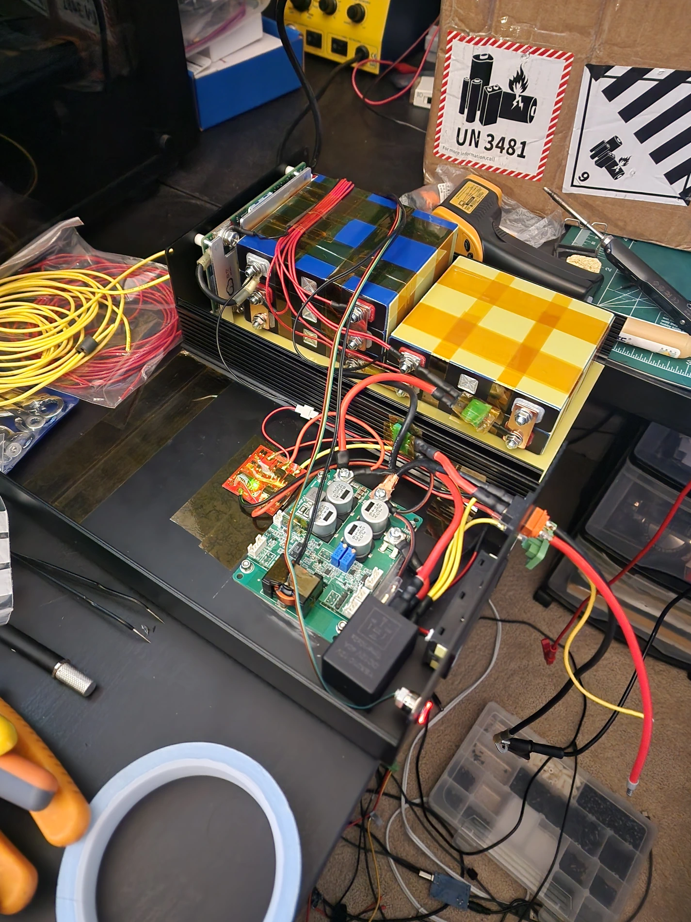

I started my build by copying from @GPak's layout, but I eventually opted to mount both the BMS and the charger module directly to the aluminum case.
For the BMS, I entirely removed the backplate with the mounting ears, and transferred its hole pattern to the case endplate, along with the sticky thermal pad. To replace the metal standoffs that were embedded in the removed backplate, I cut and sanded some plastic standoffs I had lying around to a length of 5mm. The length of these standoffs is critical to ensure an even and adequate pressure between the mosfets on the back of the BMS, the thermal pad, and the case endplate. The BMS was positioned slightly off-center in the horizontal direction to make room for the wires exiting the BMS, and to also leave an open area on the case endplate for potential future expansions.

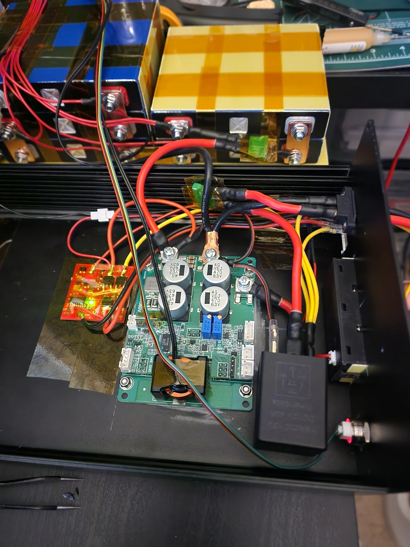

The charger module is mounted upside down on the case's top cover with some thermal paste in between, alongside the UPS module and TDR. I had initially installed the fuses in the recommended inline fuse holders, but found they were taking up too much space and made it hard to run the wires neatly, so I'm now using plain heatshrunk spade terminals as fuse holders. The component and wire layout was carefully decided to ensure the case could be opened like a clamshell (as it is in the photos) without having to disconnect any wires.
With the charger mounted on the case cover, it appears to be able to sink significantly more heat than when its just isolated in the still air of the case. In the following screenshot, T1 is the temp taken from the top of the inductor on the charger module. This is after ~25mins of charging at 23A in an ambient room temp of around 30 degrees. I could probably push the charge current even higher, but I think the 20-23A range should be satisfactory for my purposes, and I don't wish to put additional wear and tear on the battery for minimal gain.

!!! Love the Charger placement and clamp-shell design, I think this is a must for the 20A/240W charging and the best heat dissipation.
I also like the space saving solution on the fuse, I might use it in future builds.

Awesome implementation @wilsch! Being able to open the case and have everything lay flat on the table is a big deal and will help with any future changes. Sinking the charge board to the case s a great way to go to dissipate heat. I found the charge board is hottest and the BMS is next hottest. My batteries are always the coolest component in the chassis.
275w+ charge rate is pretty quick, though you’ll definitely want a direct to battery connection for any charge rate over about 5-6A. I see your BMS has the sleep function that mine is missing. Perhaps some future version of the software will make it work the way we’d like to see it work.

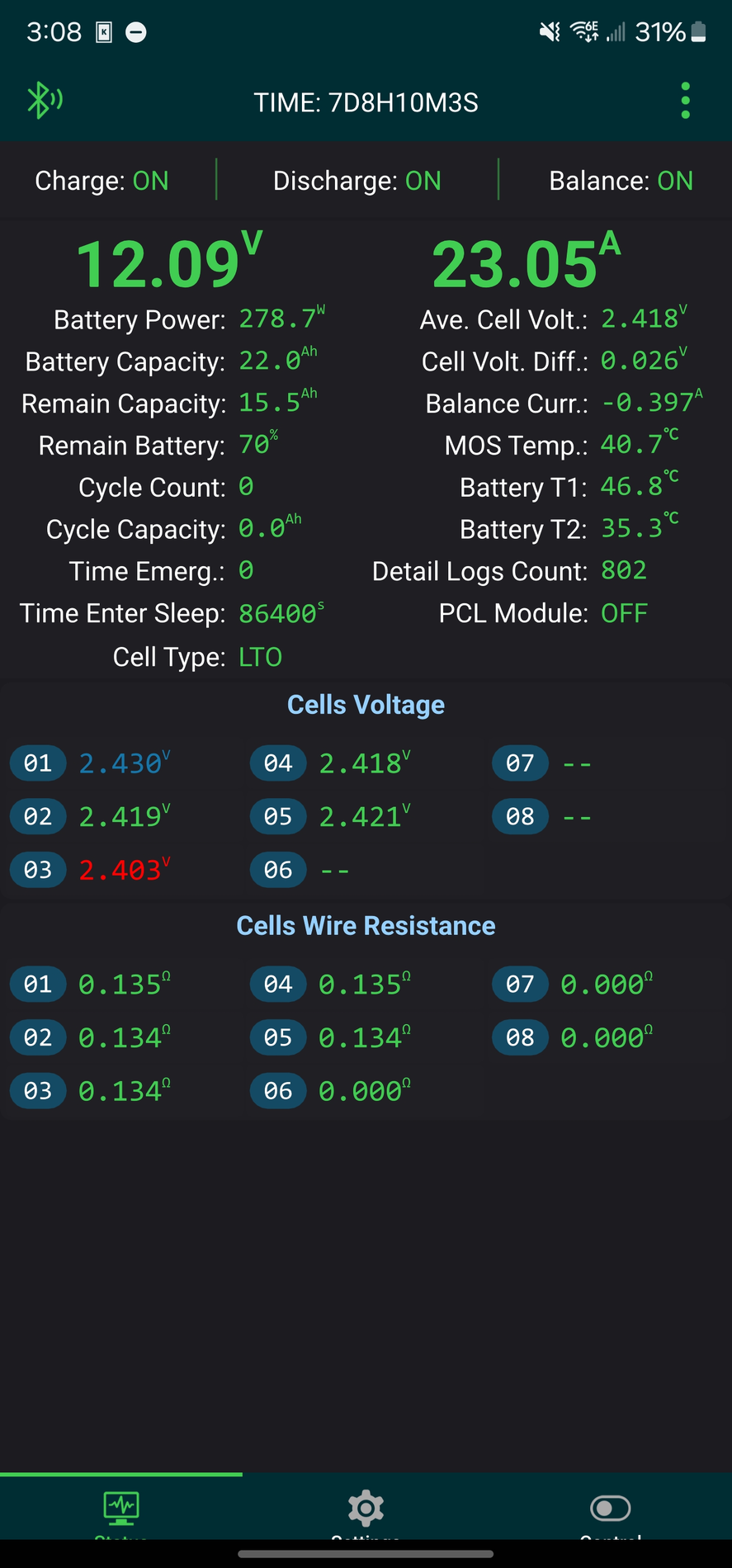

I did notice that the BMS struggles to keep the cells balanced when higher current charge and discharge cycles are done in sequence. But in the dashcam application we are cycling between high current charge and a much lower current discharge so at least the balancing can happen in the discharge phase.
Right now I am testing the charging with a 32V/10A adjustable bench power supply. I set the power supply limits to maximum (32V/10A), so the charger board is converting ~32V@/8-10A to ~10-13V@23A. Obviously, this doesn't match the conditions of charging from a car alternator's 13-14V, so the charger efficiency and temp rise I'm seeing right now are not fully representative. I assume that when the charger's Vin is closer to its Vout, the efficiency will be better?

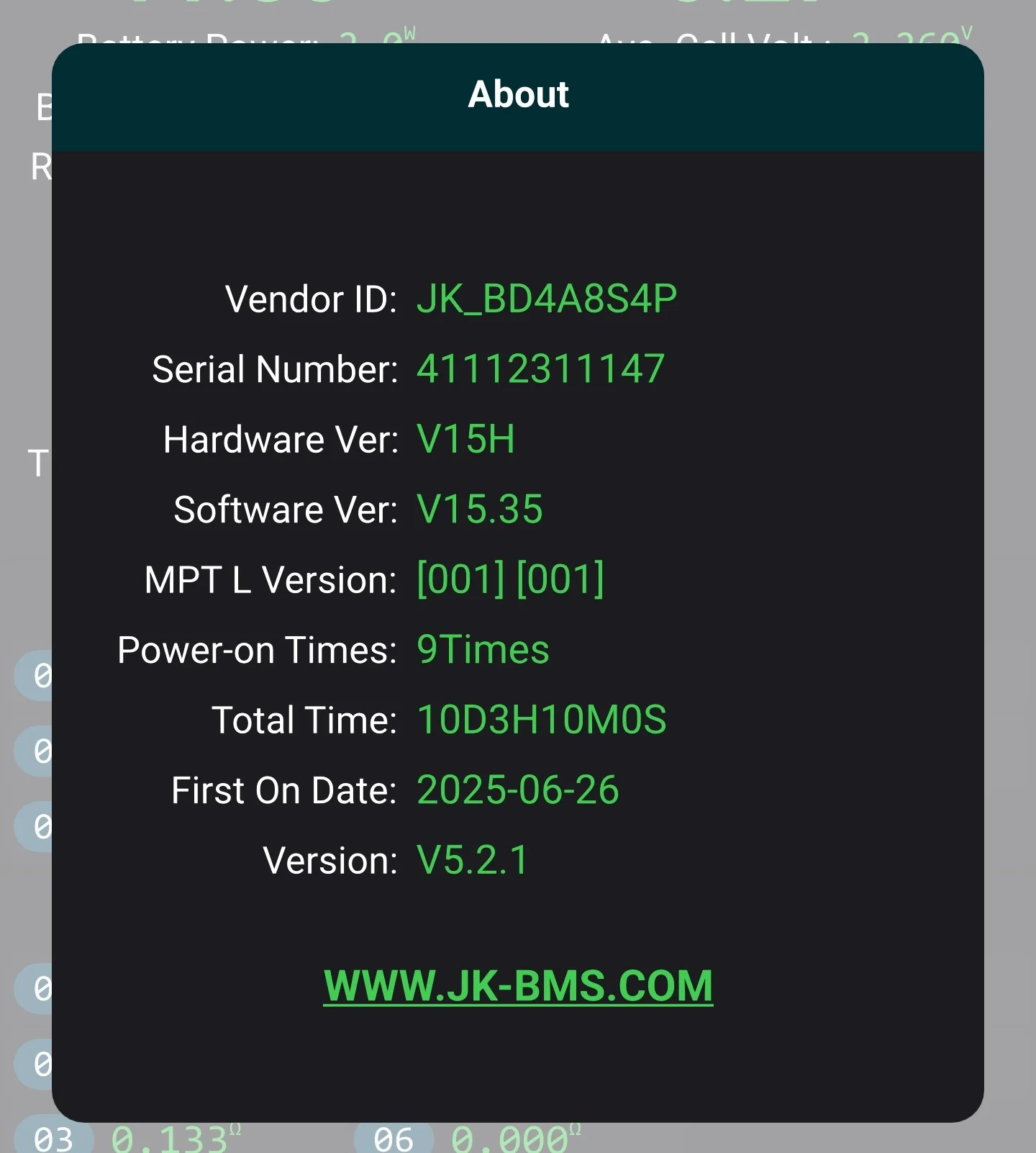

It looks like the hardware and software versions have progressed quite a bit since I purchased my BMS last summer. Mine doesn't have the "smart sleep" function that @GPak does. Perhaps yours will function in a manner that better fits our use case.
I haven't done much measurement of efficiency ratings at different voltage levels, but the published data I've seen all shows 96-98% efficiency. At lower wattage levels, the charger board will be cooler for sure.
... Here is my BMS/app info for reference:

My BMS info is attached:
Also yesterday I received a notification on my iPhone about an update to version 5.2.3, although I haven't updated yet.
Updated the BMS to the latest version V5.2.3, the update description is "- Optimize display", did not notice any difference.
