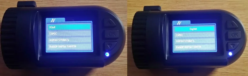

To change the language to English I leave images of the process:
