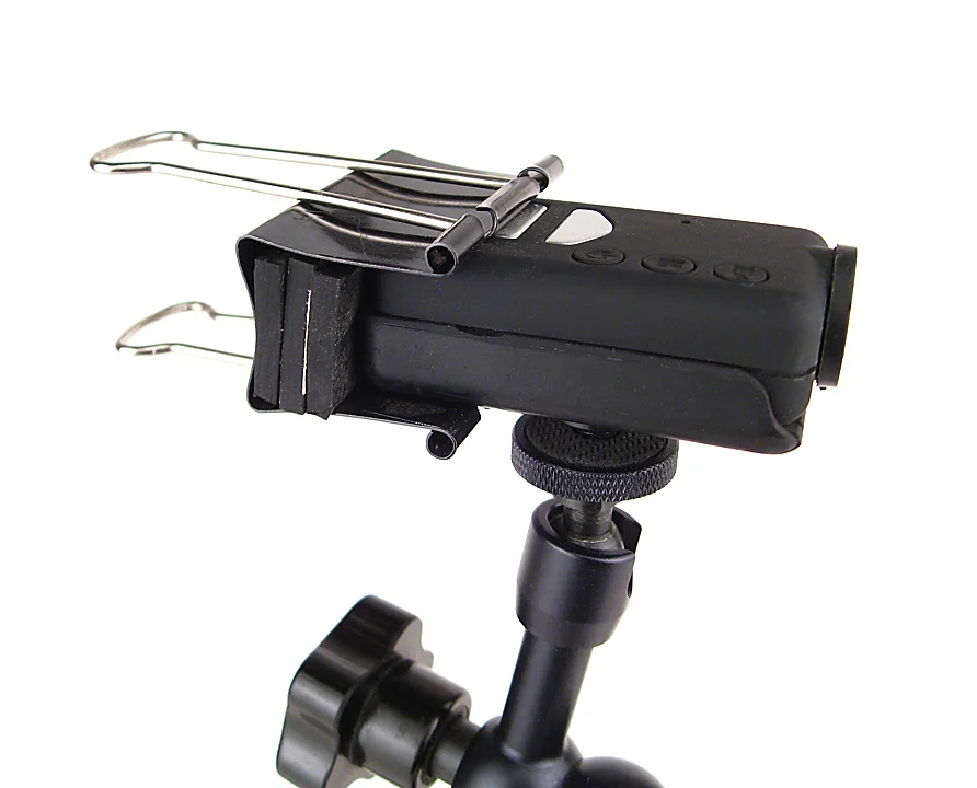

I can certainly understand why Bob would want to make sure his Mobius and/or card doesn't go flying off again in the event of another car accident but I've been scratching my head and thinking there must be another way to do this that is easier and faster to deploy and that would solve both the problem of securing the camera in the mounting cradle as well as securing the card in the camera in the event of an impact. Going through my desk this afternoon the answer presented itself. A larger metal binder clip! Basically, all I needed to add to the clip was a "pad" of thick butyl rubber gasket material of the kind that is available at any good plumbing supply house or hardware store. I used three layers of rubber to keep the front heat sink open but one could use just one layer as long as the clip has enough room to stay clear of the tripod mount on the bottom of the cradle when the binder clip is installed all the way forward. Although for the purpose of this photo, I haven't yet done it yet, the final thing that would be required is to drill a hole through the back of the binder clip (and the rubber gasket material) to allow for the connection of the miniUSB plug. I suppose another hole might be drilled to make the rear red pilot light LED visible as well. Of course, this idea could be a challenge because of Bob's large heat sink but I believe this could be worked around. In fact, the metal binder clip seems to act as an enhancement to the built-in heat sink all by itself but this would need some experimentation to see just how well it works. It does get somewhat hot though, so it's acting as a heat sink. Another option might be to attach an extra heat sink of some kind to the clip itself with some thermal compound. Anyway, this is merely a "proof of concept" at this point just to see what the possibilities might be but it adds a lot of of security for the camera in the cradle, won't let the card pop out and can be deployed and removed very quickly.
I like the extra capability it could give to the heat sink but I also love the security of seeing that flashing red light showing it is recording and that my fat fingers pushed the right button.
Also you would have to put a hole in the other side of the rear of the clip to allow the USB power connection.
There must be a simpler way!
Although I still have a firm enough connection to my mounting cradle and can't wait for it to wear in an loosen up a bit. Annoying having to get it out while it is still so firm. (Pun not intended)
If you had taken the time to actually read my post before commenting you would have seen that I addressed both of the questions you raised in detail. Drilling some holes isn't really a big deal nor is making the red LED visible.

You are right drilling some holes is no big deal but I still think seeing the LED flashing through the thickness of the rubber gasket material may be difficult. More importantly is the clip going to be enough extra support in a major collision? I would say NO.

So, it's my fault you didn't read the post thoroughly. That's a good one my friend! It sounds from your comments like you still haven't adsorbed and don't quite get everything I said. You apparently don't know what a "light pipe" is.
Nonetheless, sorry you don't like the concept. Maybe go with that reusable Velcro strap idea of yours. For what it's worth no matter how much force I use to try to pull the Mobius out of the binder clip and mounting cradle it will not budge a single millimeter.

...and no I didn't know what a "Light Pipe" was. Thanks for informing me. Although it seems an overkill. IMO

So it is bad logic to keep things simple is it? Guess your paper clip enters that realm then!
