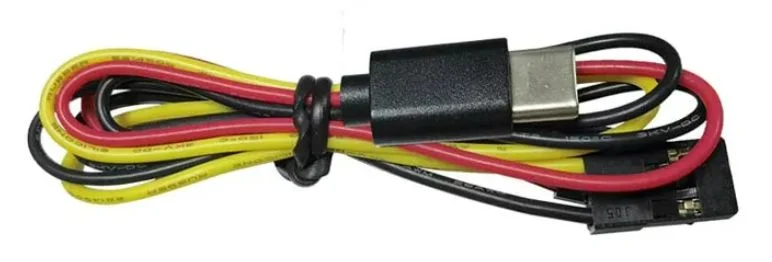

I'm looking for way of providing power only to camera (to use power-on function), based on light double wire cable not heavy USB cable.
How to connect this plug to camera?
I see yellow and red. One is data one is power? Both are power for opposite sides of USB-C pin? Which is which?
