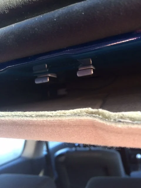

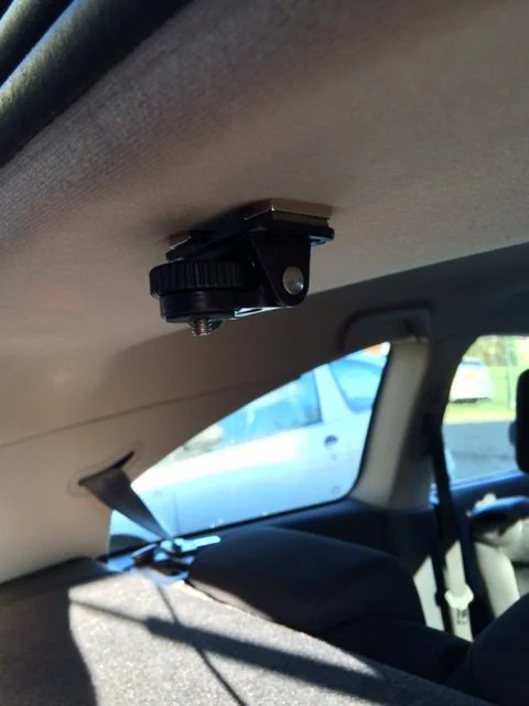

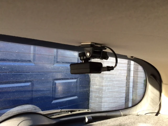

I'm using a Mobius C2 as a rear camera. I got 4 neodymium block magnets and attached a pair to the roof of the car (behind the headliner) so the other pair would magnetically stick to the headliner.
I had previously attached some 3M VHB to the other sides of the magnets and made sure the spacing was such that the base plate of the helmet mount could be attached.
I routed the flat USB cable behind the headliner and installed the Mobius.

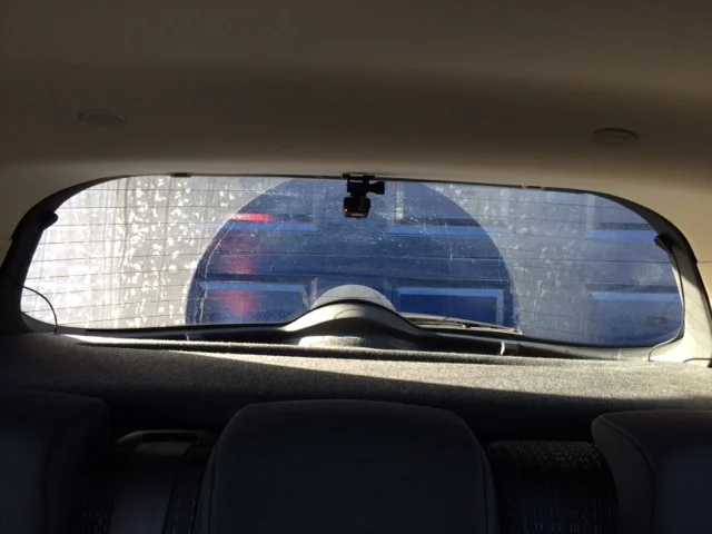

I used 3M tape to attach Mobius to the headliner of two cars ...
The fabric varies in quality from one car to another. To remove the tape without damaging the fabric, use a hairdryer to soften the adhesive, slide an old credit card under the edge & slowly peel the tape off.

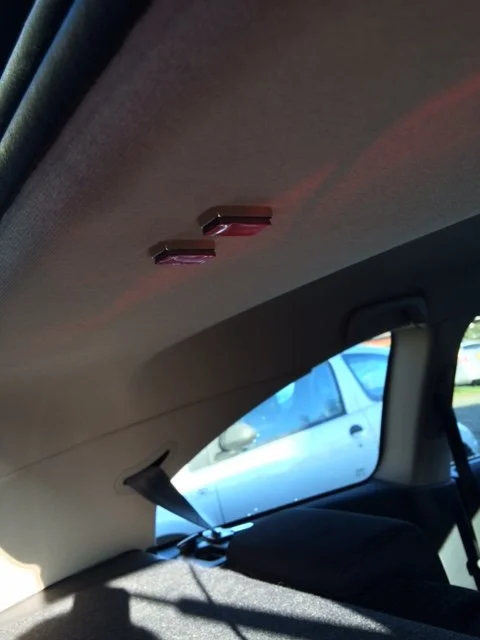

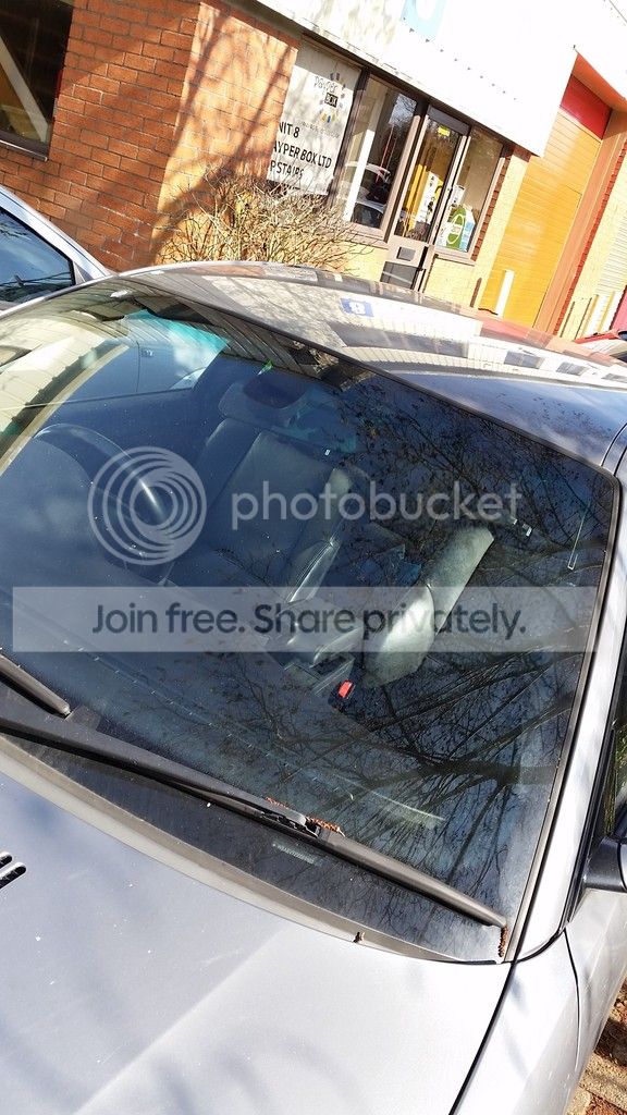

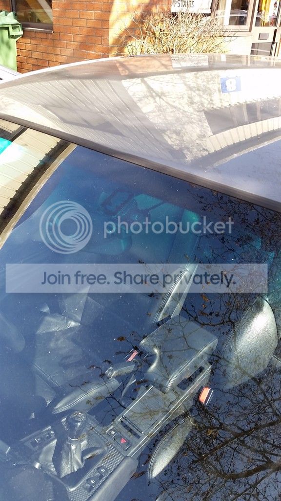

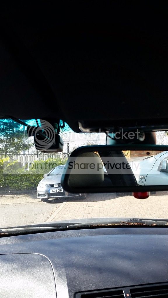

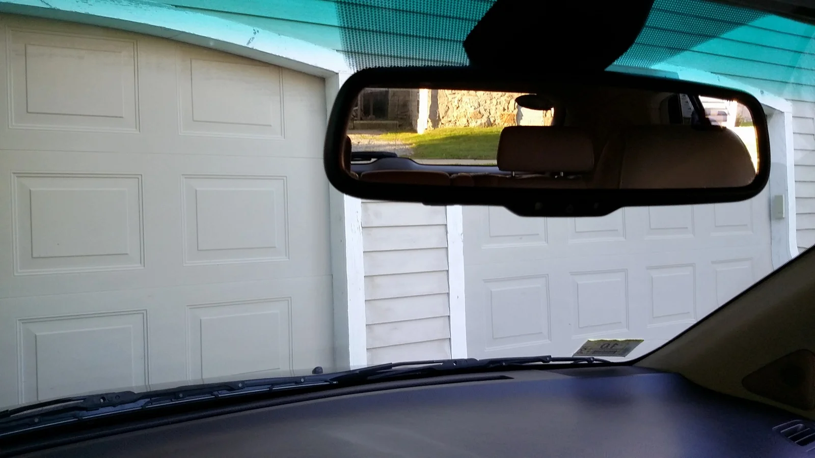

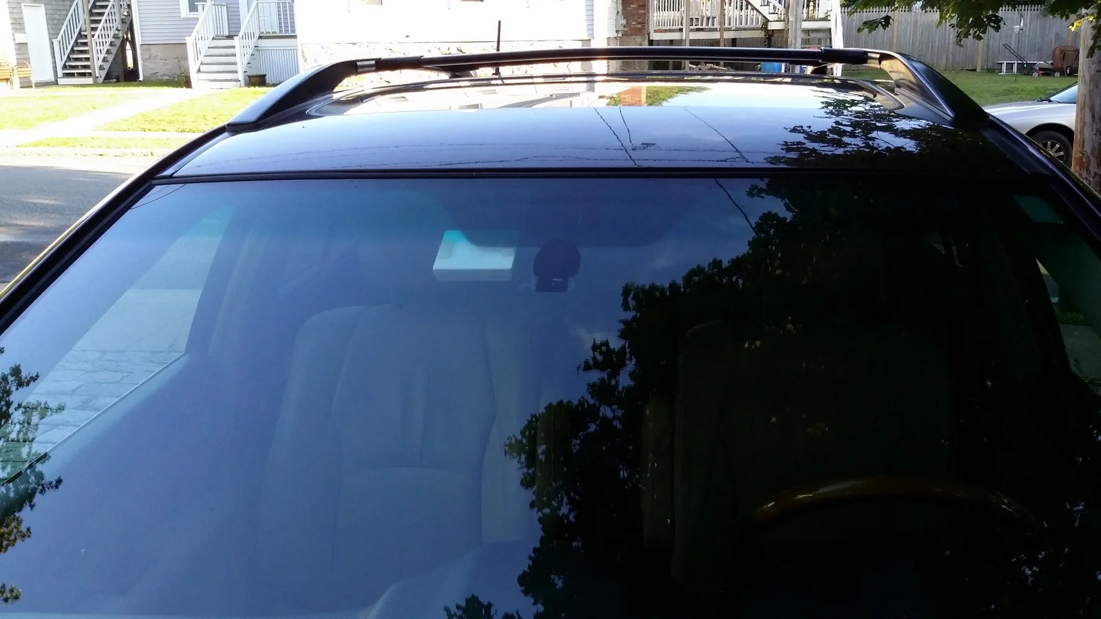

When the Mobius arrived, I was surprised at how small and light it was. I guess I expected it to be at least a little bigger. For this reason (and because I had a bunch laying around) I decided to use Command Dual Lock strips. I'm not sure that I'd necessarily recommend this exact setup, but I'm hoping that it works for me. It seems like it will hold fine considering its hardly any weight and the strips should peal off without damaging the headliner.
I gave myself a large platform on the headliner and only two small points actually on the camera. I did this so that it holds well but I can move it easily if the angle is bad.
Here are some pictures of the setup. It's almost pointless to include the shots from the outside, since the reflection off the glass is so bad that it makes it impossible to see anything inside the car (sorry for that). I will say that it's almost completely unnoticeable if you're not looking for it, due to only a tiny bit being visible at a normal standing viewing angle.
Here's a sample clip of what it sees. It's not the best angle in the world but the low profile form factor of not having to use a mount is exactly what I was going for.
