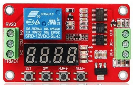

You might be able to use a small 12v DC timer module inside whatever object you choose to hide the camera in but you would need to come up with a suitable power supply. Some members here have used them as DIY dash camera timers, but of course, they run them off their 12V car batteries. In any case, it would be worth exploring this option to see if it might work for you.
These timers are widely available on eBay and elsewhere. See THIS link for eBay examples. (US)
If you intend to go down the external power pack route you will probably need a 20,000 mAH to power it for 18 hours, I don't think 6600 mAH would last long enough. Take a look at the Batteries and Capacitors forum for more info, link is: https://dashcamtalk.com/forum/forums/batteries-and-capacitors.87/
