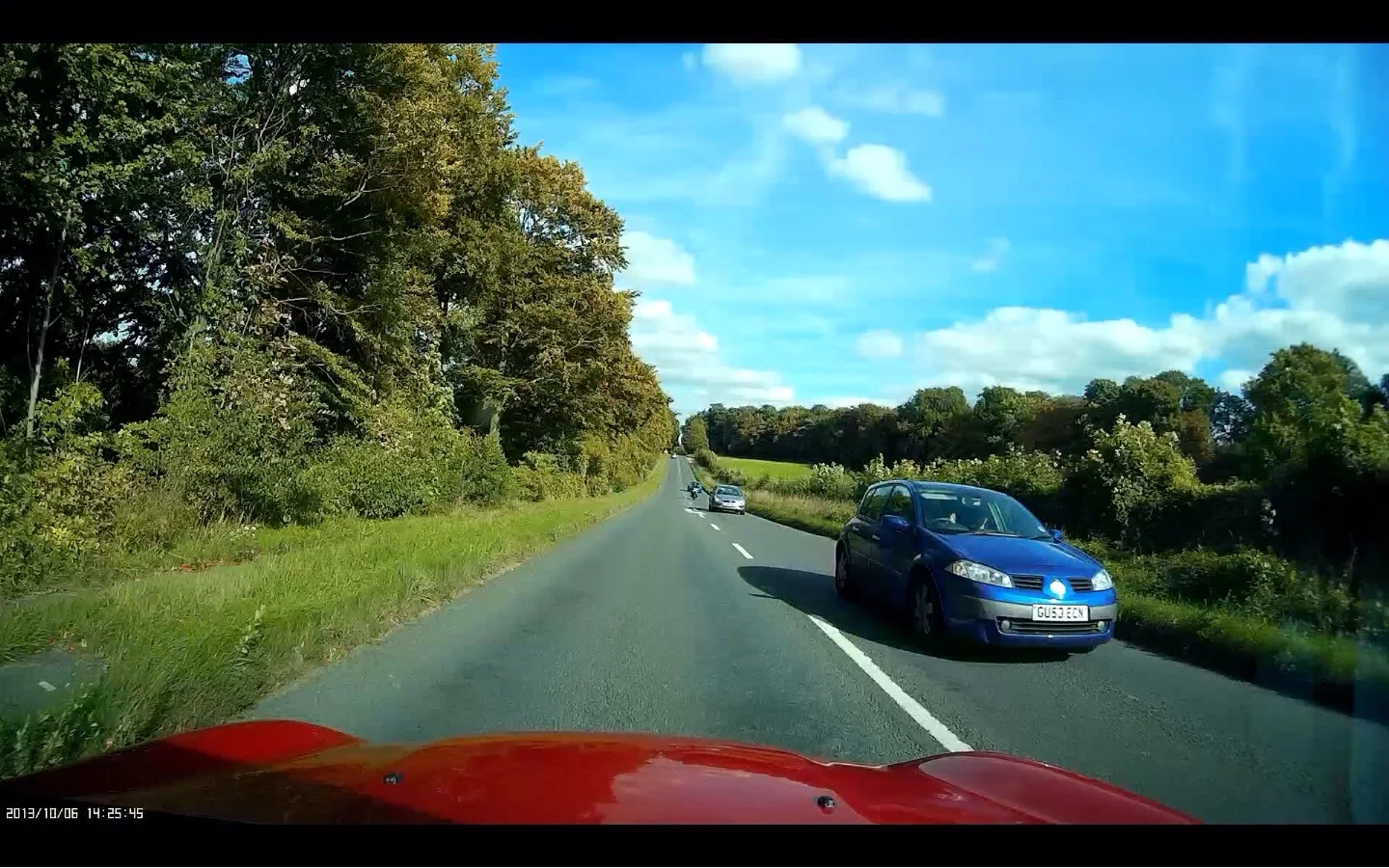

I am not impressed with the video quality of the Mobius either, my Mini 0803 was able to read number plates on passing cars but the Mobius is just a blur.
I am not impressed with the video quality of the Mobius ... just a blur.
Blur? Combined speed 100mph...
To be fair, as with any camera, it depends a lot on the lighting conditions.
Here in the US, where license plates are smaller and sometimes of variable legibility/lettering/numbering size and design in the first place, capturing plates in motion can be quite a challenge.
life would be easier if we all had UK style plates, a lot of ours are even smaller than US plates
It's true that bigger plates are better for dash cam capture and police officers but I guess it depends on which side of the camera you are on! 😀
I'm getting blurred plates with a combined speed of 60mph. In fact i sometimes have blurred plates on parked cars when i am doing 30mph! Are you using the narrow or wide FOV?
Narrow Mode. Mine is a Mobius B. I see you have a C2, which is supposedly superior to B. Might be a good idea if you posted some frame grabs or a brief video clip to illustrate your problem.
Looking at the manual it seems that wide FOV may give better results. I am also wondering if i have focus issues, will do some more testing.
