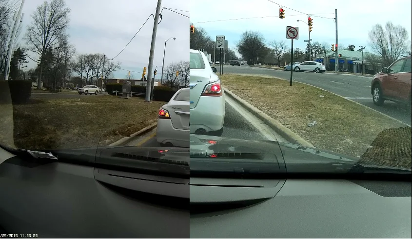

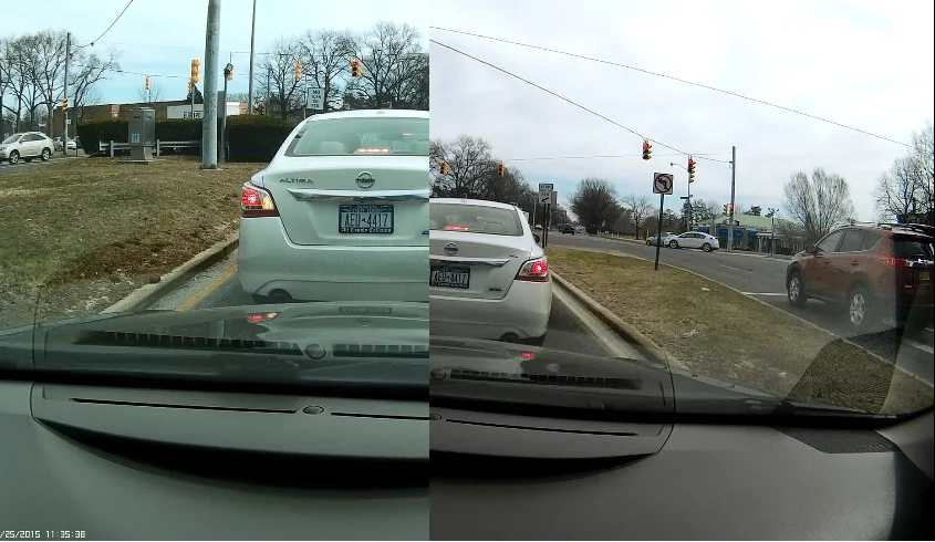

I just reviewed my footage and I'm not seeing any focus shift on my C Lens. Here's my A next to my C, both on Wide.

I'm glad to see these nice sharp images but all these shots are from a gray cloudy day in late Winter/early Spring in the northeastern US. Hopefully, they'll be just as sharp on a bright sunny warm day when summer rolls around.
The rest of that day was sunny and quite warm in the car, I rolled down the window. So after filming all day, there was no effect. I'm guessing since the camera gets warm on its own, there would be very little difference to a warmer outside temperature.

So why post images from the cooler cloudy part of the day? The issue here seems to be that the C lens goes out of focus when it gets hot. Either way, I'm of the opinion that the summer heat will be the real test of this lens even if it seems warm in the car now. Maybe that's because I live in New England where it is basically still Winter here. (Tomorrow night the weather report predicts chance of snow and 12 degree Fahrenheit!) Even in the sunshine in my dark blue solar oven of a vehicle, it's not like the summertime heat inside the cab.

It was posting an A vs C comparison photo from that day. The temps were about the same as @horaceCJ 's example above and @MANswers was filming in cold Chicago so problems from not so Summer temps have been posted. Of course more testing needs to be done.
