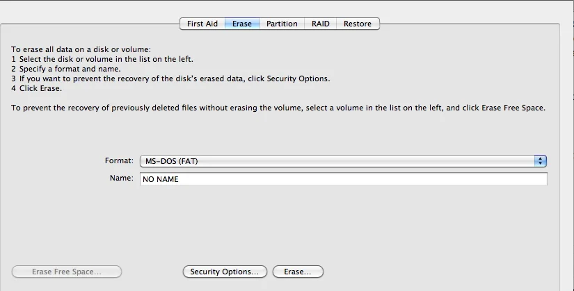

seer7y7, I assume you have formatted the SD card before you inserted it into the Mobius, I tend to format in FAT32 using the Disk Utility app on the Mac, just select the correct drive to erase, as in the SD card you ejected from the Mobius, and format MS-DOS (FAT) and remember to change the name to what it was previously.

I checked, the card is already MS-DOS (FAT32), so am I correct that I don't need to reformat? Thanks.
Probably OK but it only takes a few seconds to format MS-DOS (FAT32) using Disk Utility on the Mac.
