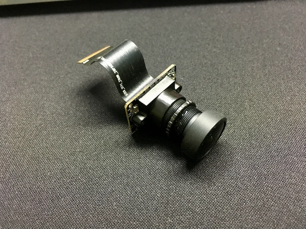

The one in the photo @Harsh posted doesn't look highly unusual so my guess is that one could find something that would work. From what I've seen they are generally available in 18mm, 20mm and 22mm screw spacing. You would know more than me I 'spose.

the screw spacing is different to the Aptina ones and will be available, how much room it takes up on the board will come into it also as it can foul some components if the size is wrong, we had to get lens bases made for ours as we couldn't get anything off the shelf that worked, if you need a longer barrel to suit some of these other lenses that may be a challenge also

Using a ruler, it's 19mm. The generic one I have is 20mm and compared to the one on the A129, it looks huge. Top/bottom on the generic one is 16mm, A129 is 14mm.

I have not yet found a source for just the mount used by Mobius. Most of the ones I see are 20 mm hole spacing instead of 18 mm. I should contact buymobius.com to see if they would sell me just the mount and not the entire lens+mount+sensor assembly.
I found a 10 piece lot of M12 18mm lens holders here. Total price with shipping for 10 mounts is $11.56

M12 Mount Board Lens Holder for CMOS sensors, spacing, metal 18mm for 3.7mm lens
If a given lens assembly is to long you can find many different m12 extension rings here.

That's a good find @country_hick! They may be too shallow in depth to be practical for use in the Mobius cameras though. The lens holders in your link are only 8.2mm in height whereas Mobius lens holders are about 12.5mm in height. (Not sure about other current Mobius lens holders as I haven't measured them but if they are different they are likely to be taller rather than shorter.) Too short a lens barrel may present various problems with MBF, BFL, secure fit within the Mobius camera housing and module slots, as well as general lens stability. So, anyone considering buying these lenses holders should probably do some measuring and testing first.
