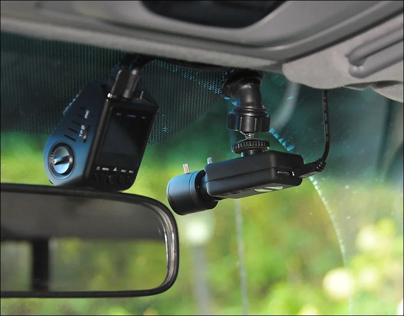

No, mounting hasn't really been a problem at all. I used one of the DIY mounts I made two years ago and it's worked out quite well. I had only one minor issue which was that I couldn't mount the varifocal equipped Mobius as close to my other front facing dash cam as I wanted to because the Mobius needs enough room for the varifocal to clear the other camera when you screw or unscrew it from the ball joint mount without having to change it's adjustment each time.
(This is an older photo. Since then I was able to move the camera a little closed to the GC than you see it here.)

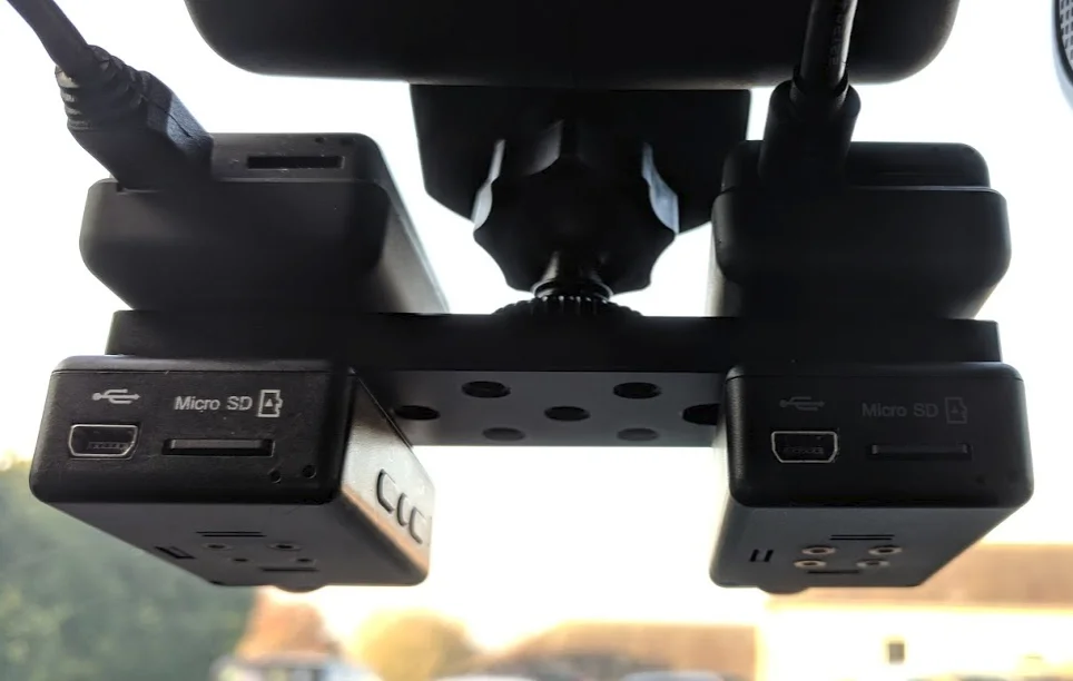

I use that generic Chinese mount for my Mobius testing rig - it is very sturdy even with 5 cameras attached. With a telephoto lens installed, the top side cameras just clear the glass when I spin the whole assembly on/off the mount, so there should be plenty of space for a single camera and a varifocal lens attached to the mount directly.
