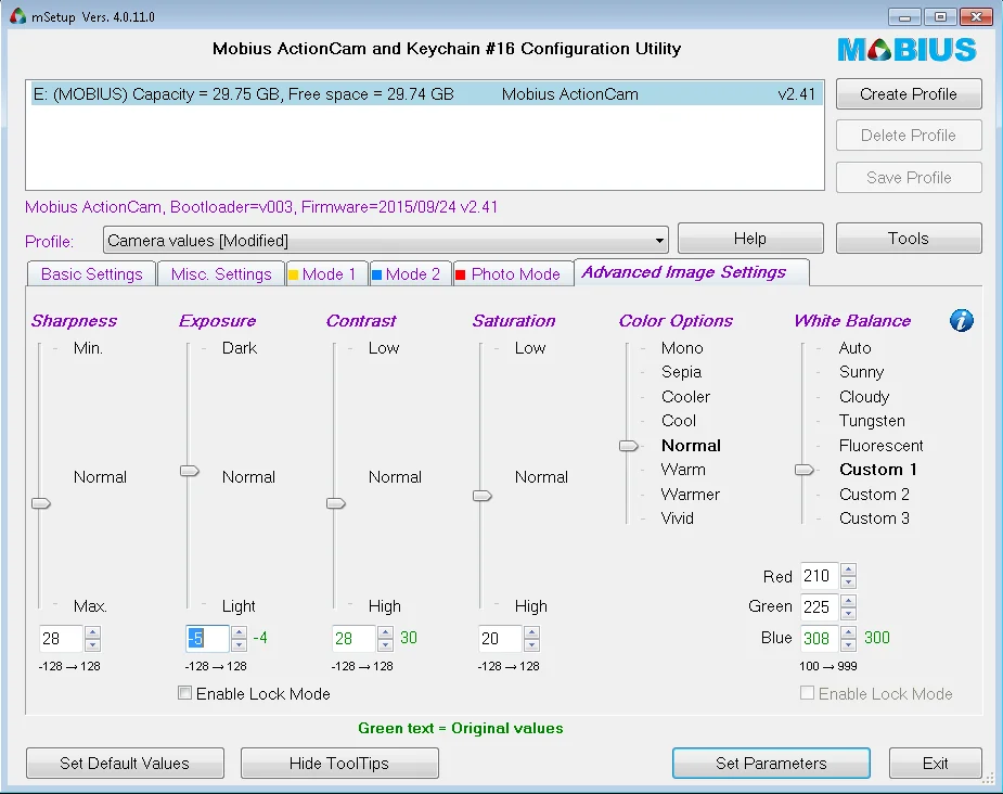

Since the end of November I removed the 2.8mm-12mm varifiocal lens from my Mobius and began experimenting with the 4mm ƒ/1.2 and 6mm ƒ/1.2 lenses that we've been talking about over in the threads about them. HERE & HERE. Perhaps you've been following them.
By mistake, Treeye forgot to install the IR-Cut filters on the lenses I ordered from them (they've since sent me replacements with the IR filters) and so I removed the varifocal and began experiementing with these non-IR corrected lenses on the Mobius. I continued my color correction tinkering and tweaking based on those lenses using my previous adjustments from the varifocal as a starting point. Eventually, I managed to arrive at a fairly accurate color balance without any IR-Cut filter (depending on the lighting-works best under neutral cloudy skies) . You can check out the results HERE.
Anyway, before I left off with the Varifocal 2.8mm-12mm lens and went on to making adjustments with the new 4mm and 6mm lenses I made a screen shot of my last adjustments for the varifocal and attach it below.
Use these settings as a starting off place and see what happens. If you too make screen shots of your settings you can experiment to your hearts content and always be able to go back to where you left off. That's a good way too learn about RGB color correction or any of the other settings available with the Mobius GUI. Of course, you can also save each version as a profile but I prefer to do it this way. Also, note that the Mobius GUI will make a numerical notation of your last individual setting to the right of the new setting. So in the screen shot below you'll see where I've now changed the Exposure from -4 to -5 and I changed the Blue setting from 300 to 308.

I've basically been winging it with the color and exposure adjustments for the 4mm and 6mm lens and haven't kept screen shots or a record. I used the settings I arrived at for the 6mm as a point of reference to make further adjustments for the 4mm after swapping lenses. Giving you those numbers may just confuse the situation if they happen to be way off for your lens.
Each lens has a different inherent color profile regardless of its focal length. The settings you asked for that I used with my 6mm lens would not necessarily be of much help with your fixed 12mm lens.
My recommendation for now would be to use the color settings in my screen shot above as a starting place. That should get you somewhere in the ballpark. Then make additional adjustments based on the results you are getting with your 12mm lens.
Keep in mind that I said "color" settings. The sharpness, exposure, contrast and saturation settings correspond specifically to my 2.8-12mm ƒ/1.2 lens and to my personal preferences. With those settings, start from zero and adjust accordingly based on the apparent and perceived requirements for your 12mm lens. A good technique here would be to make fairly extreme contrast, exposure and saturation adjustments to start with and this will give you a better understanding of what these settings do. Don't be afraid to make mistakes, you can always start over.
