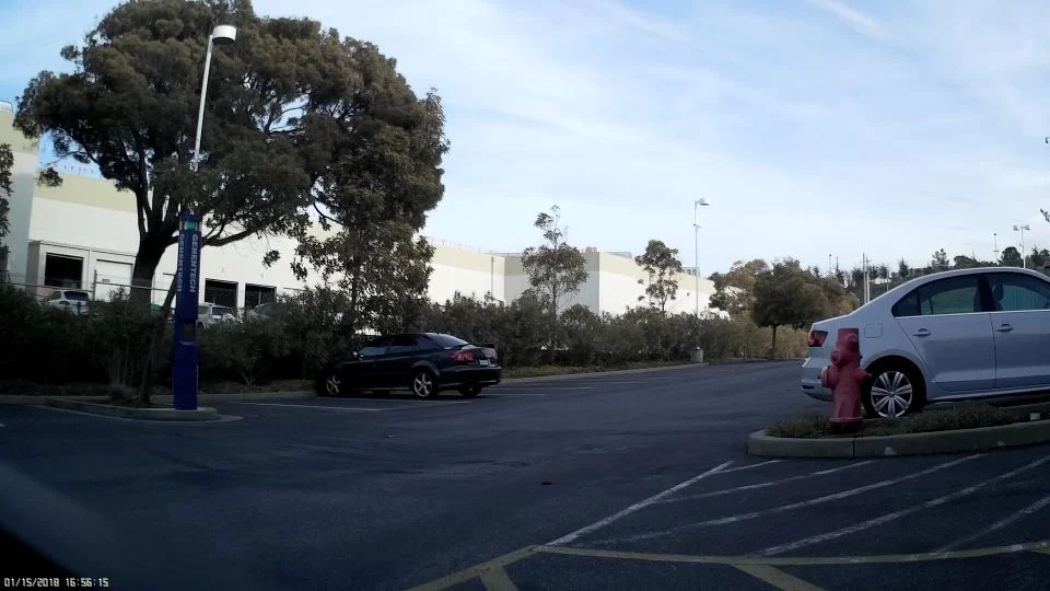

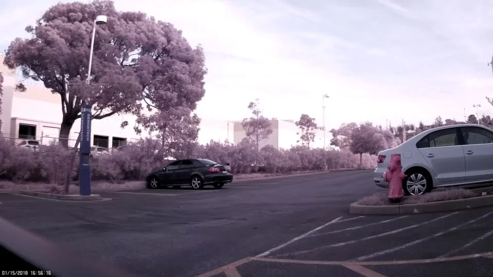

That's an interesting result! You can make an exposure adjustment in the GUI to compensate for the decreased light transmission, although you'll increase motion blur slightly, of course. From the looks of things you might also simply tilt your camera down a few degrees for less sky in the FOV and that should boost your exposure.
