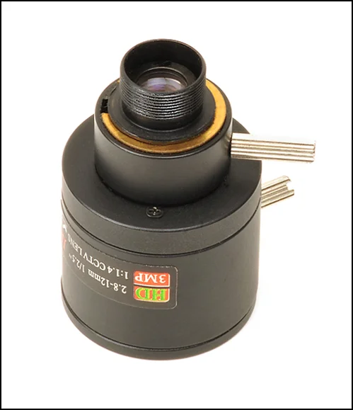

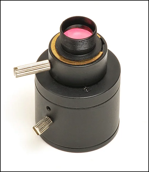

I finally got around to installing the IR-cut filter on my 2.8-12mm Ζ’/1.2 Varifocal. So, now I may have to change the title of this thread from "Mobius Varifocal Zoom IR" to "Mobius Varifocal Zoom IR-Cut!" πŸ˜€
The filter installation went well but it was quite a bit more challenging than I was anticipating, as I will explain. One thing I can say is that the Lazer Bond UV adhesive works beautifully and I can now wholeheartedly recommend it as the go-to low cost optical filter cement. I'm convinced at this point that it's the same expensive stuff you can buy elsewhere, only packaged in a small convenient form for the average consumer. There is just no good reason to mess around with any other kind of "glue" or silicone product for mounting optical filters when you can use this water clear UV cement that allows you to carefully position your work and then secure it instantly with a fully cured inert bond.
The tricky part about installing a rear filter on this particular lens is that there is no room to apply the cement along the edges of the filter. The adhesive must be applied between the glass filter and the metal rear lens retaining ring which fortunately is wide enough that it gives you some room to work with. So, the challenging part here was that even the tiniest pin-point blob of glue I could apply (I practiced first on two pieces of glass) will spread out more than you might expect or want under the IR-cut filter once you "press" it into place on the rear of the lens. There was a real risk that some of the cement could bleed out onto the rear element of the lens or even worse, that the cement could touch the inner wall of the lens tube, thus rendering the lens unfocusable once the cement is cured. The filter itself is 9.5mm in diameter and the lens tube inner diameter is 10.5mm so there was not much wiggle room to work with. At one point I was working the focus mechanism in and out before curing the cement so I could be sure there was no glue on the inner wall of the tube. Finally, once I was satisfied with my glue job I hit it with the UV LED light and a few seconds later the job was all done and I'm very pleased with the results!

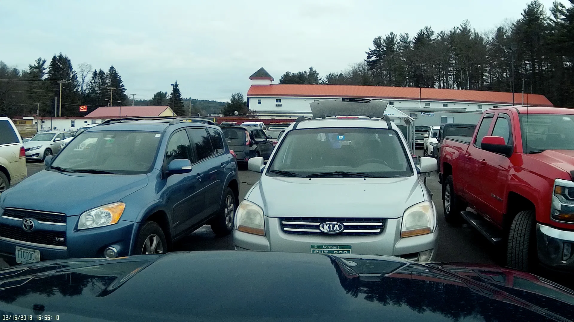

So, I did a quick, rudimentary focus job inside my office today just so I could test out the lens and everything is looking pretty good! I'll likely need to reset the focus point to optimize it for car distances out on the road and then tweek the advanced settings in mSetup to optimize. One thing I did here was to change out the threaded lens mount on the module and adjust it to eliminate the left side lens alignment/out-of-focus issue I discovered previously that can be seen in this image.
Here's a screen shot from today's first test. I'll provide some updates as I continue to experiment.

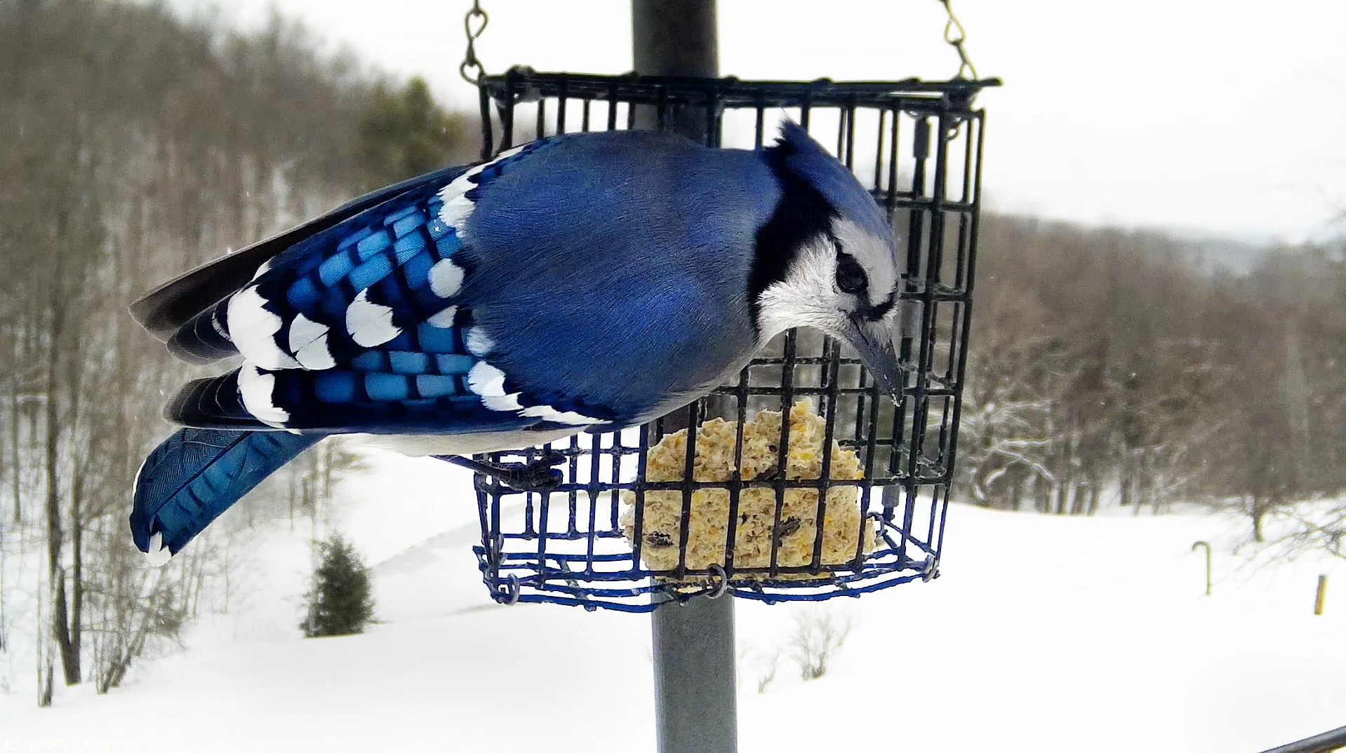

I've been exploring what can be done with this Varifocal lens since I installed the IR-cut filter. Recently, I've been doing some experiments with close-up video and still photography observing various species of woodpeckers and other birds that visit the suet feeder out on my deck. This project is basically in preparation for some upcoming Spring workshops I'll be conducting at a local environmental education center where I work with kids using the Mobius action camera (and others) to observe and record wildlife behaviors while teaching them about photography, video, computers, etc.
This Varifocal 2.8-12mm Ζ’/1.2 has proven itself to be an amazingly versatile lens. I've been finding it to be an excellent telephoto dash cam and often find it superior to some of the fixed telephoto lenses some of us have been experimenting with. I'm finding the ability to quickly change focal lengths or focus the lens without having to dismantle the camera to be a real boon. I'll usually focus the lens using web cam mode on my computer but one can also adjust focus on the spot in the field using a small video monitor. It's no big deal to go from doing close-up work like this with the camera to having it back in my truck as a dash cam within minutes. For wildlife video, it's especially useful to be able to change lens settings or make adjustments on the fly. Probably the biggest challenge to shooting close-up with this type of set-up is that you don't get much depth of field to work with and it's helpful to be able to make changes easily as it's all too easy to end up with out-of-focus imagery.
With the abysmal bandwidth I'm stuck with out here on the fringes it's difficult and very time consuming to upload much video, so mostly I'll just post still frames but here's a short clip of a male Hairy woodpecker (Leuconotopicus villosus).

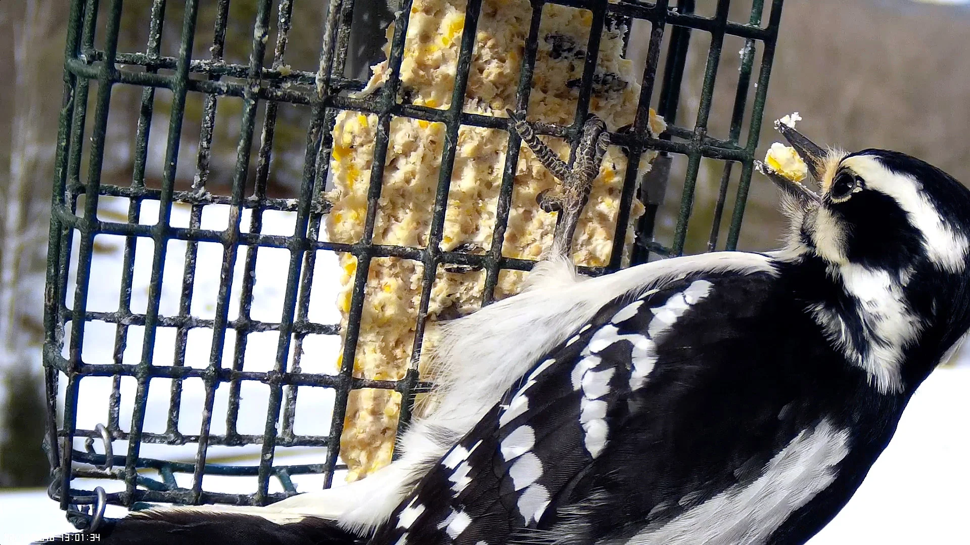

Here is a female Hairy Woodpecker (Leuconotopicus villosus).

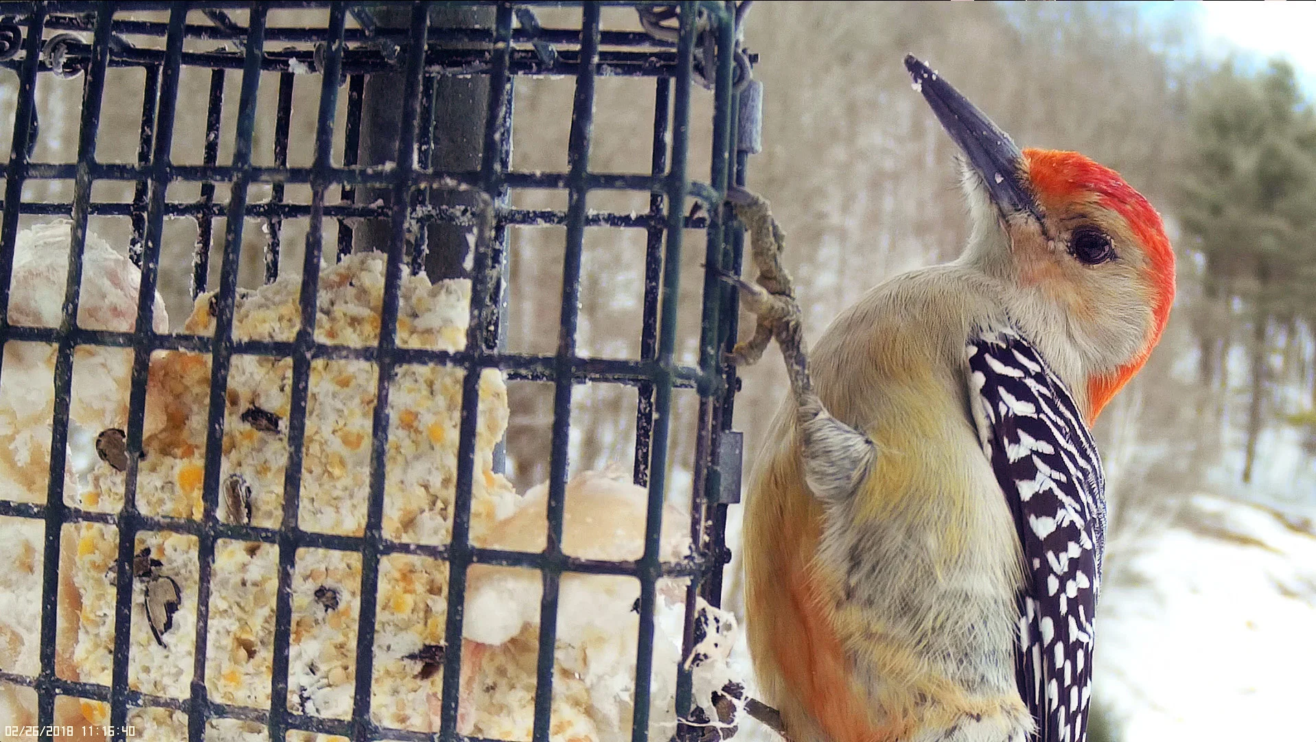

Red-bellied woodpecker - male (Melanerpes carolinus)

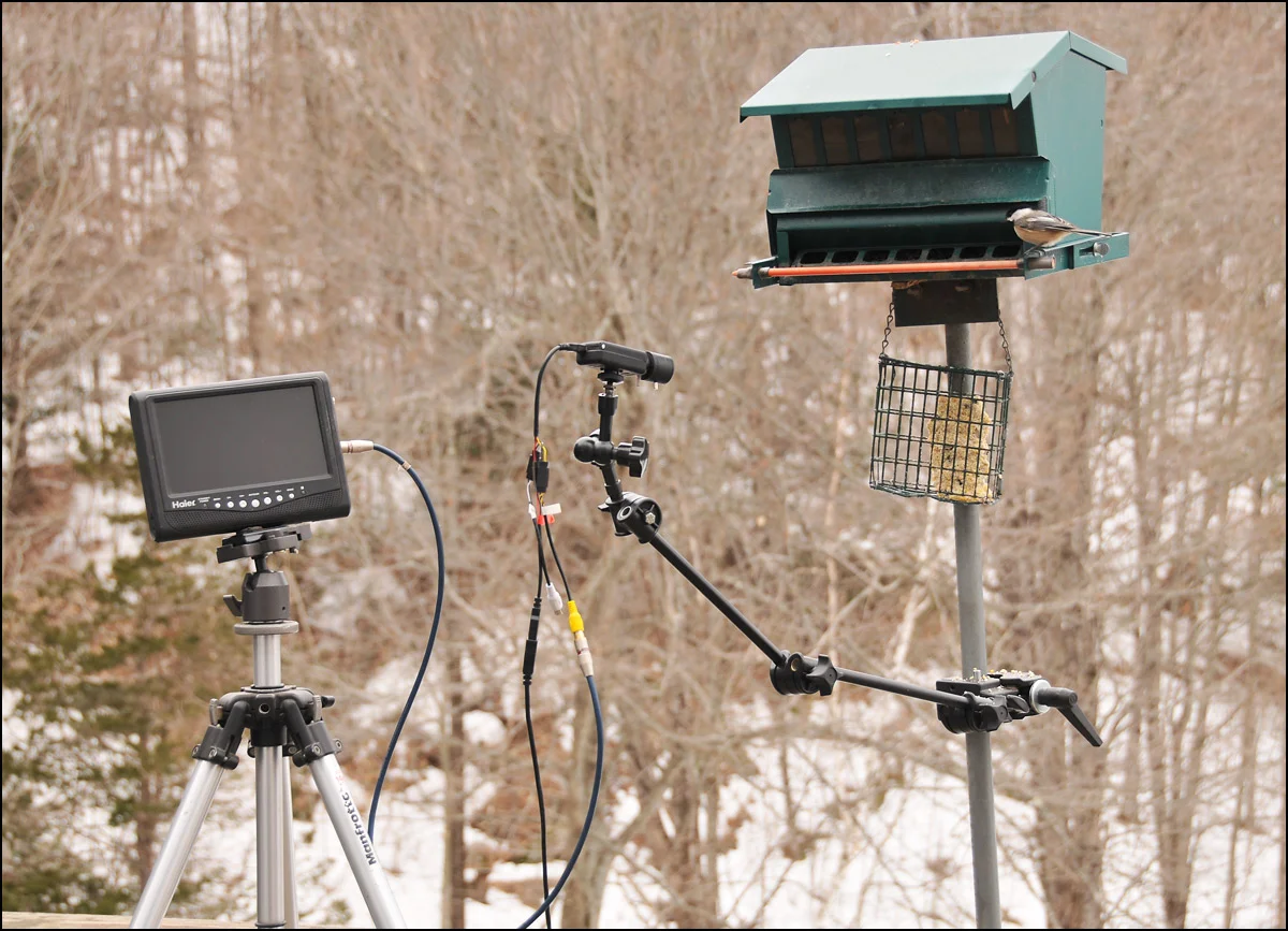

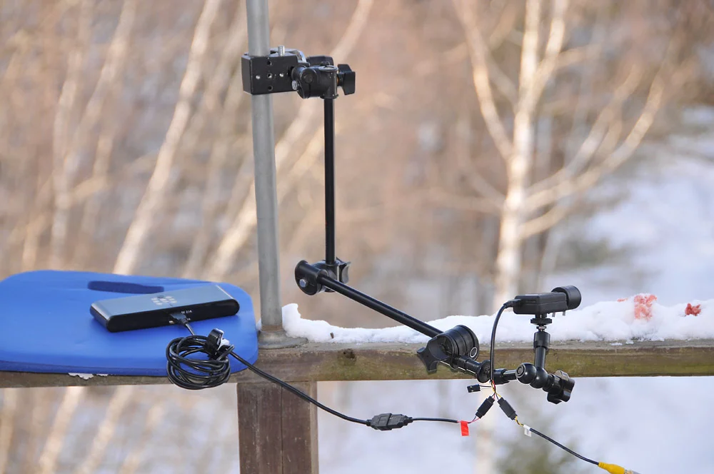

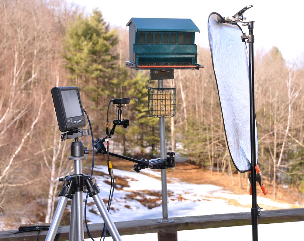

Here's the set-up I used for mounting the camera. Interestingly, when I covered the equipment with camouflage material the birds were afraid of it and wouldn't come near but when I just put the camera, mount, monitor tripod and even a reflector out there bare, they had no problems with it. In fact, one of the biggest problems was having birds land on the camera or the cables as if they were branches of a tree to perch on. One bird even took a poop on the camera! :yuck:πŸ˜†

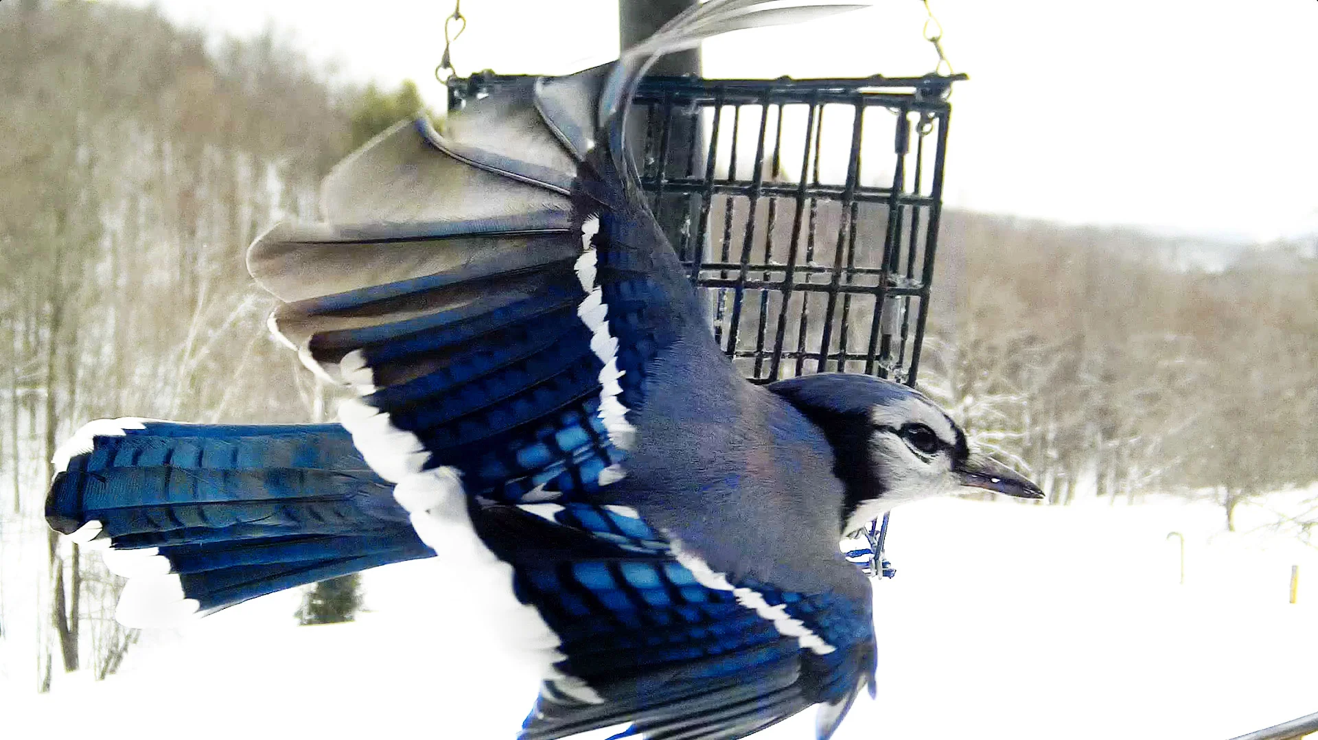

Did you use motion detection, or record continuously? Was the flying blue jay a still photo or a video frame?
