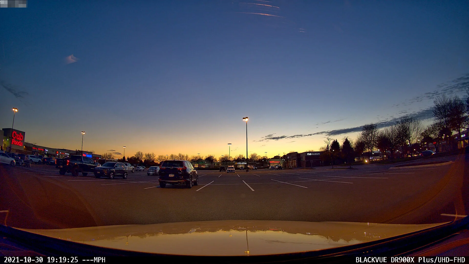

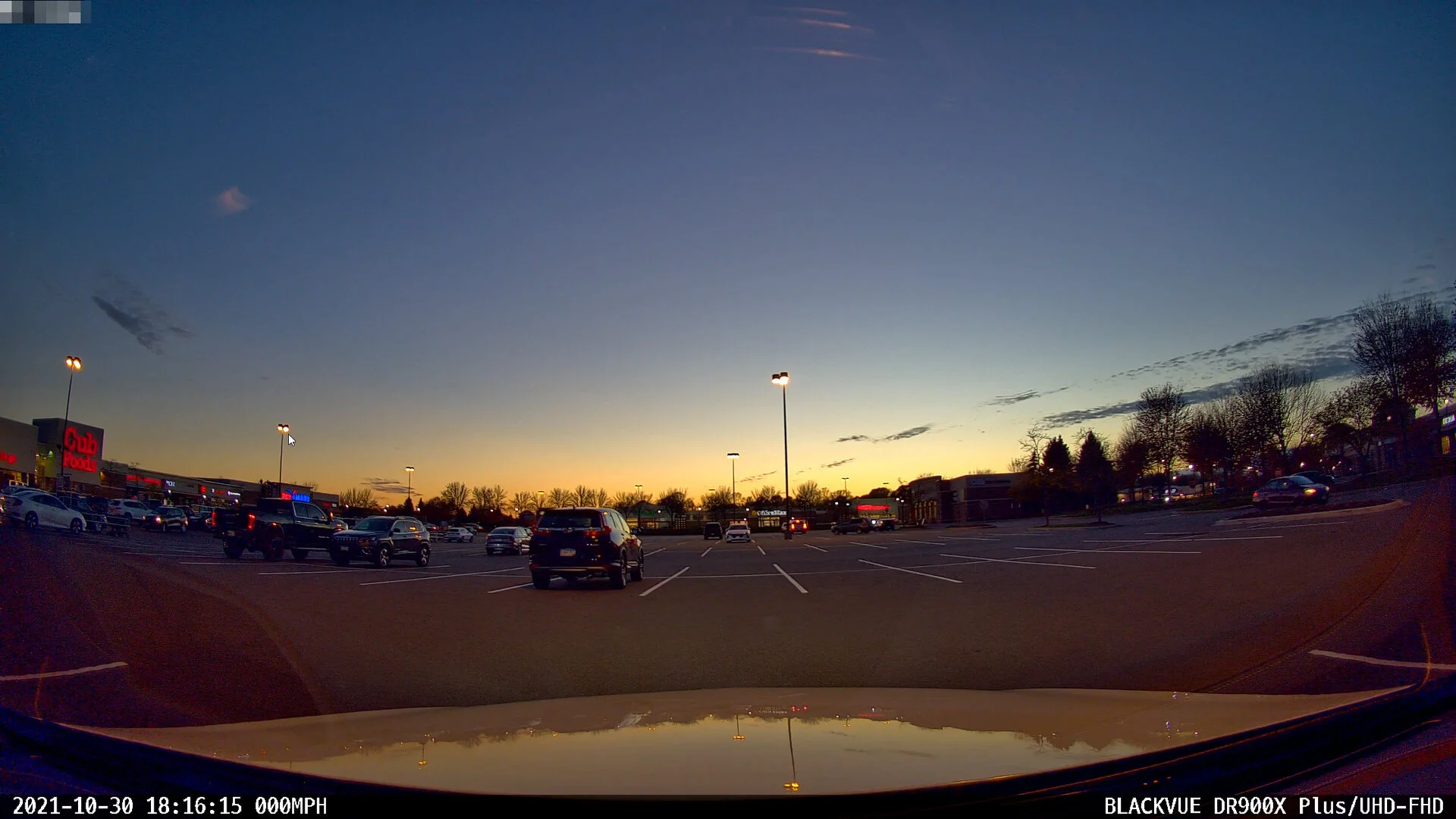

My DR900X Plus 2-channel camera is getting replaced by Pittasoft. In the past couple of weeks, I've found the rear video camera image is now out of focus from the side of the image to about 3/8ths of the video image (going towards the center of the image). The brightness level of the rear video footage is also changing (getting very dark - compared to previous footage and compared to front camera footage with no firmware setting changes). The audio captured by the front camera has some quality problems as well. Pittasoft support stated a certain batch of the DR900X Plus 2-channel cameras might have a rear camera resolution issue.
BlackBoxMyCar replaced my rear camera and also sent a new front camera. Audio distortion with bass was the same for both units. šŸ™
While comparing front video in both, I noticed something quite weird.
My old front camera image has less sharpness compared to the replacement. Both have the latest firmware and both are set to "extreme".
This is my old camera.
This is the new camera.
I have to admit that front camera image is amazing when it's working correctly. šŸ˜›

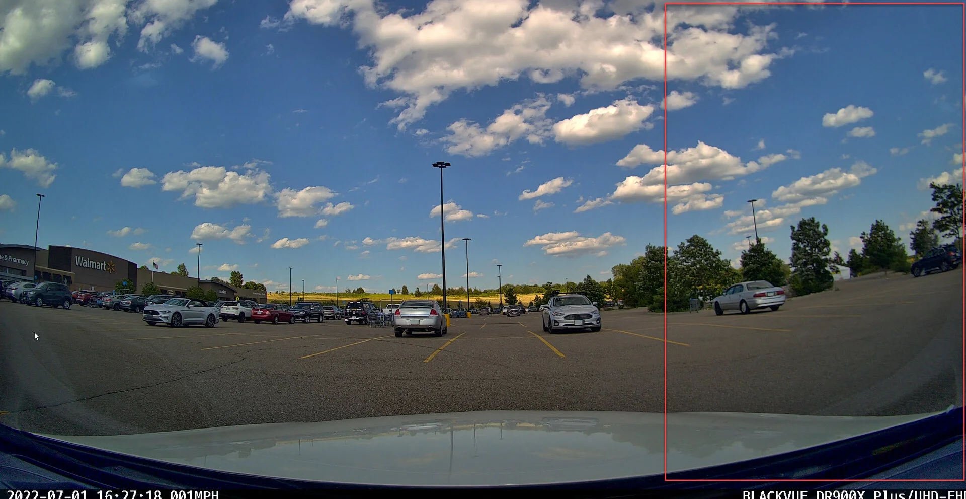

Sadly it looks like the camera video quality or lens degrades over time or maybe its the firmware causing this. Not Sure. My front camera is now blurry on the right side and my rear camera image is blurry all over.
Check out the right side. Firmware v1.0.0.8
Rear camera image is useless if not 5 feet away.
