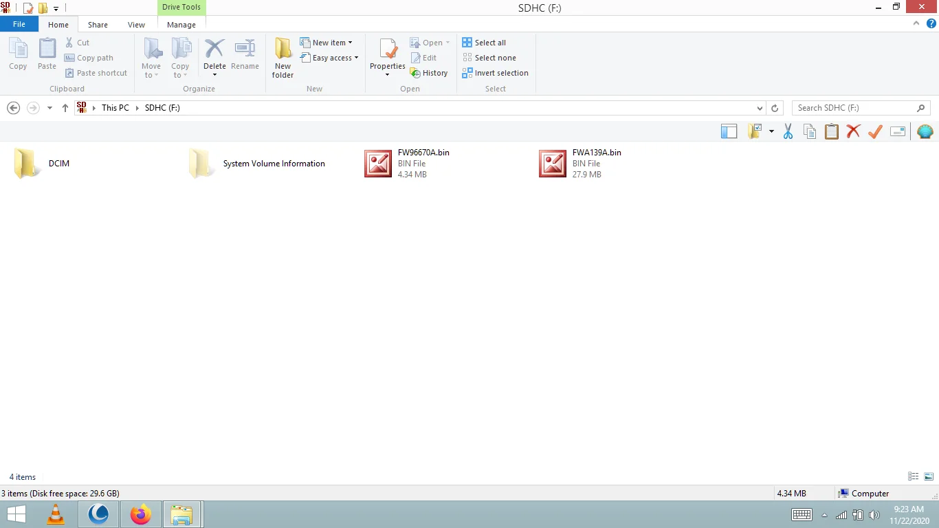

For some reason mine isn't loading the new FW 🙁 Multiple tries, reset cam defaults, checked everything, tested card, verified file is on card, tried 2 tested good cards, used the file link Viofo sent as well as the one he sent to another tester which upgraded theirs to 1113. But still no joy after an hour of trying- any advice welcome 🙂

If you have one, use a newly formatted 32GB or less memory card, just to exclude some possible issues.
Check that the file you put on the card has the correct file name, must end in ".bin", not ".zip", and must not be "???? Copy 1.bin".
If there is still no progress, contact Viofo and ask if a new loader is needed. I don't think this can be your problem, but this issue has caused problems in the past.

I've reported it. Good 32GB card, fresh form a full overwrite with SD formatter and tried a known good 64GB card too. file is .bin with no suffix and seems to load intact and complete. Tried all possibilities here so just waiting on a reply. Probably do need a bootloader file but can't understand why as the previous FW update loaded properly.

Thanks Valeri, but I'm still stuck. Here's what is on the card:
It blinks as if it's loading the FW, starts recording properly, and does everything expected. Restarting the cam doesn't help even after resetting to defaults or not.
There shouldn't be a DCIM folder. The 2 red files should be the only ones on the card.

Your card is not in that format, take 4-16 GB and format F32.
The System Volume Information file should not be present. so only in NTFS, exFAT
I'm using a freshly formatted Samsung EVO Select 32GB card tested good last night with SD formatter and with h2testw the day before. Card should FAT32 as I have it. It is the same card done the same way as when I updated the FW here before with the GPS fix. Which is why I can't understand it not working now.
The DCIM folder which was here earlier was because I took the screenshot after trying the cam. I just went through it again and there was only the system volume and the two red files. Should the system volume info file be deleted before I move the FW and loader files to the card:?
ADDING: Just used sdformatter again; card is FAT32 and the system volume info file is still on the otherwise empty card.
I think so. I only ever have the actual FW on the card in the root directory
