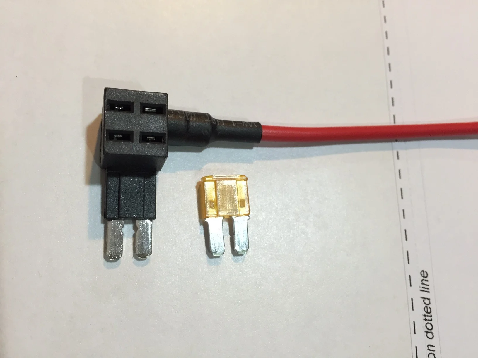

But did you the diagram that I drew? I do not believe that this particular blade incompatibility has anything to do with Mustangs or any other Fords. That blade is not compliant with Micro2 fuse format. I don't think that it wouldn't fit into any proper Micro2 socket. There are tons of these connectors being mass-produced by different manufacturers. One of them screwed up. The Street Guardian included a second set of larger blades, which have exactly the same profile. It would be interesting to see if those fit into a socket of the relevant format. And if they do, to see if they mach the fuse shape.
I didn't choose my words properly when I said that the company should not be selling the hardwire kit. I meant to say that they should not be selling blade connector from a new supplied without testing it.
unfortunately it's impossible to test on every type of vehicle, the majority of vehicles are no issue for any of the taps, we've been using them for the last few years, in around 20,000 taps shipped I could count on one hand the number of times a problem with the fit has come up, it's known that taps can't work for every situation, most often due to panel layout, the fuse cover etc, that said I have passed the photos onto the supplier to see if they can revise the design to accommodate these Ford fuse panels, they would never fix what they don't know about so the detailed photos of the F150 fuse panel were useful for that

I found the kit

By the way (I am not trying to rub it in) I think I found a complaint Micro2 blade connector. Hover your mouse over the image to get it magnified - there are no tabs! :)
https://www.ebay.co.uk/itm/201207614031

I think I found acomplaint Micro2 blade connector. Hover your mouth over the image to get it magnified - there are no tabs! :)
if you do find one that fits your fuse panel ok please let me know so I can give the feedback to the supplier
But I already shaved the tabs of mine and fitted them. I new about this incompatibility from a Mustang forum thread before I bought the SG9663DC from you and that's where I found the link to this connector. Here is the thread where they are discussing generic vs true Micro2 blade connectors:
