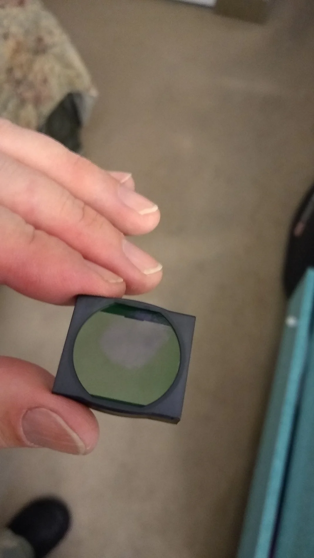

My bad, I see that you refunded the hardwire kit. I misunderstood the email. I will send the polarizer back with the first camera kit. I just review the videos - I don't see any spots on the frontal feed. I got a lot of short videos with a lot of lapses in between them. That's understood, when the camera was in the zombie mode. The strange thing is that when I finally made a reliable connection and went out for a ride about an hour ago, the camera filmed as I was entering my garage and parked the car, but for some reason skipped the previous 3 minutes that I was driving. It's almost as if it got triggered by me slowing down into the underground garage. I tried downloading older videos, before I left for a drive and like I said it lost wifi connection. But I switched it back to recording before I left. Maybe it get hung somehow, but it never recorded me exiting the garage and driving around and started recording just as I was entering the underground building garage. Is there any special software viewer for the videos?

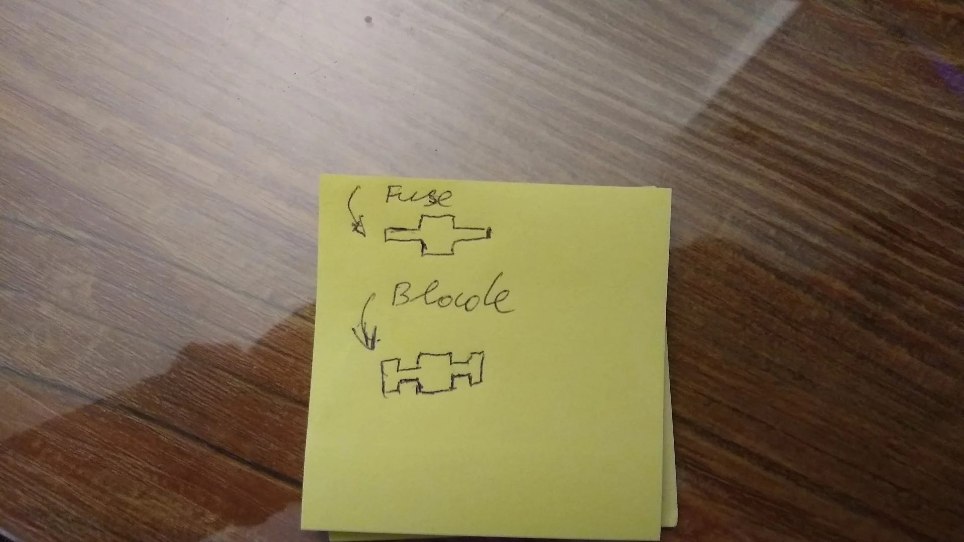

I think Ford simply applied tighter adherence to format, and that caused the problem.
I doubt it’s a question of stricter conformance. As a manufacturer, Ford doesn’t consider aftermarket or modification needs. Even in my Super Duty truck (2011), specifically a platform for upfitters and commercial applications, they still used a passenger footwell fuse panel that doesn’t accept add-a-circuit style taps. They give you upfitter switches and grommets to reach into the engine/battery compartment under the hood and expect you to make due with that.
I found a way on my truck to tap into the delayed-off accessory circuit for my old two-wire install so that the cam stayed powered for up to 10 minutes after turning off the truck until you open the door, but again I had to find and tap the right wire out of a tight bundle. It’s not something Ford made readily accessible. They can put extra plastic tabs and all kinds of stuff in the way because they think it’s better that way, and it’s up to us to make it work with our own application.
Deacon, my Mustang was produced in 2017. Now this just happens the be best-selling sports car all over the world. All Mustangs produced from 2015 had Micro2 fuses in the cabin fuse compartment. Not even taking into consideration that probably Ford also used Micro2 fuses in other models, surely, there would other reports during this time-frame if the blade adapter that Street Guardian has been shipping with the kit always had these tabs. And then the ultimate test of a female fuse socket conformity to the standard is the shape of the male fuse. And not for the sexiest reason but because: 1) Only recently, there have been reports of some Micro2 blade adapters with tabs causing incompatibility. 2) There are no Micro2 fuses with tabs. Look at a magnified pictures of any Micro2 fuse on Amazon. As for the blade, unfortunately, because they are black, when they are present on non-compliant blade models, the tabs are not easily visible either on Amazon pictures or, in my case, when working in a darkly lit underground garage, wearing a chemical respirator because of Covid-19, with eye-glasses, which have magnifying inserts on the bottom because I am both near-sighted and far-sighted, sitting well above their proper position because of the respirator.

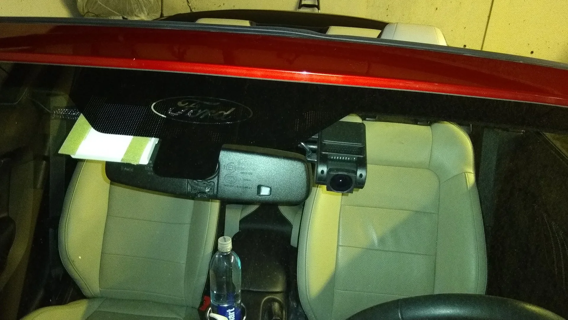

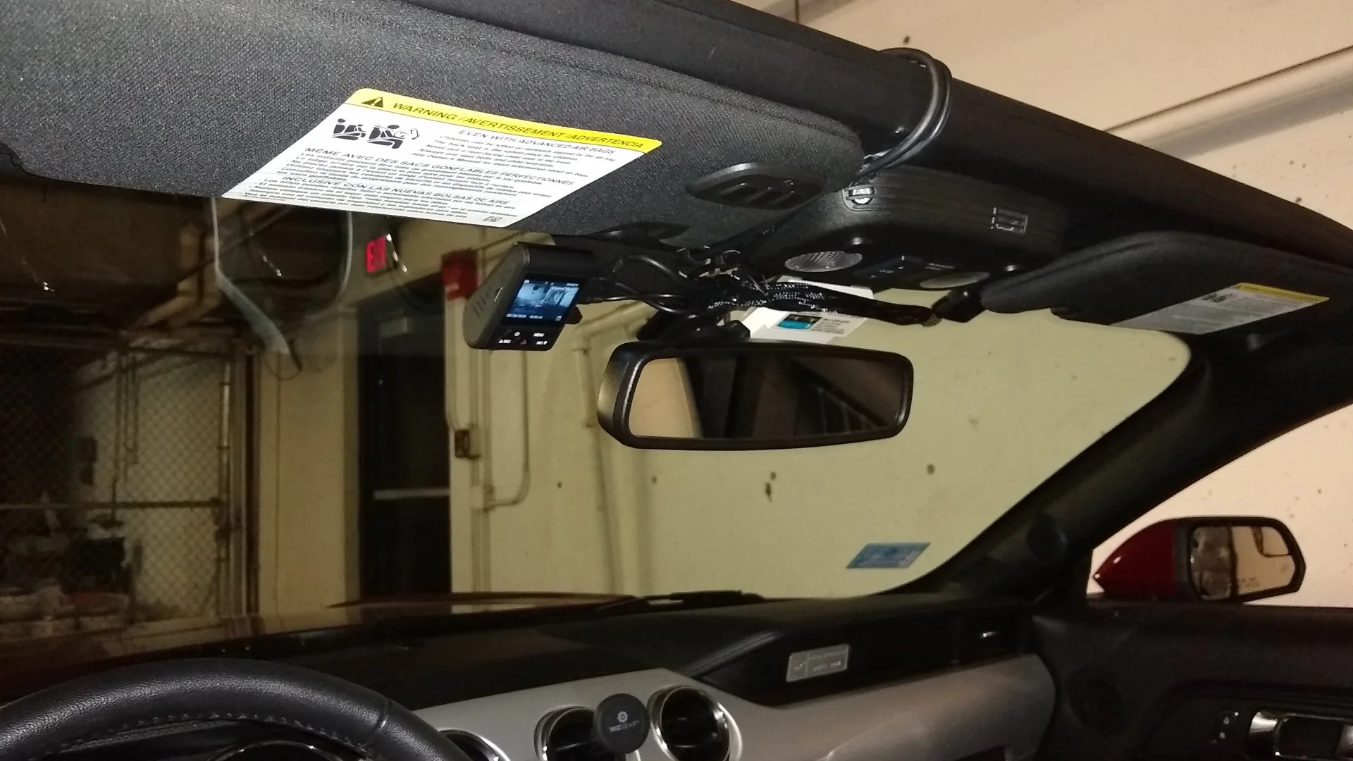

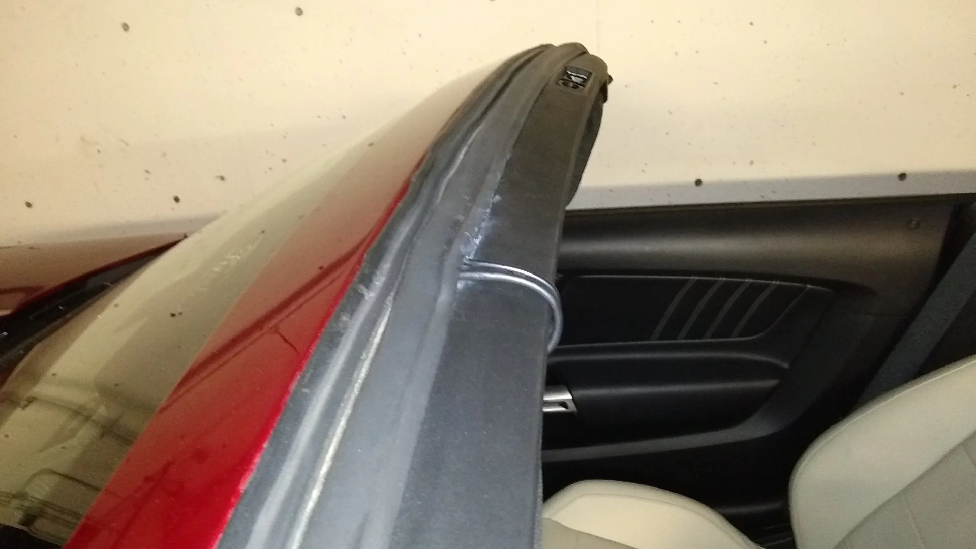

So here is how I routed the cables. Rear cam cable is really thick and pushing both the power and rear cam cables under the windshield glass seemed like a bad idea. So I chose to route cables under the rubber fold that serves as a cushion when the convertible top touches the windshield frame. Off course it wasn't designed for so much to be stuffed under it, and as a result, I had to glue the rubber cushion to painted steel after I routed the cables. It was a bad idea to use crazy glue - cyanoacrylate, because, as you can see on the pictures, it reacted with both rubber and car's clear coat and turned white. I later washed the white away with acetone.

I didn’t notice your photos until now. Why did you need to run the wires like that? What about the normal route along the headliner and down the a-pillar? The way you have now will pinch the cables over time.
I managed to disassemble the trim from the back of the car up to an a-pillar, but couldn't snake the thick rear cam cable across the a-pillar towards the window shield. So far there are no signs of pressure on the cables, but I will check next time I use the car.

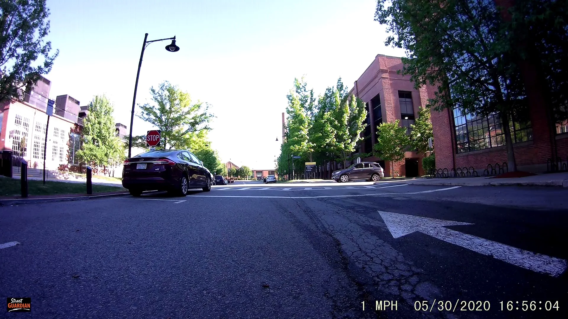

While pavement looks amazingly sharp on the rear cam videos taken on a sunny day, it is impossible to read the licence plates of cars behind mine, even if when they got really close to mine. The licence plates are completely washed-out. Any recommendations? Thanks.
Uploading one right now. 🙂
This video that I am uploading shows the problem when sun is shining on the car behind me. Meaning the sun is in front of me. In other videos, on a street lined with trees casting shadows across it, when the sun was behind my car, I could read the licence plate of a vehicle following me.
I wonder a polarizer filter could help this? I am not asking for one as I realize that unless you build it into the external cam and use some kind of a hardened glass, it would get damaged rather quickly. But then you would lose F stops on the camera which is already somewhat lacking at night...
OK. The upload has finished. Tell me what you think. I love the quality otherwise.
It might be the angle. Jokiin, since the rear cam sits higher on your truck, you might not have this issue.
it's not the camera angle so much as it is the lighting conditions, late afternoon sun is low in the sky and hitting a reflective license plate, you'd see the same result from the front camera at times under the same lighting situation even though it's mounted higher and has a filter, the filter is for dealing with reflections from the window, it wouldn't help with this particular situation, the mounting height of the camera would come into play at different angles, and different times of the day, there will always be a time when the situation is just right (or wrong as the case may be) for reflection to be an issue
