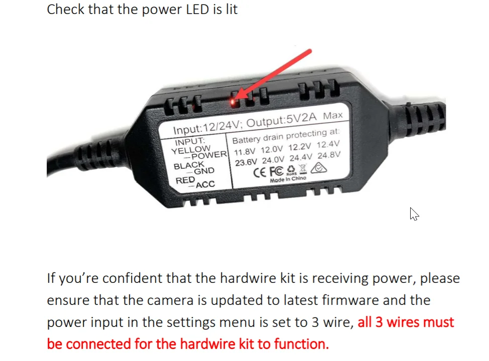

I got Ford Mustang GT 2017 Convertible, US version. The unit behaves very strangely. So I said yesterday I got it eventually turned on and left in that mode in the garage. In about an hour I came back and the camera was recording, the adapter pilot light was on. I turned the engine on, and now went through the whole telephone connection procedure, as it was described. It worked though-out, but the second that it accepted the default password, the unit shut off. I looked at the power adapter and the pilot light was off! Can the unit control the power adapter? That was bewildering. I pulled the connectors of fuses harness plugged them back it and got the pilot light to glow. But I couldn't turn on the unit! When I would press power, the record button would turn on for about three seconds and then turn off and nothing would happen. I recorded this with my phone and can post it if I can post videos on this site. I went for a drive and during next hour everything was the same. I stopped several times, the adapter light would be on, the unit would continue to exhibit the same behavior. My car battery voltage showed as 13.8. I ended up pulling of the connectors. I am not sure if the solder that I used is circuit quality. I had a piece of previously molted solder in the bag with my soldering irons that I used to thicken these connectors. I have spindles of electronics quality solder in that bag, but I've lent that bag a couple of times to friends and one of them could have left that used before solder and perhaps it was not electronics quality. Anyway, have you seen this mode of behavior in the unit.
Also. The adapter switch has 4 position but has 8 voltages listed. How come?
The red LED should be glowing at all times in the SGDCHW/SGDCX2HW power supply box. See image below. If it means you're most likely not using a good BAT circuit. (or you picked a computer-controlled circuit where the computer is reducing the voltage or randomly powering off completely from load detection stuff) Wonky fluctuating or low power sill mess with the WiFi stability as well.

the 4 of the voltages are for 24 volt vehicles, the kit support 12 V and 24 V vehicles. ( as you can also see on the pic above on the sticker )

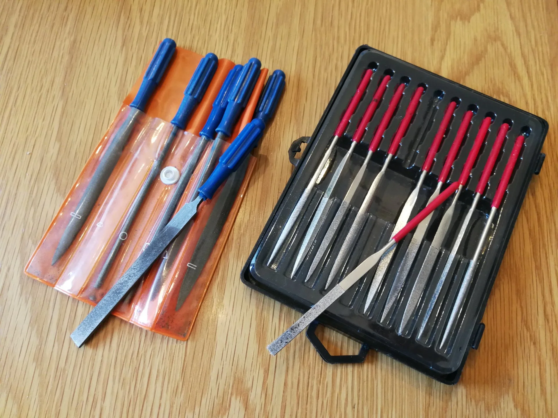

I removed uncertain quality solder that I initially applied to the fuse wires to make them thicker and reapplied electronics-quality Radio Shack solder. I spent another two hours trying to file the taps to make them fit the fuse box to no use. This has been extremely frustrating. On Friday I bought two packs of fuses one of which was marked Micro2 and the other ATR, which two names for the same format. Both perfectly fit any Micro2 slot in Mustang fuse box. What you provided simply is not conformant. Are you going to try to send me the appropriate parts or am I on my own?
I'm not sure there is a complaint part available at the moment, same problem here on another Ford
You should not be selling hardwire kit. If standard fuses fit into Ford fuse box, it means that you picked a blade vendor who manufactures non-complaint products. According to Mustang forums some blades conform to format, while others do not. I am not going to send your device back because I've already had to modify my vehicle to accommodate it, but I would think that it should be you who orders these blades from 10 different Amazon vendors until you find a compliant one, rather than me.
Not sure if you had a chance to fully read the other thread yet, it's been recently acknowledged as a new unexpected new Ford problem and is being looked into at the factory soon. It hasn't been a problem before now, other old and new non-Ford vehicles have been fine so far.
had similar feedback from a Mustang owner recently, seems Ford may have changed the fuse panel plastic surround at some time, the taps are the same ones we've always used and it hasn't come up as an issue in earlier model model Ford vehicles, or in other vehicle brands that use Micro2 fuses, I'll pass this info to the supplier of the taps anyway and see if it's something they can adjust for future productions to accommodate whatever has changed, appreciate the high quality pictures, that will help
The "excessive plastic part" on the fuse taps can be filed down. It is fairly simple few minutes job.
Well, that's a great idea. Didn't even think of that. Sometimes it's the simplest things you don't even think of, so thanks for the advice. So I went ahead and put both add-a-fuses on a vice and shaved down the plastic with a kitchen knife. Well guess what? Now they both fit in and the hardwiring is all done. Now I just need to drive around, test it out, and try out the parking mode. Very glad to get this done.
And evidently, this is s Ford problem after all. I'm seeing some other forum postings and Amazon reviews where people are having the same issue with their F150s. Well, at least now we'll have this thread on here as a future reference with photos that can be found in a search (I've added Ford F150 to the title).
something has changed on recent Ford's with the design of their fuse panel, older models were never an issue, fuse taps are a convenient option but they don't work for every vehicle unfortunately
@cameo, I'm refunding the cost of the SGDCHW hardwire kit from your order, you can keep it (no need to send it back)
You don't need to. I did not ask for it. If you did, please charge it back. Thanks for the tip about the tabs. When I compared a fuse and the connector under a magnifier I, indeed saw, that it had those extra tabs which the fuse doesn't have. Being far-sighted, I couldn't see it before. It took me quite a bit of work to remove them with an exacto knife, partly because I also had to file off a lot of extra solder that I applied to the blades. Once I realized that one blade had to fit into the lower socket of another, it was only a matter of time. I will make picture tomorrow for the benefit of others. In a retrospect, I think Ford simply applied tighter adherence to format, and that caused the problem. I just went for a drive in the dark and made a recording.
