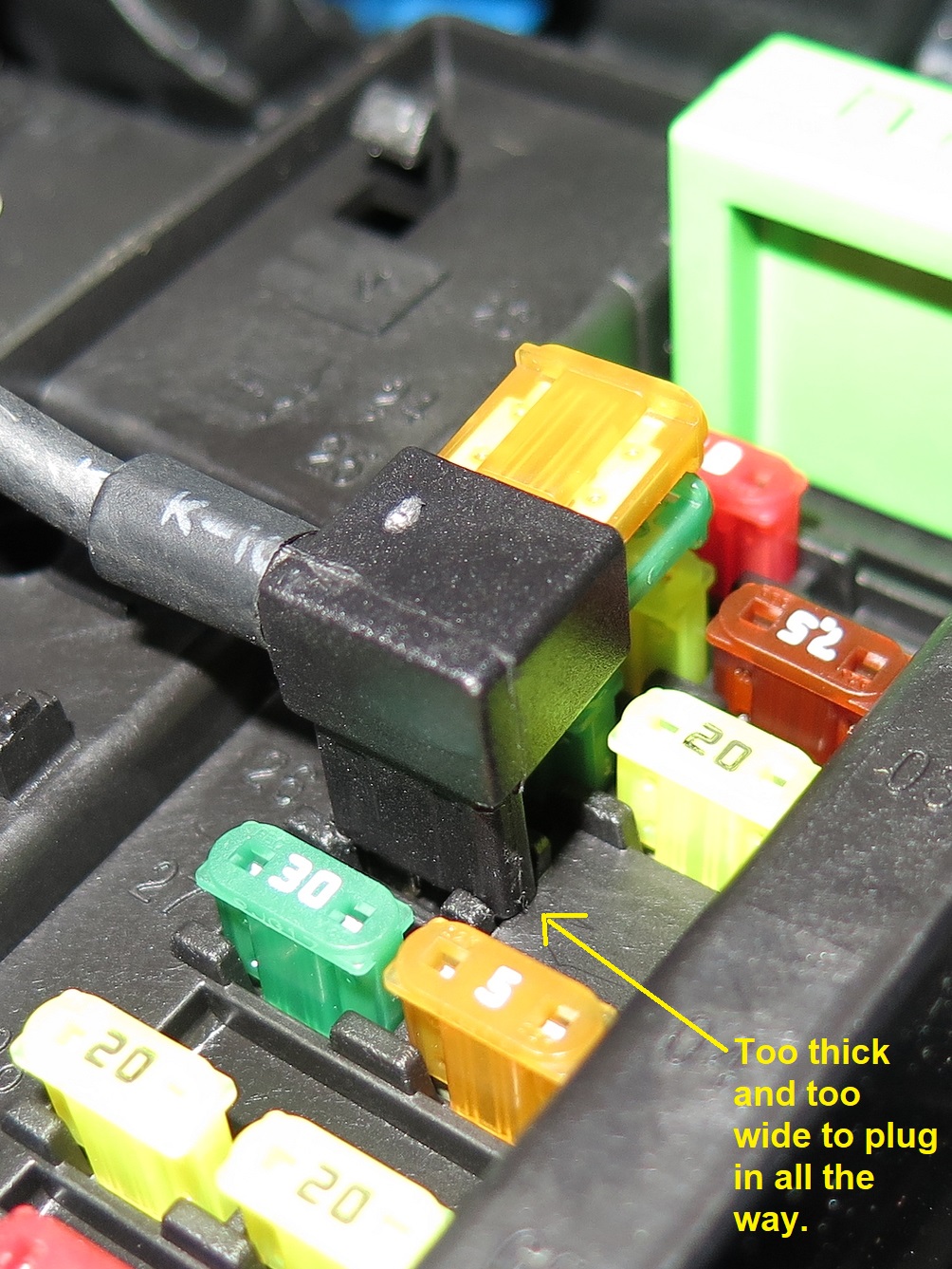

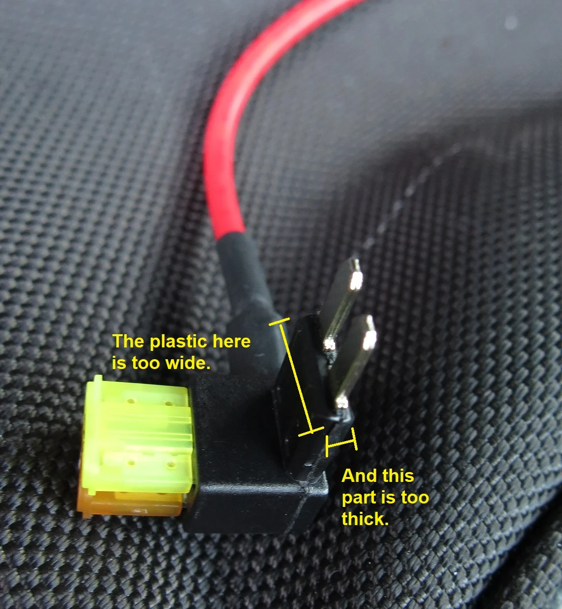

Well, I have a SG9663DCPRO installed and working good on a 2020 F150 using a cigarette plug. Today I just received the SGDCHW hardwire kit that includes all the different fuse sizes but ran into a problem. The Micro 2 plastic housing is just a little too big and wouldn’t go in to the fuse slot in the fuse box.
Here's a photo where I tried to push one of the add-a-fuses in, but it wouldn’t go.
Here’s a closer-up shot where you can see how the plastic part is just a little too wide and won’t go down enough, so I couldn’t get it to plug in.
So unfortunately, I wasn’t able to do the install and will use the cigarette plug for now. I think I’m going to shop around for another Micro 2 sized add-a-fuse and see if I can find one that fits. I thought I’d pass this along as an FYI in case anyone else runs into a similar issue. Maybe future versions could make the plastic casing skinnier so it’ll push in all the way.
Something else I should mention, it is awfully hard to push the 2 fuses into these add-a-fuses. I had to squeeze ‘em with pliers to get ‘em in all the way. Perhaps they could be made with a little more tolerance so they’re not so overly tight.
had similar feedback from a Mustang owner recently, seems Ford may have changed the fuse panel plastic surround at some time, the taps are the same ones we've always used and it hasn't come up as an issue in earlier model model Ford vehicles, or in other vehicle brands that use Micro2 fuses, I'll pass this info to the supplier of the taps anyway and see if it's something they can adjust for future productions to accommodate whatever has changed, appreciate the high quality pictures, that will help
Daum. it still look as if the fuses them self have some wiggle room :unsure:
You will probably have to remove some material from the fuse adapter

Well, that's a great idea. Didn't even think of that. Sometimes it's the simplest things you don't even think of, so thanks for the advice. So I went ahead and put both add-a-fuses on a vice and shaved down the plastic with a kitchen knife. Well guess what? Now they both fit in and the hardwiring is all done. Now I just need to drive around, test it out, and try out the parking mode. Very glad to get this done.
And evidently, this is s Ford problem after all. I'm seeing some other forum postings and Amazon reviews where people are having the same issue with their F150s. Well, at least now we'll have this thread on here as a future reference with photos that can be found in a search (I've added Ford F150 to the title).

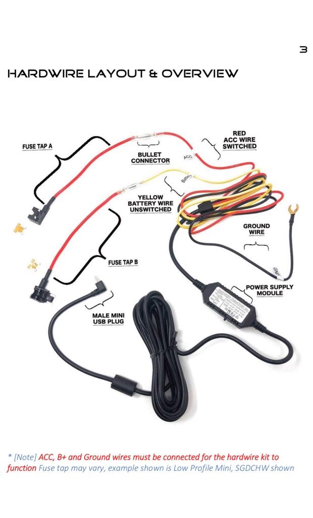

Just a suggestion either take a picture of the fuse box layout in your manual or post the manual page here with a schematic of the fuse box. Red wire is ACC, meaning it needs to go to an ignition powered system (activates when car is started) - Examples may be 12V Socket, heated Seats, etc. NEVER and I REPEAT NEVER tie into critical systems (Airbag, safety systems, etc). Battery = What powers camera once car is off. Yellow Wire. I tied into my power seats. These are active even when car is shut off.
Black is grounding....
If you post your manual we can maybe take a better look and give suggestions on proper fuses to use.

Yellow is B+, red is ACC
Well your wiring is different than Viofo's where yellow is acc and red is battery...??? That's what I have written down in the guide / notes I made when I installed. My Camera works perfectly with parking mode. Ill take another gander at my setup but I'm pretty damn certain Viofo has yellow as ACC.
Industry colors are what Street Guardian uses for wiring. Many generic China companies have been doing it backwards for many years now. It’s very split out there now. Just be sure to follow our hardwire user manual instructions. Best not to make any assumptions from other products.
Well count me embarassed. I didn't know the wiring wasn't standard among products. I kind of assumed, and wrongfully, that companies would be using the same configuration. Viofo clearly has yellow as ACC and Red battery. Found it on their documentation and BlackBoxMyCar
