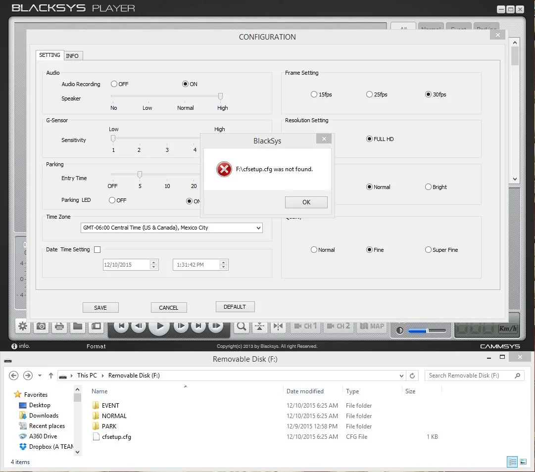

First Issue: cfsetup.cfg was not found.
The software does not recognize the cfsetup.cfg file. This is preventing me from saving any of the configurations of the CF-100.

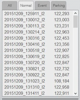

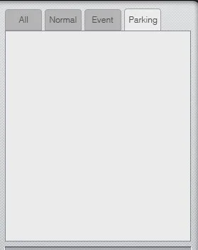

C) When reviewing the video, the PARK folder is empty. Videos where I hear the device state "Parking mode is ending." are located in the NORMAL folder.

you simply being in the car might be enough motion (g-sensor) to make it think it's still driving. or if there's enough motion outside the car for the camera to see, it won't go to parking mode. that said, I've had mine go into parking mode after the default 5 minutes while sitting in line at a drive-thru. normally moving the car a few feet or opening/closing a door is enough to get out of parking mode.
no, parking mode does not record constantly. only when it sees motion through one of the cameras or presumably feels something via g-sensor. there was some discussion on here recently about whether or not the rear cam would trigger it to start recording, or if it was only the front cam. looking at my parking videos, i can't reallly tell - there always seems to be motion on both ends of the car.
not sure what to say about the cfg file. maybe format the card in your camera or in the app and see if it creates the file for you.

Regarding your "First Issue: cfsetup.cfg was not found.", I experience the same problem when my SD card adapter has the hardware write lock in the lock position. Make sure the card is capable of being written and see if the issue goes away.
